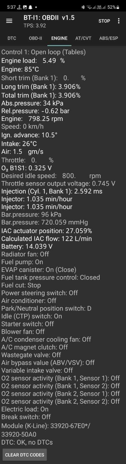

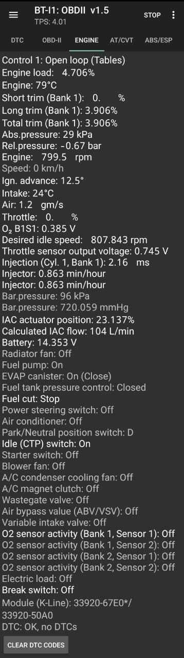

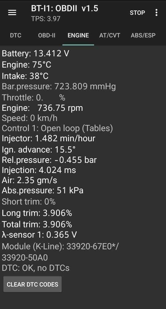

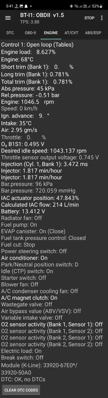

RPM drops almost to zero while pressing the clutch after driving for 5-10KMs in my Cultus (EFI), especially when the headlights, AC, or both are turned on.
The RPM drops when I stop at a signal or traffic jam, making it uncomfortable. I have to keep pressing the accelerator to keep the RPM above (RPM doesn't drop when I press the accelerator).
The issue doesn't occur during a cold start, and my car don't overheat when the RPM drop issue appears.

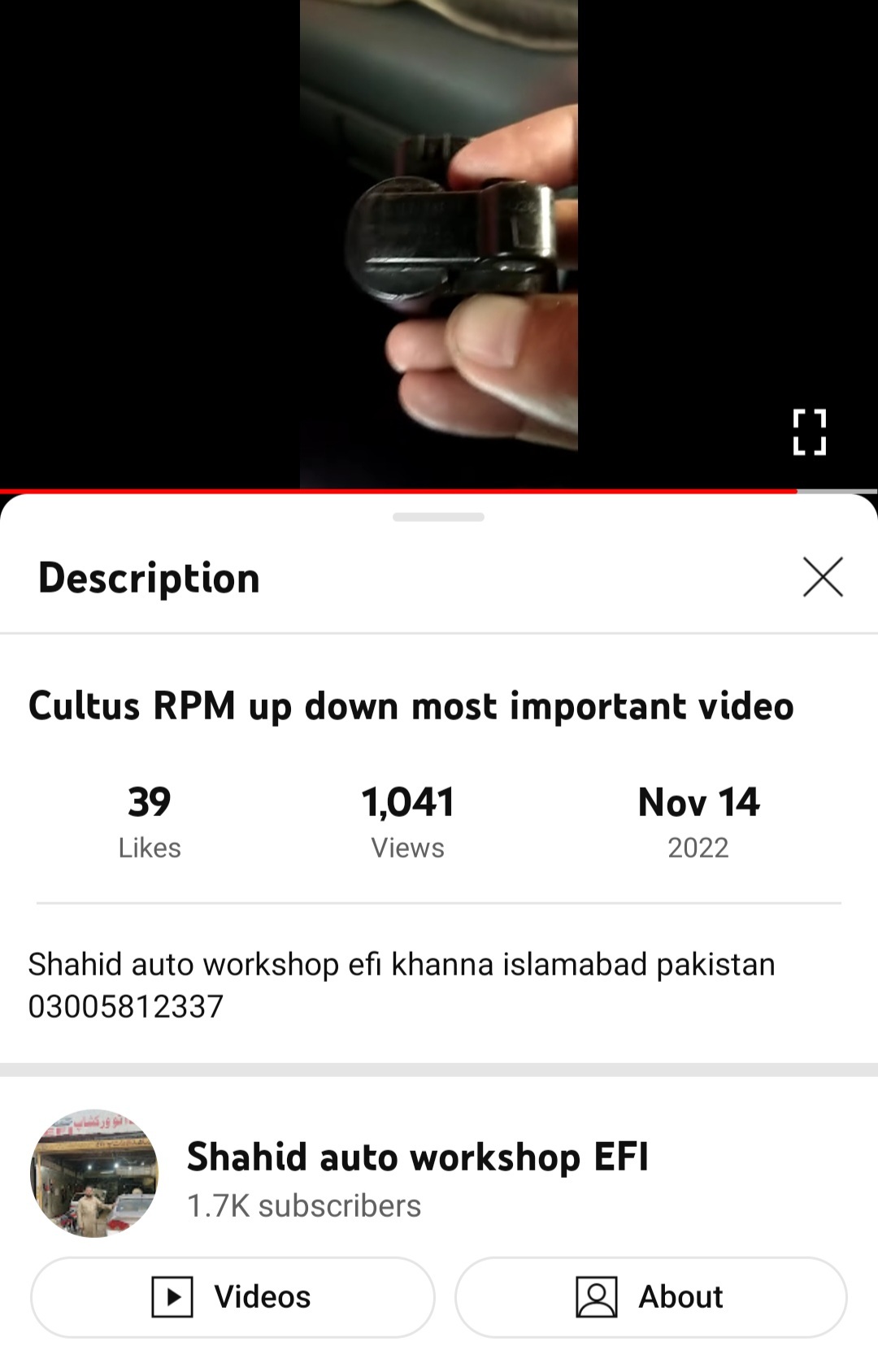

I took my car to the mechanics, and they fixed something around the throttle body, which temporarily resolved the problem. However, the issue reappeared after driving for 5-10KMs.
It's possible that the problem is related to an electrical issue or something else. Can anyone suggest what might be causing this problem?
