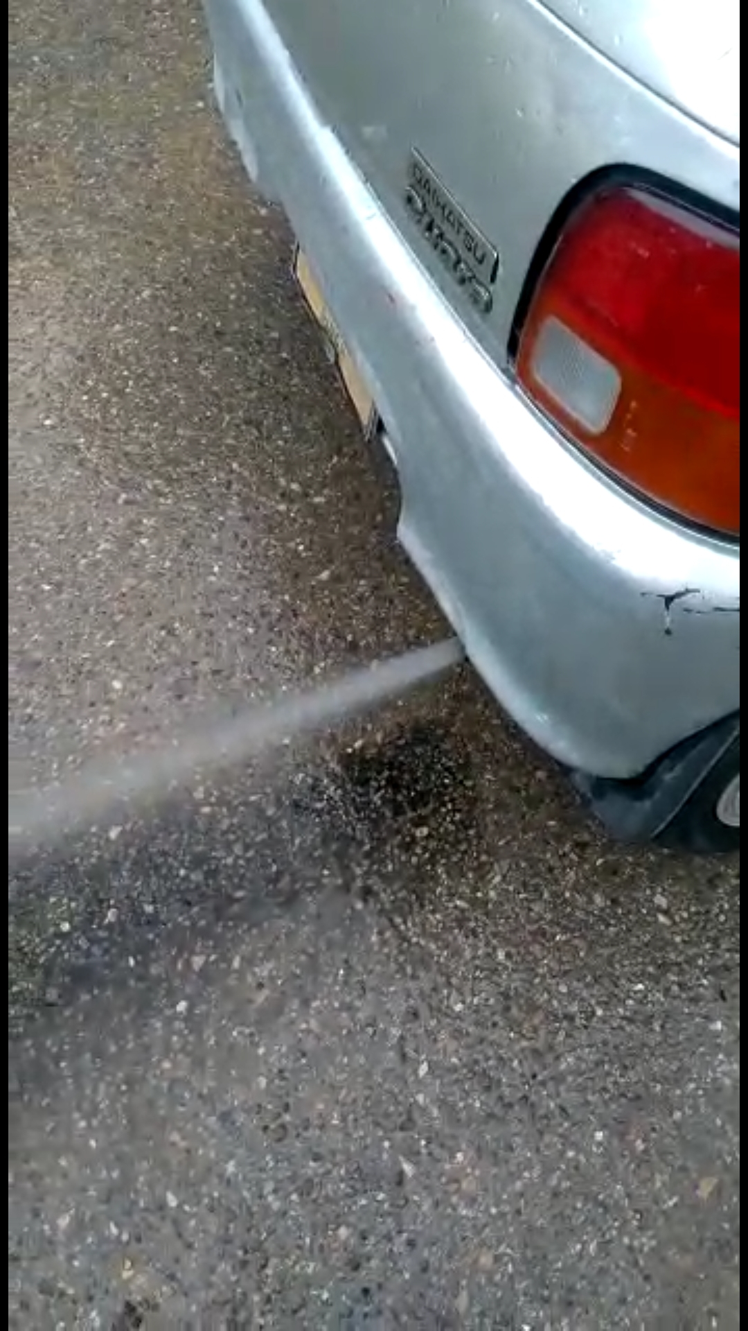

you can clean the drain line by blowing some air into it.
