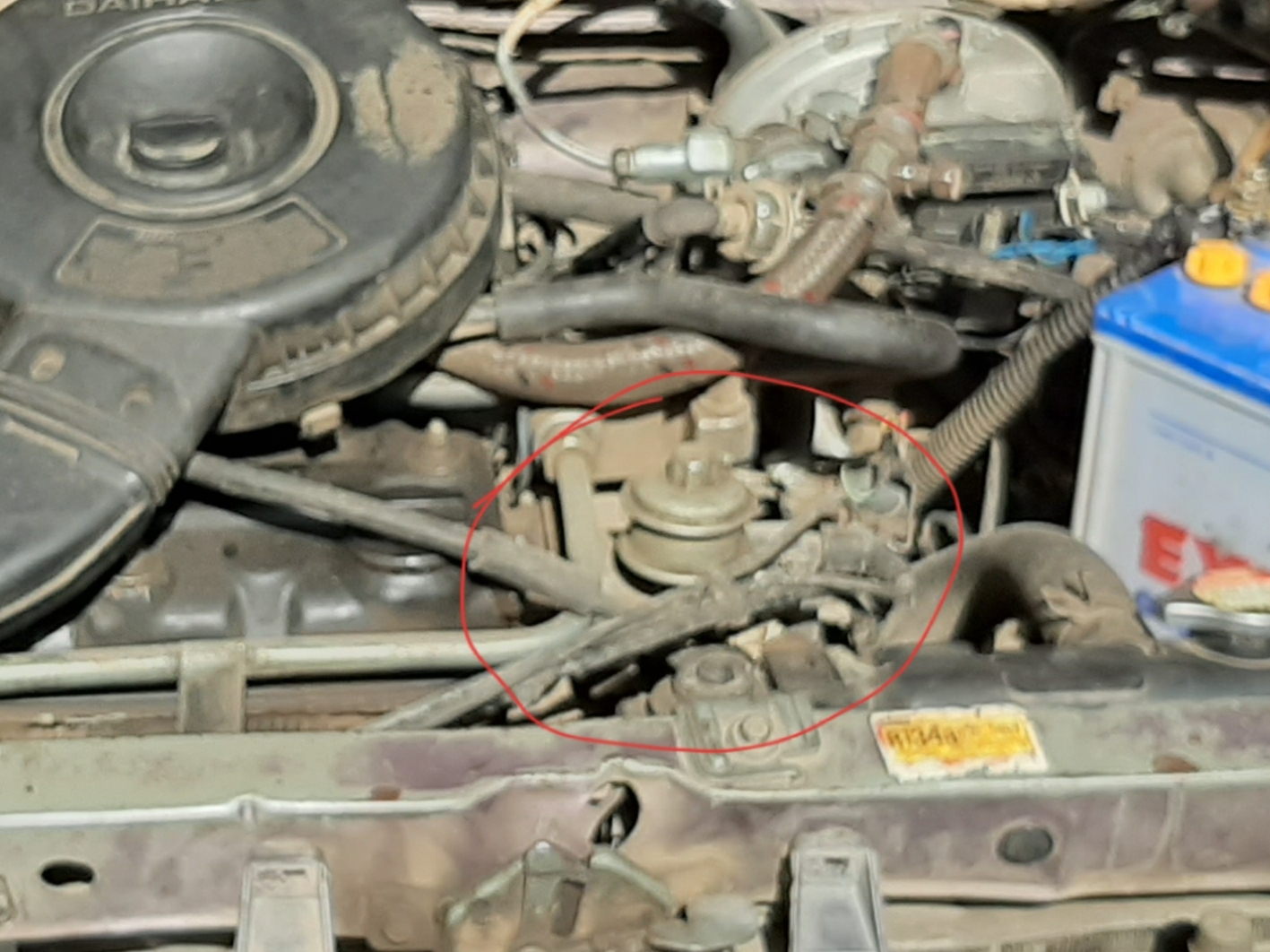

Zulfiqar bhai if you asking about this thing it has no connection. I requested the mechanics
find a mechanic, not an idiot with tools, these two vacuum connections are mandatory for correct ignition timing.

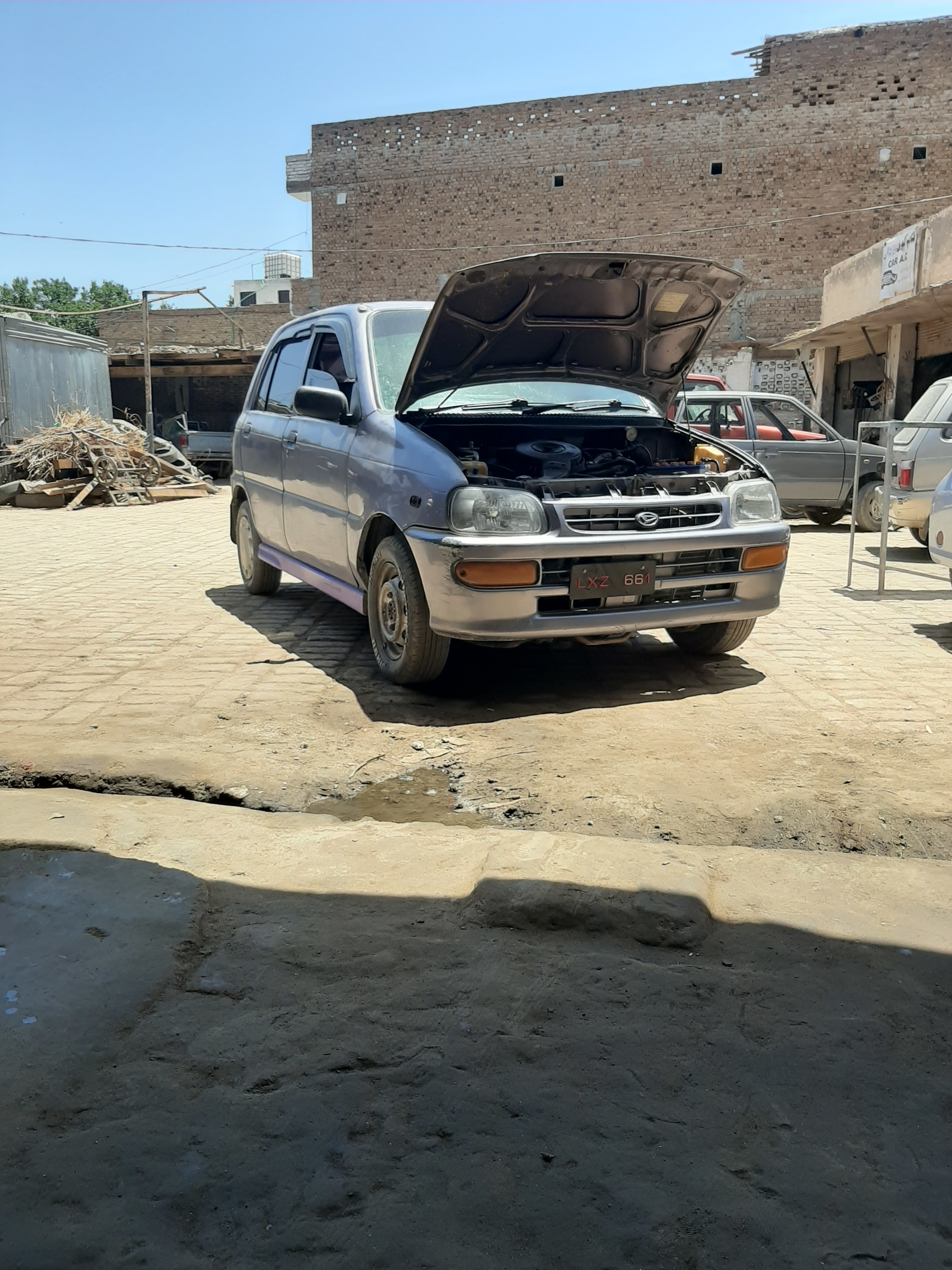

Nabeel bhai I'm sitting right now at gul Nawaz bhai place. His mechanic is puzzled. Hope to find a solution. @Xulfiqar bhai the mechanic is not fixing the vaccum hose on distributor he said there is no need of itThe car still stall at D and RI am waiting for AC repair guy to see if its AC gas issue
@dayrider brother both zubair mechanic and gul Nawaz bhai are great person. Gul bhia bhai said it's a technical fault. Will check it after eid in sha Allah. Problem still persists

The diagram is posted here and can also be had from any toyota dealer in Pakistan too. - Is the distributor original to the car? or is the famous "kabul ka cdi wala"
Ok zulfiqar bhai. Bte the owner gul Nawaz said there is no problem with car or the ac etc. There is some technical issue. How will I find whether it's original or kabhi. Coz these people know nothing. I have downloaded complete cuore manual which was posted by pakwheeler
The vacuum hoses are the technical fault. Before you go there again, let me know, will straighten him out.There is another workshop that is much more technically advanced than him, but he might probably be too costly for your liking

Visit dabstermotorsports. You can find their details using the search options. Show them the diagram for the vacuum connections, they will get that done for you
