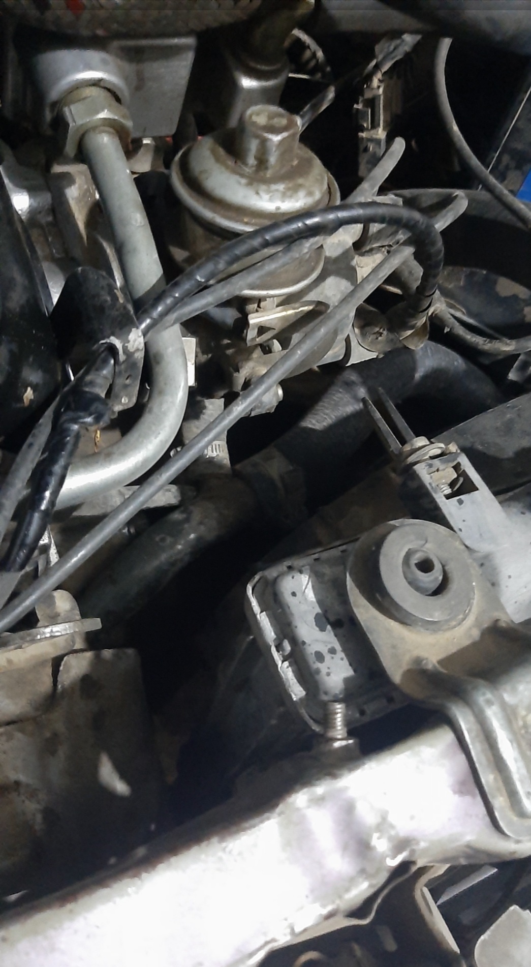

Kisi mechanic ki check krwain may b EGR valve hu

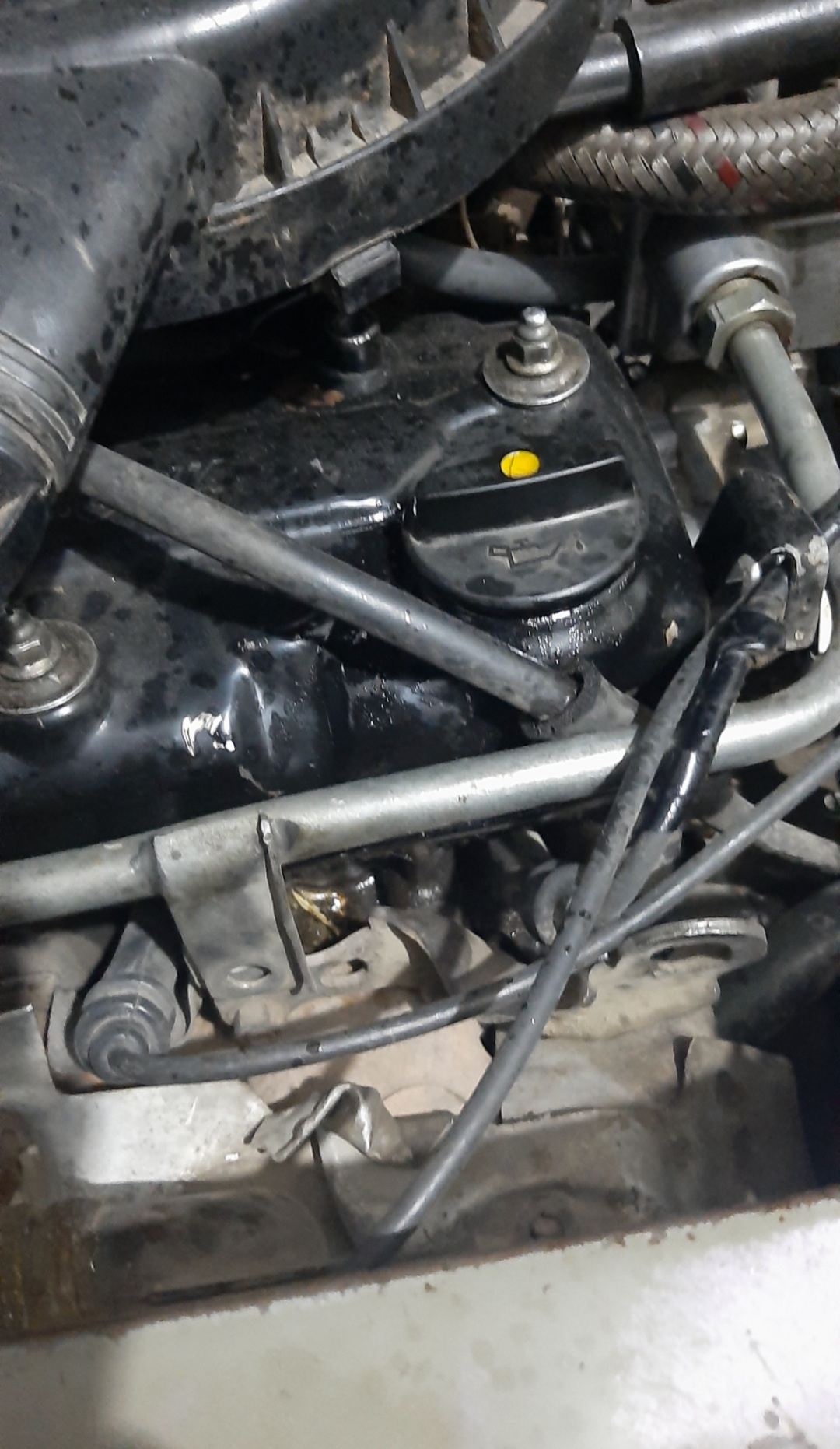

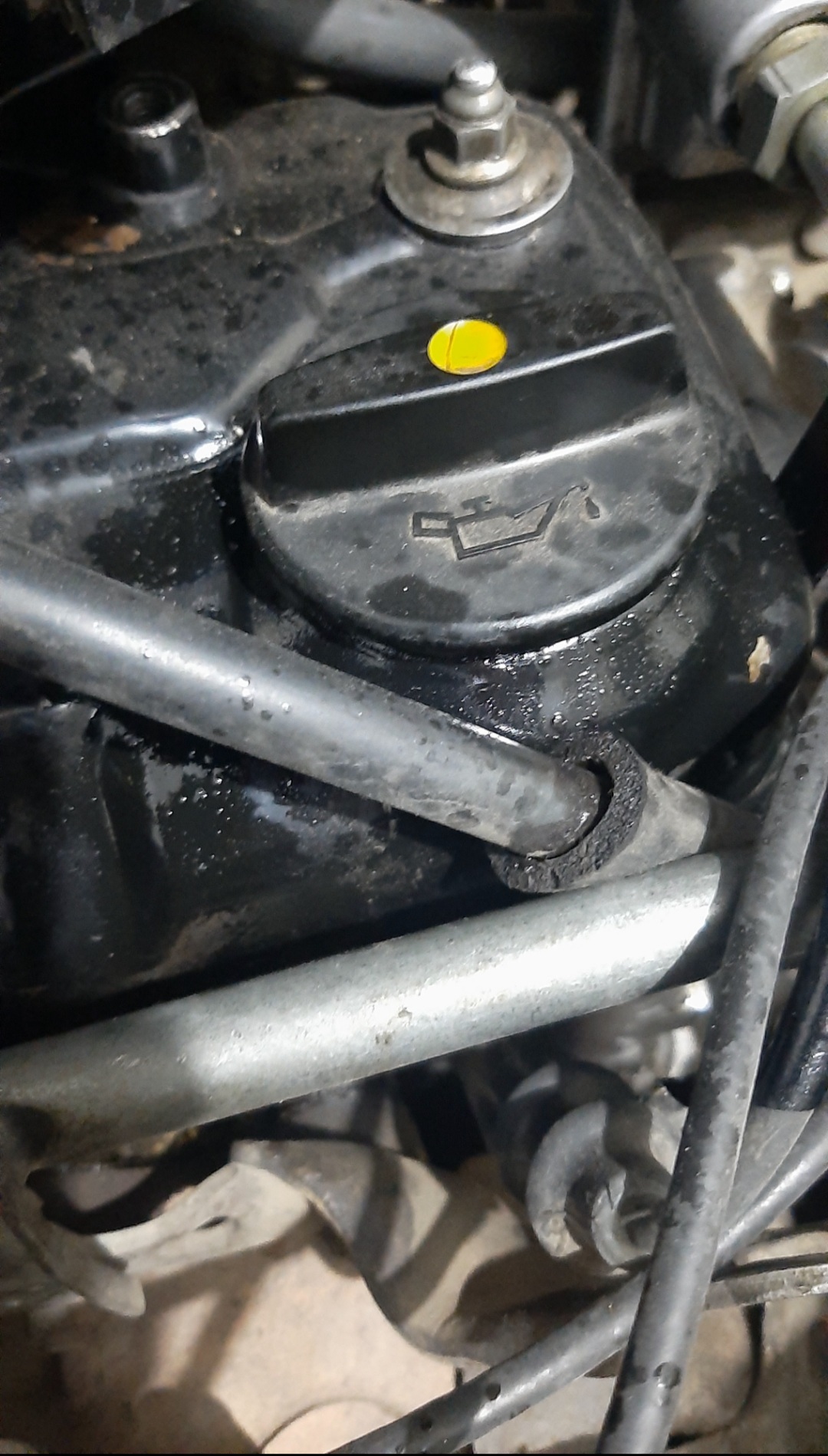

Now the whole engine bay is covered with oil splashes. Today I change the seals and tippet cover and then the oil filler cap with original but still its the same.

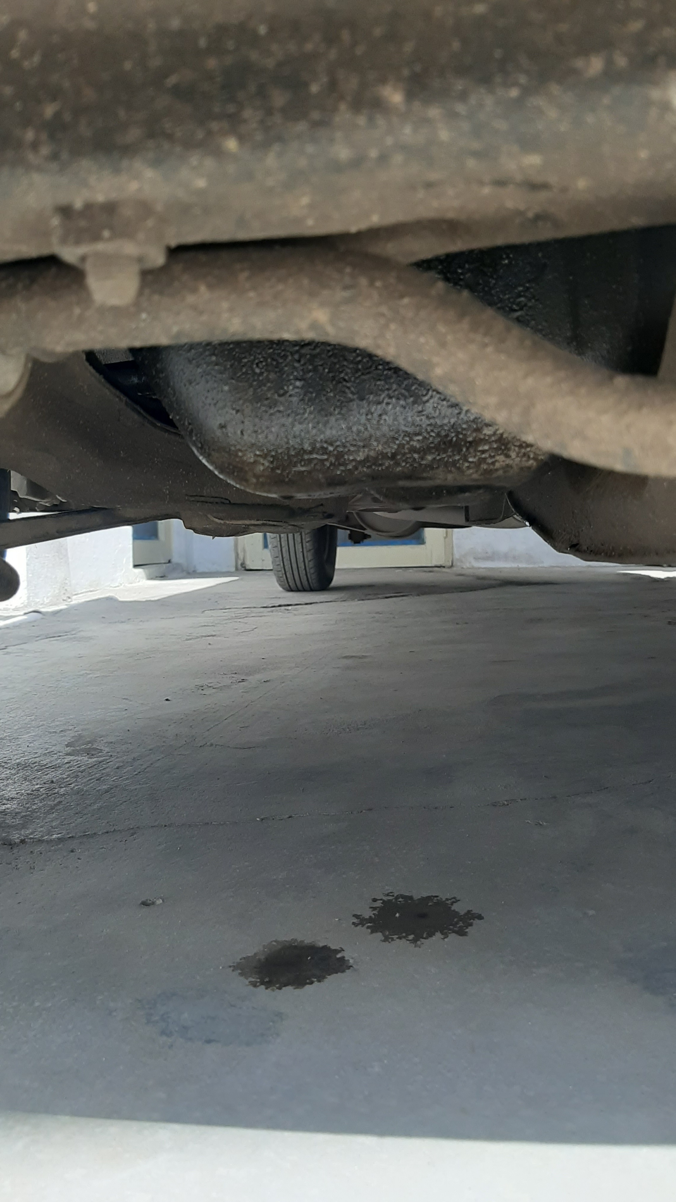

Find a proper mechanic, it seems like the sump gasket is leaking.
Wash it first, then check for leak
@Xulfiqar
Yesterday I have changed everything also the sump gasket
What am I looking for here?
Sir oil cap leaking. Blow pipe was also blocked
is your mechanic actually an auto mechanic or does this work on side?
Most people don't what they are doing sir
Find someone else
Remove valve cover, fully clean it, clean the vent at the rear of engine too,
Replace sump gasket and wash the engine off to see fresh leaks
