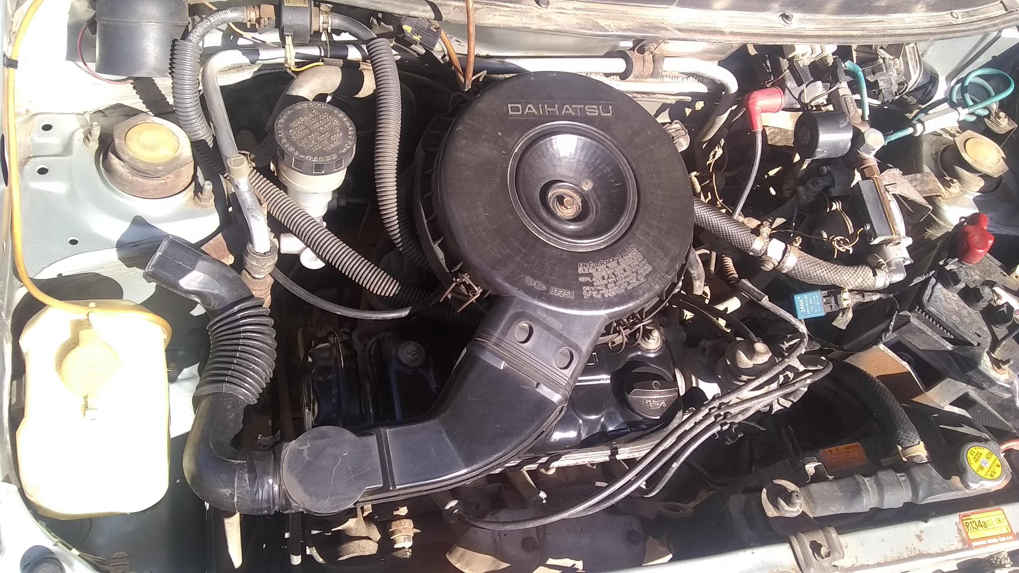

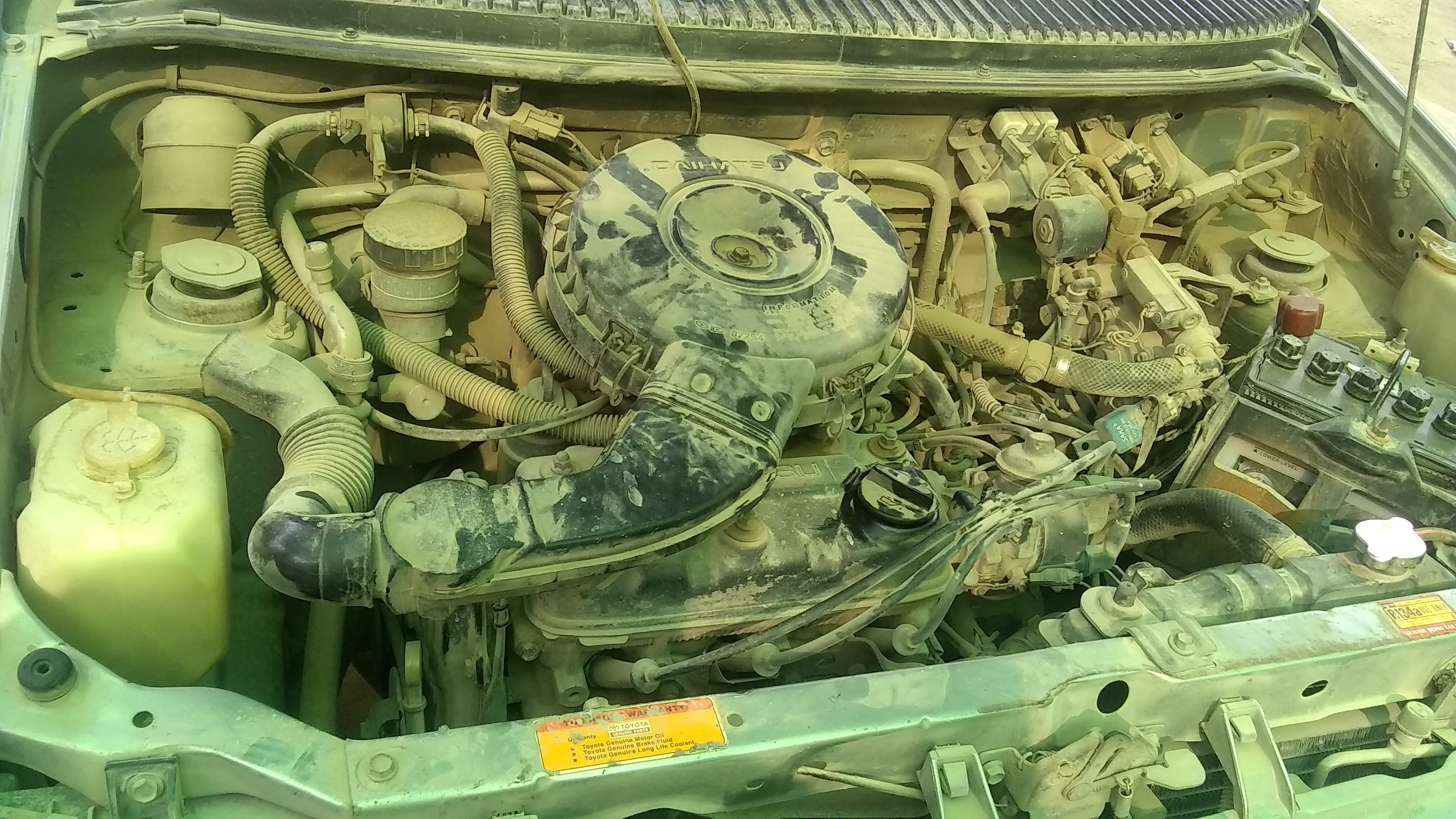

Before
After
How?
Nice job . Which product used ? Diy or professional work ? By the way what is relay for near battery? Wires of relay are not insulated. Radiator cap doesnt seem to be closed properly in pics. Which model is this cuore ?

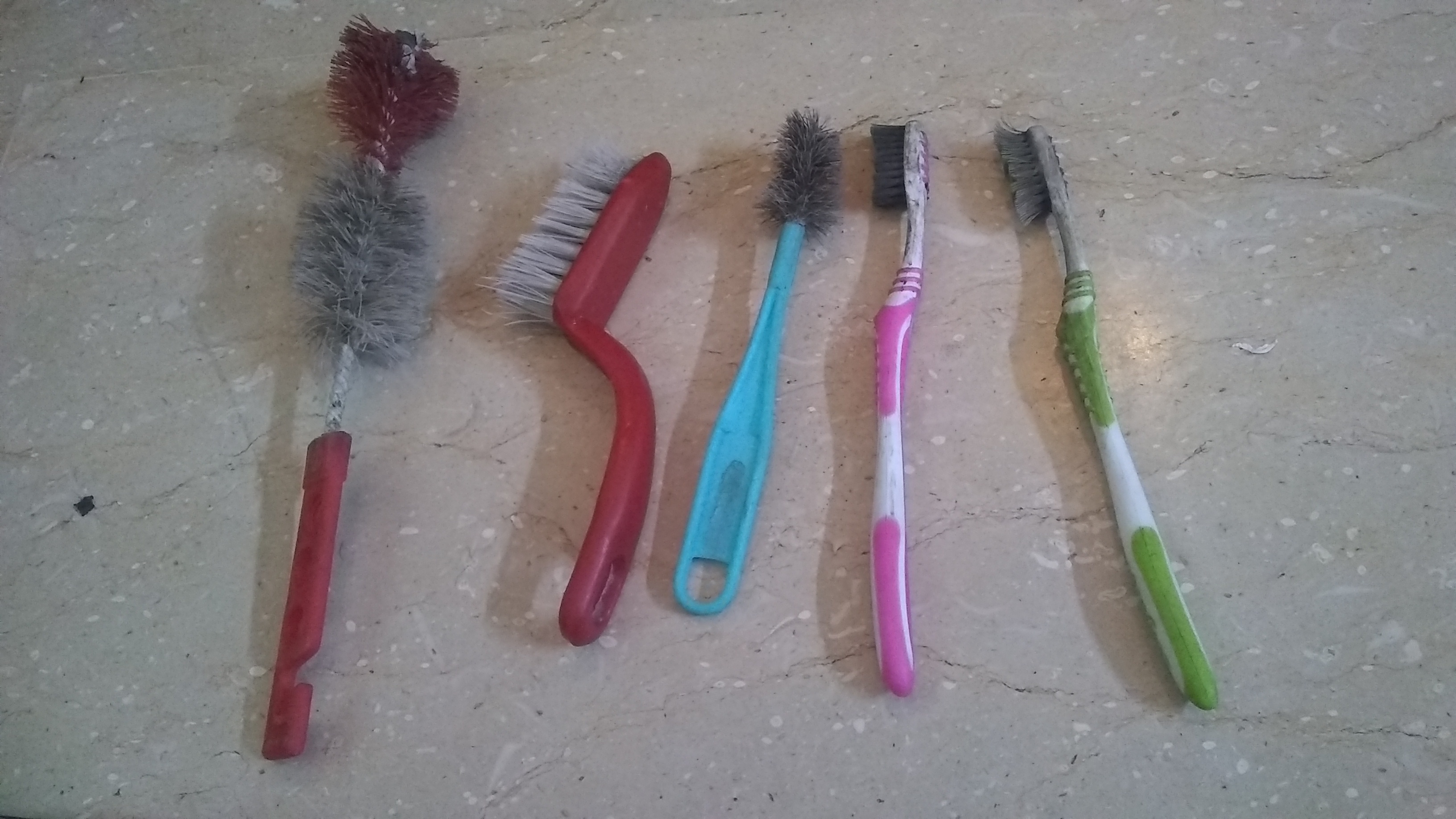

Completely DIYProduct used WD-40 Degreaser and few brushes and microfiber clothes
I will check the cap,just got the new one
Model 2011 FF CNG/AC

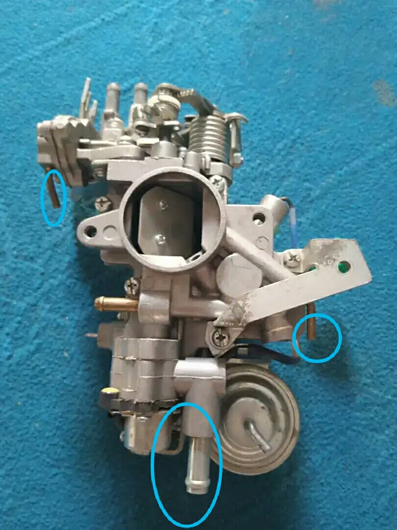

Uploading... Aoa koe cuore owner kindly mjh yeh circle wala points apni gari sa dhk ka bata de kaha lagna hain smjh nia arhi new carburetor lia ha old wala m yeh point nia laga hue kindly pics agar koe bahi upload kr tu meri trah kisi aur ka b bhala hu jay ga jazak Allah
Front pipe choke breaker, middle big pipe is overflow pipe connects to body in engine bay and backside pipe isn't used I thinkDid you buy kabli carb?
g sir kabli lia ha choke breather pipe kaha pa laga ga
Ye delay valve se connect ho k vacuum hoses k through distributor k advance timing port se connect ho ga.Kitne ka Mila Hai kabli carb? Kahan se
choke breather ko kia block krta hain ya open he chor deta hain ya carbueretor m kisi port pa connect krta hain
Upr Wali post me likha Hai mene kahan connect krna Hai. Apki auto choke chal ri Hai?
g sir autochoke tu xhal rhi ha but yeh delay valve nia ha mera pass kia aisko vacume hose sa disributor ki upper port pa laga dn and I bought it 23500 from olx to a person from lahore
Achi price me mil gya apko. Kabli parts shop se delay valve mil jae ge. Distributor k niche wale port pe connect ho ga
