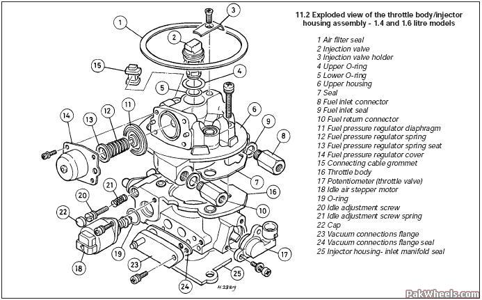

@Daemon
No adjustable tappets....For throttle body cleaning, just open the IAC valve and spray some WD-40. Set the ignition at 'ON' and then 'OFF' several time repeating WD-40 spray after each ON-OFF. Similarly spray WD-40 in the IAC housing in the Throttle body. Then spray some WD-40 at the butterfly. Just put back IAC and start engine. Give some throttle and again spray the WD-40 at the butterfly. It's Done!

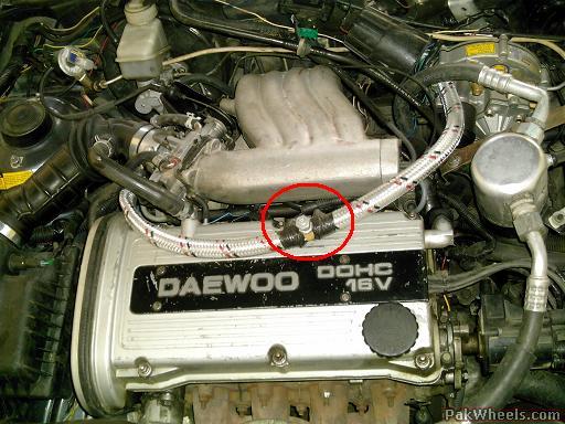

Regarding the T:
It is located in between the throttle body and the CNG regulator.
