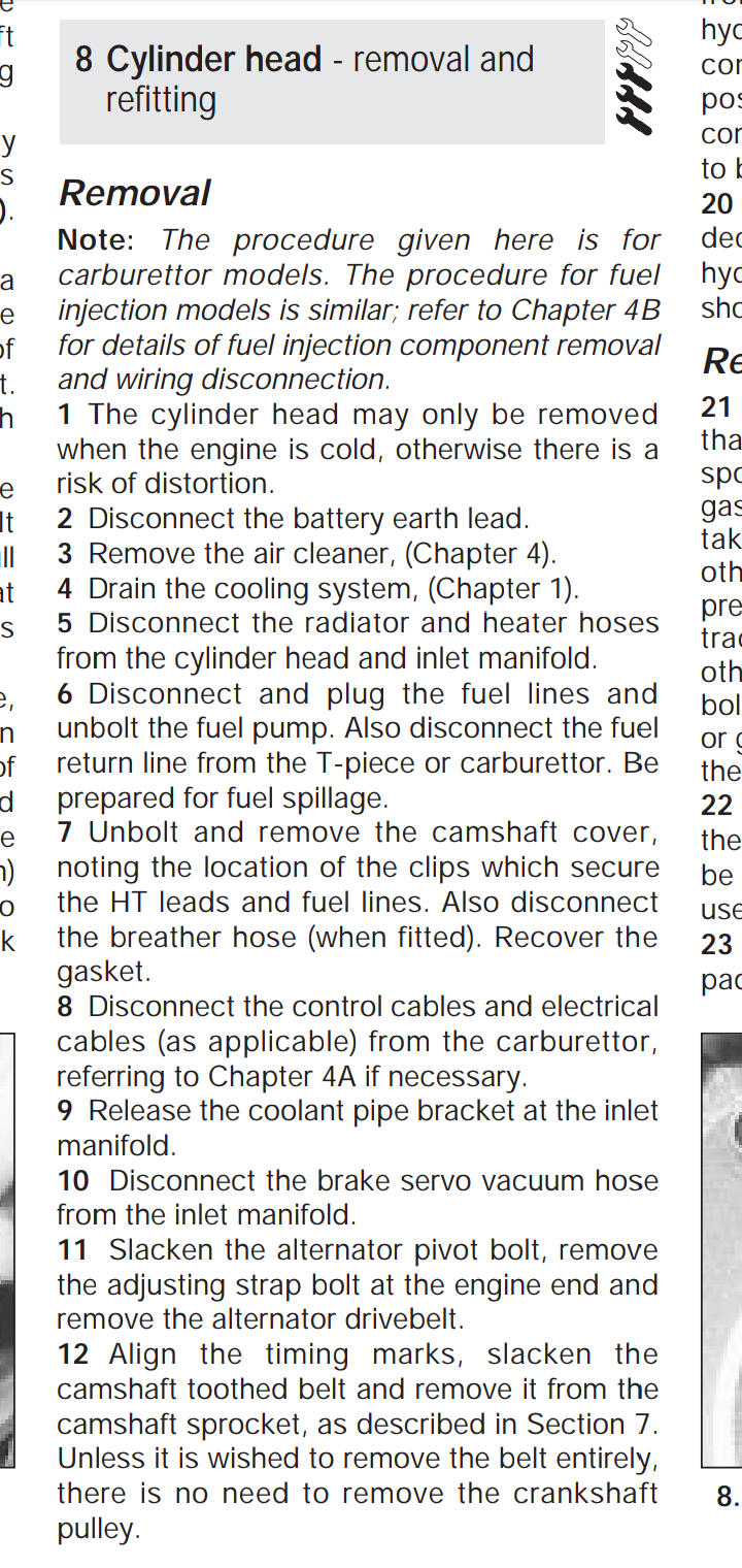

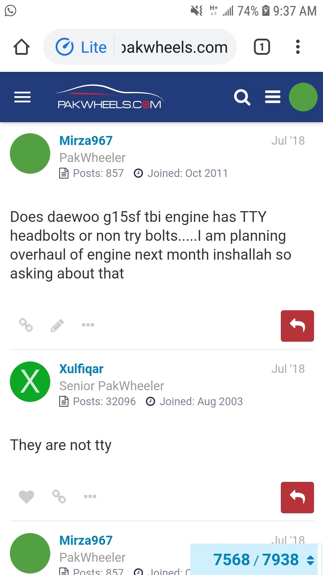

1. Daweoo OHC TBI engine cylinder head bolt are TTY or non TTY how to differentiate?

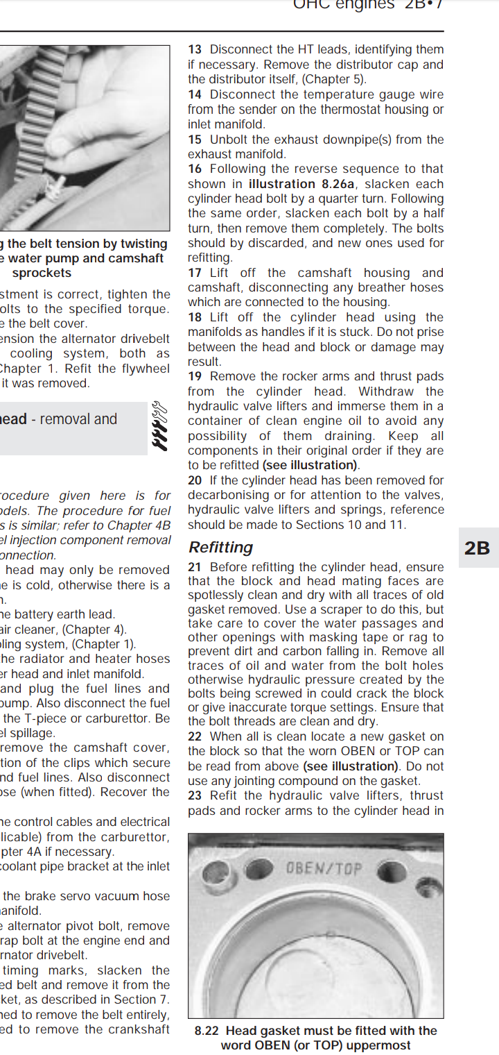

2. All bolts loose but any idea to remove the camshaft do I need to remove the camshaft pully from the cover?
3. Inlet Manifold removal need the Trottle body or not. Broken loose all the nuts but things are sticking on gaskits so determining the best way to crack them loose without damaging the engine
