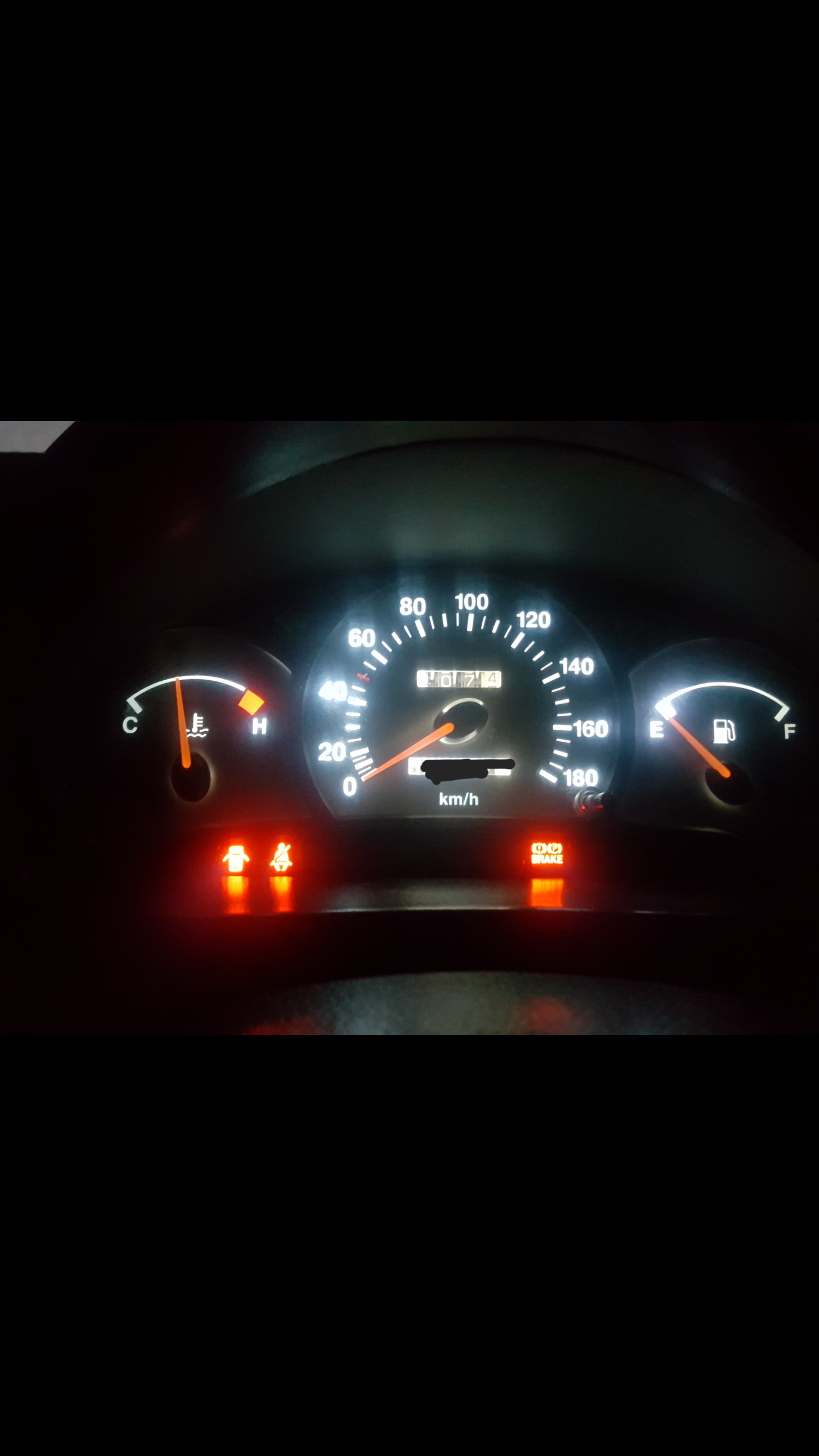

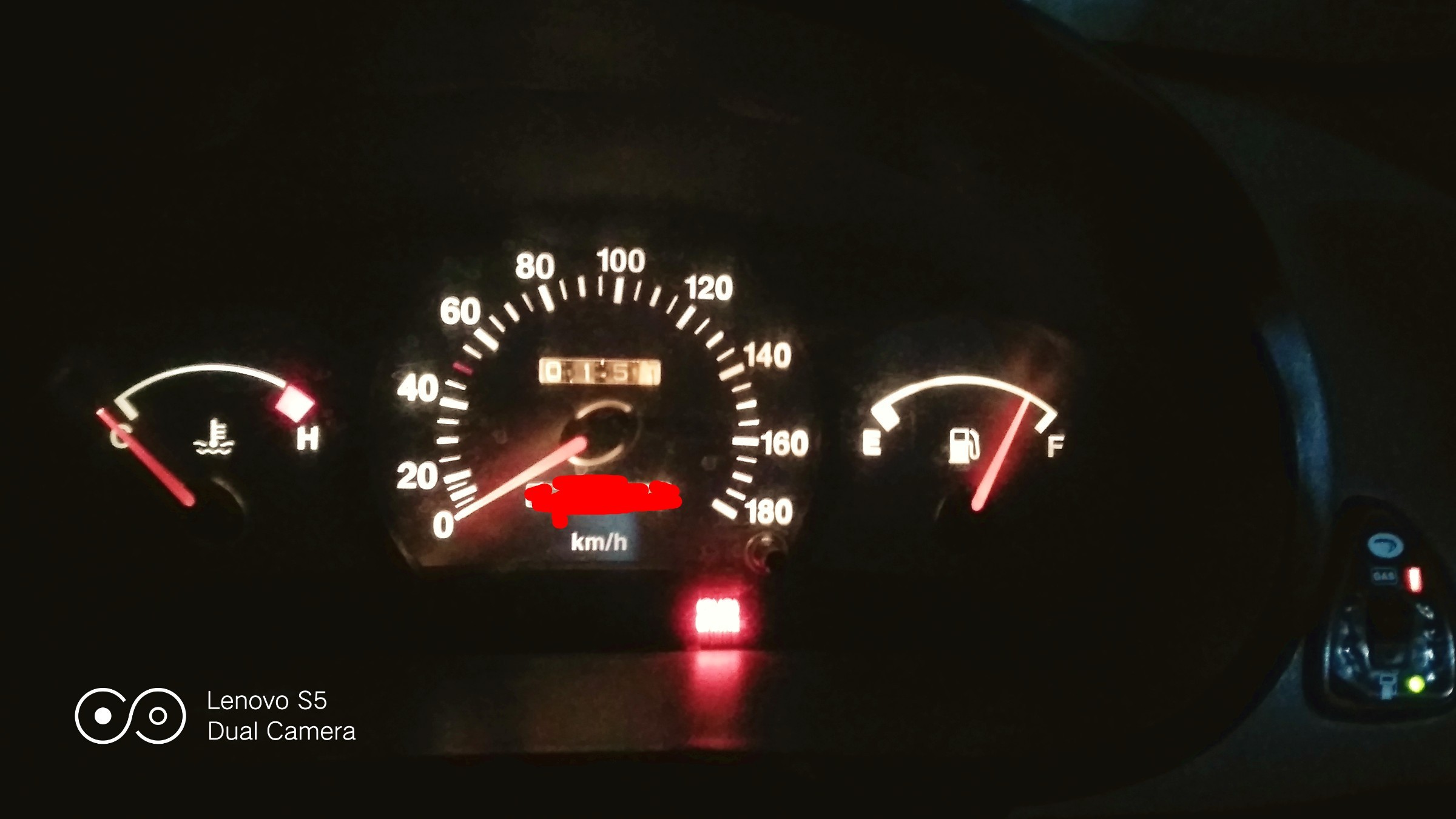

Do you install white leds in it?and also red led in needle.i have also installed white leds in meter and needle also glows (orange shade)but i have not installed any led for needle.by this mod meter looks cool.

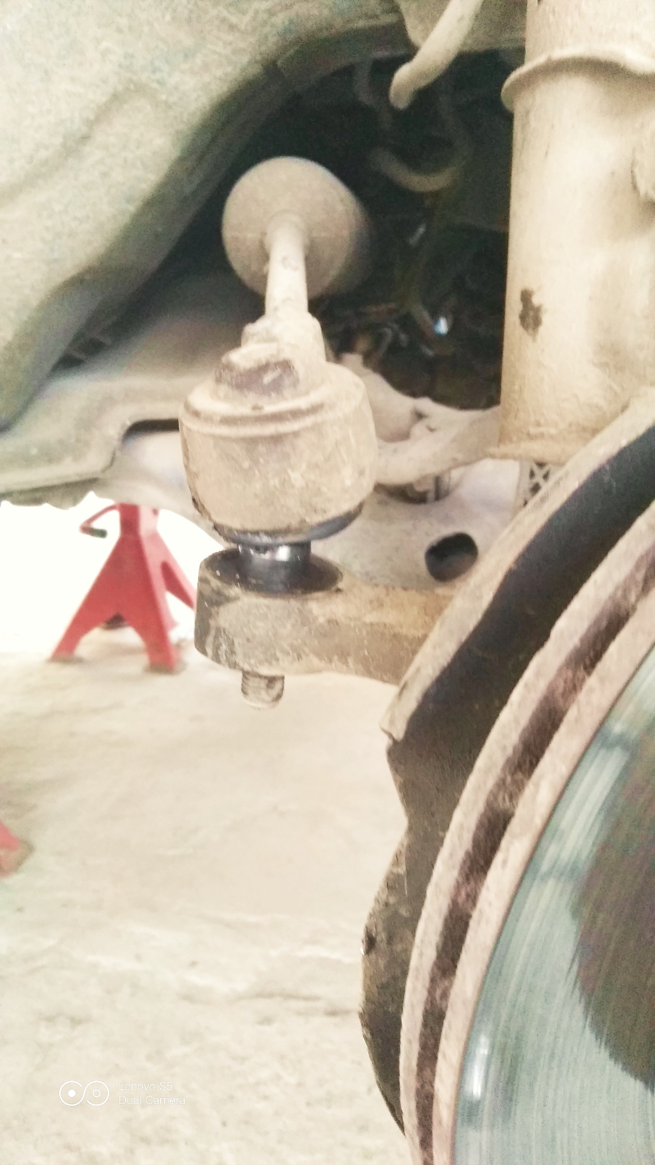

He only had changed shocks, without springs? And from which shop did you get this done? Shop name, city, location?
I didnt install any led, just had removed blue caps from original tungsten bulbs and had cleaned the whole cluster previously. No additional light installed for needle, they are glowing themselves Alhandulillah
Only shocks replaced.my springs and mount was ok.so they are used again.from sialkot.
Good work.by the way i have changed my meter filament bulb with same size led bulb and the results are stunning.only the old bub was removed and new led bulb were installed.no alteration needed.if you can install these you can enjoy much more.i have installed them almost a year ago

Sure IA. In How much Rs. You did get T10 Cluster panel LEDs and from where??
Only for RS 400.i got thoses from The guy who deals in speedometer works in sialkot.Are you also belong to sialkot?
No I don't belong to sialkot. I am from wah cantt. How many leds you got in 400?
I think 2 or 3.they were of good quality.labour of changing inculde in this.
OK. Its actual cost is 20-30Rs per led. Well definitely the speedometer guy will earn bucks from you.
But here no ones give led for this price i have also purchased led for parking light from an other shop.and after barganing he gave me a pair for rs 400.(leds which are used in parking light.i am using those in meter)
I import many things from Ali express & these lights are costing for 20-30Rs range. Of course in market no one will give you at this rate

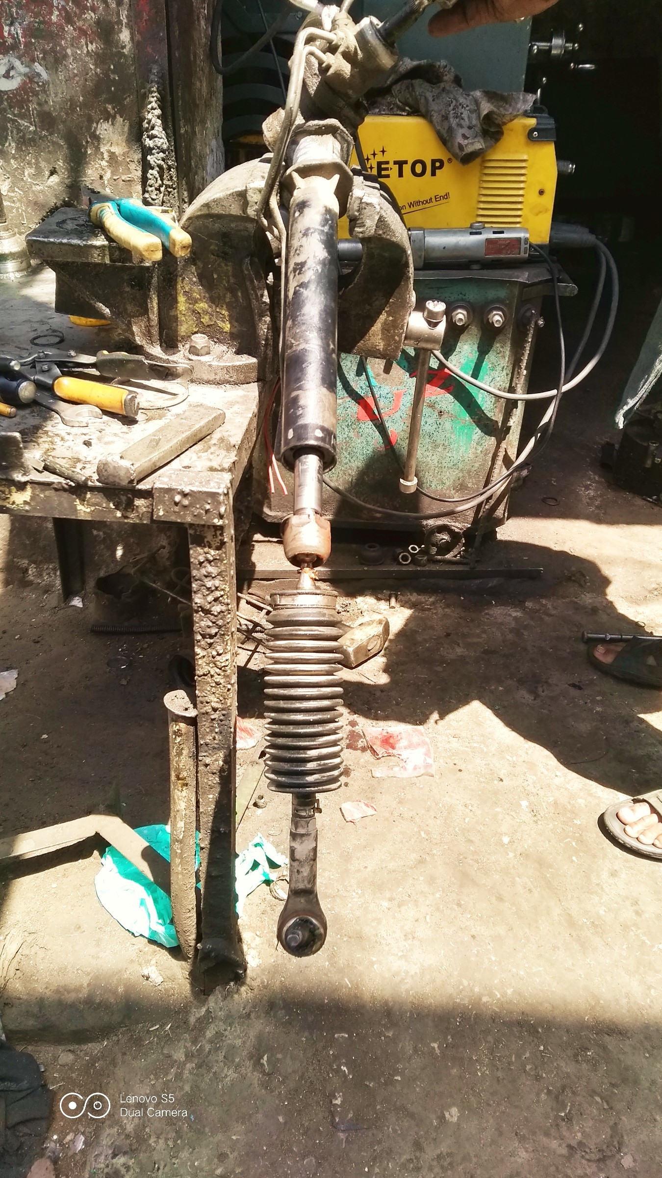

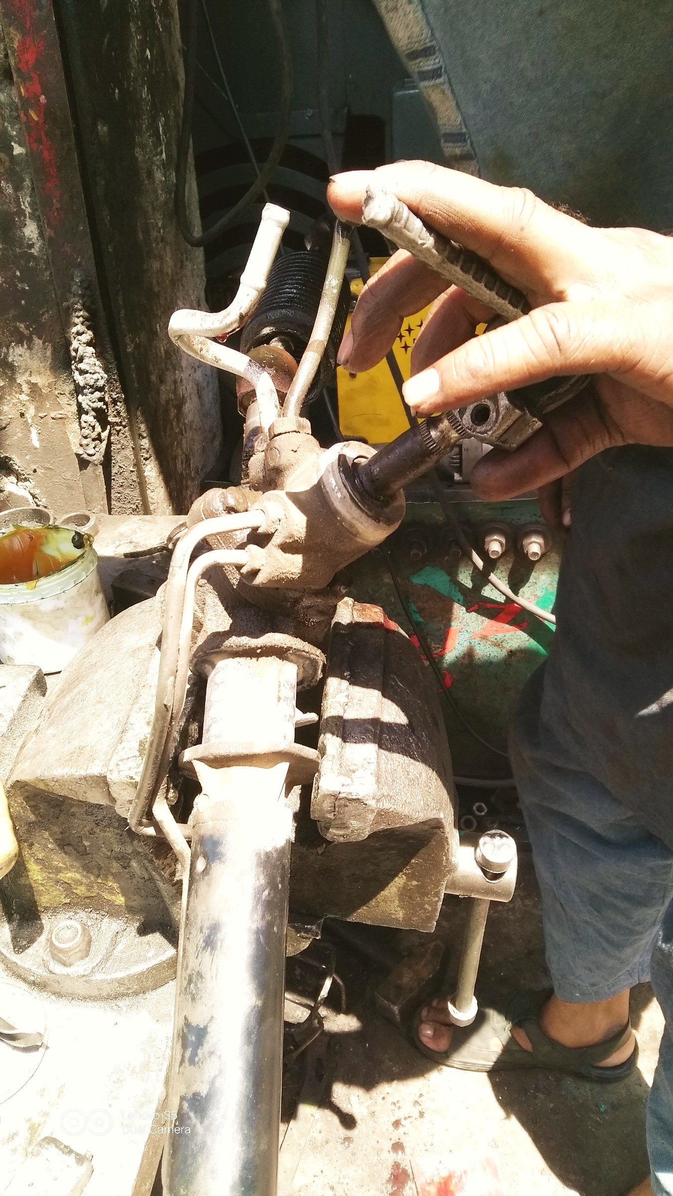

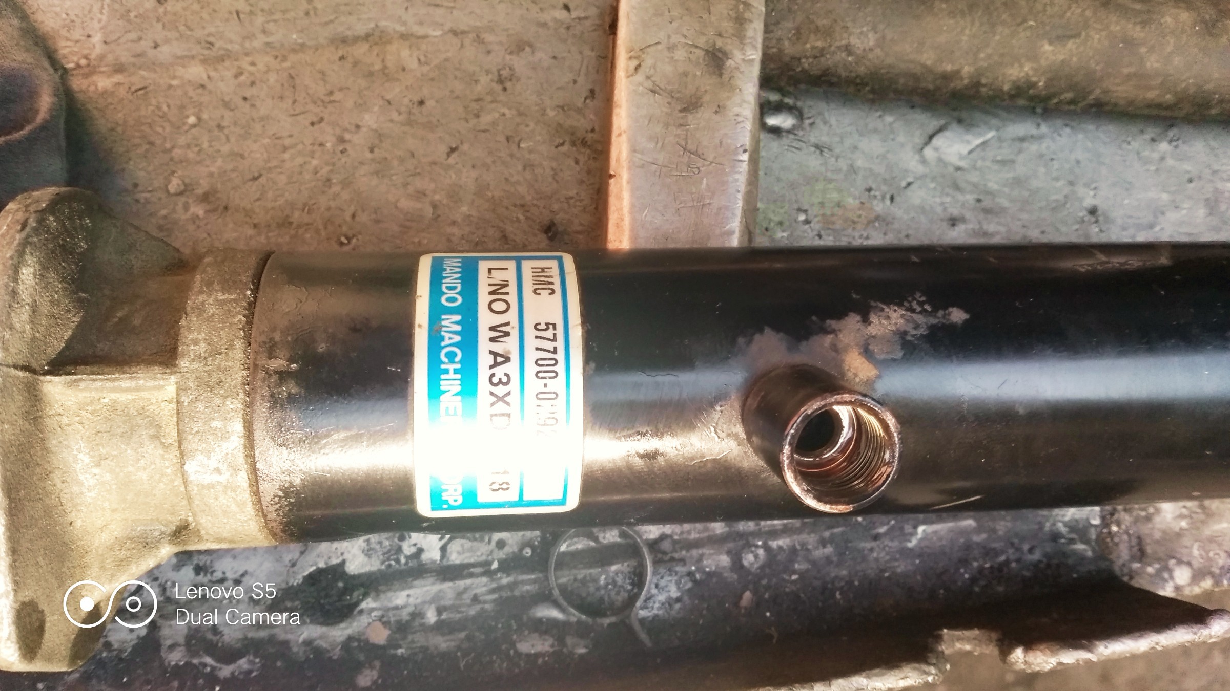

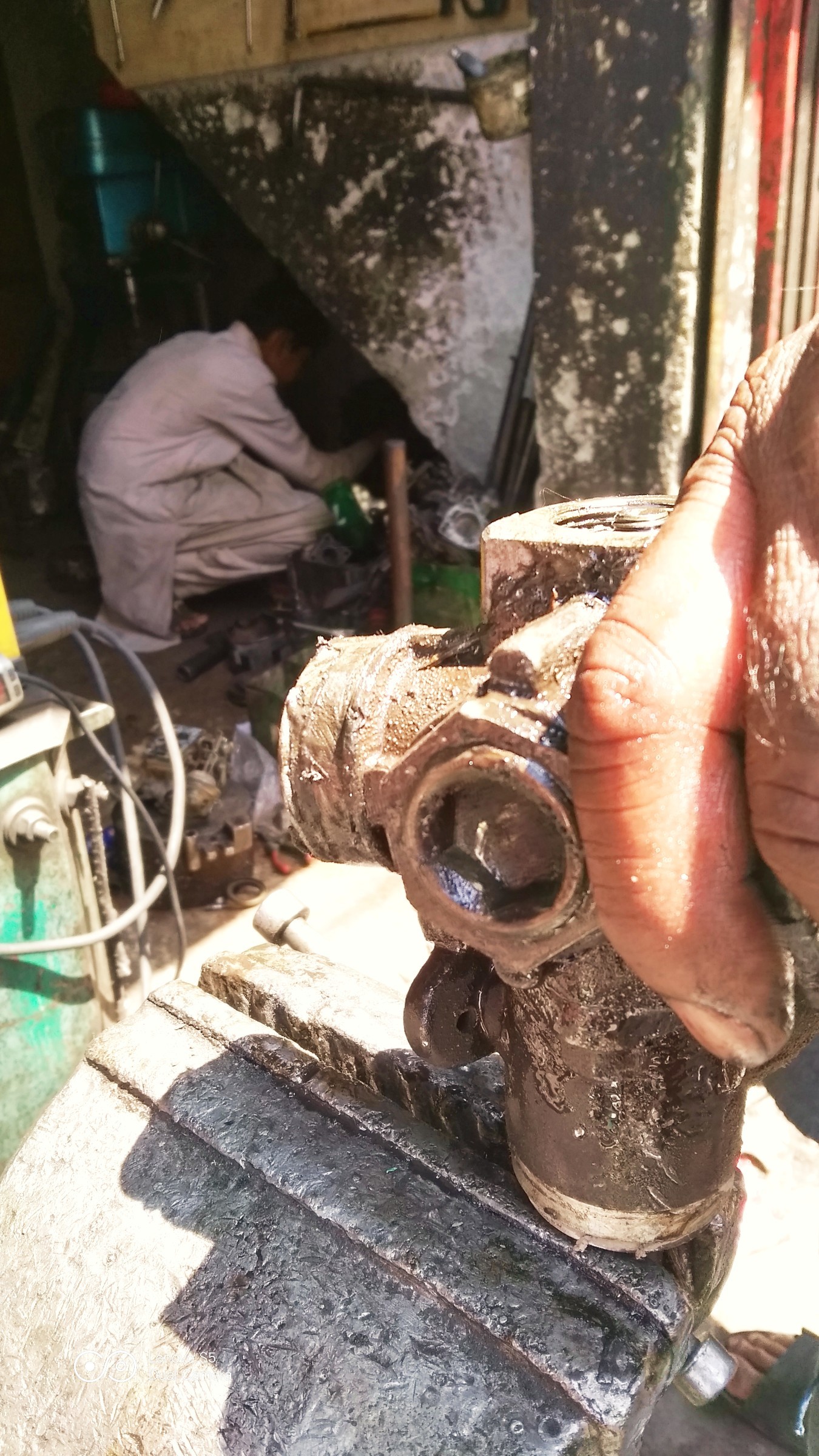

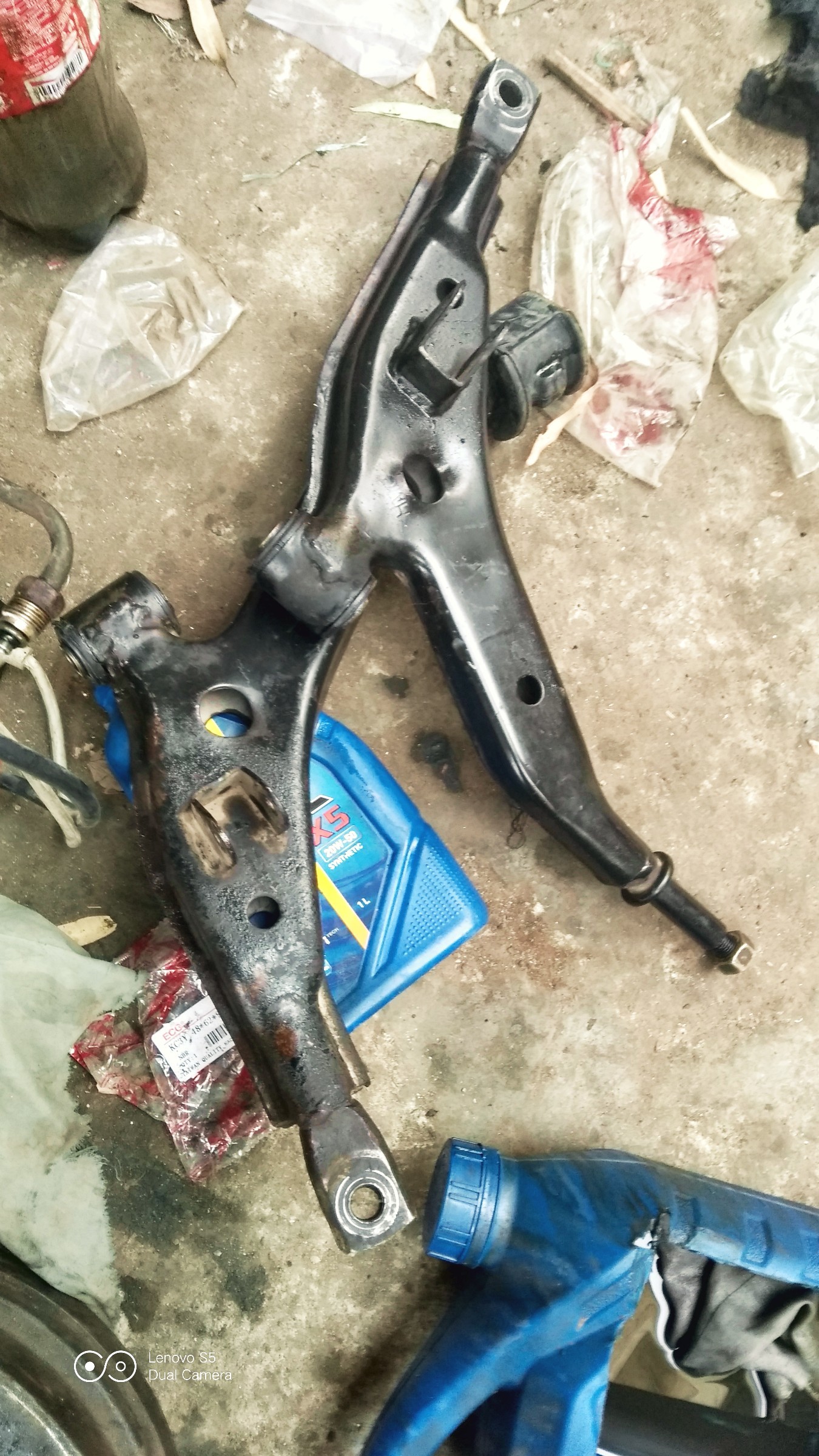

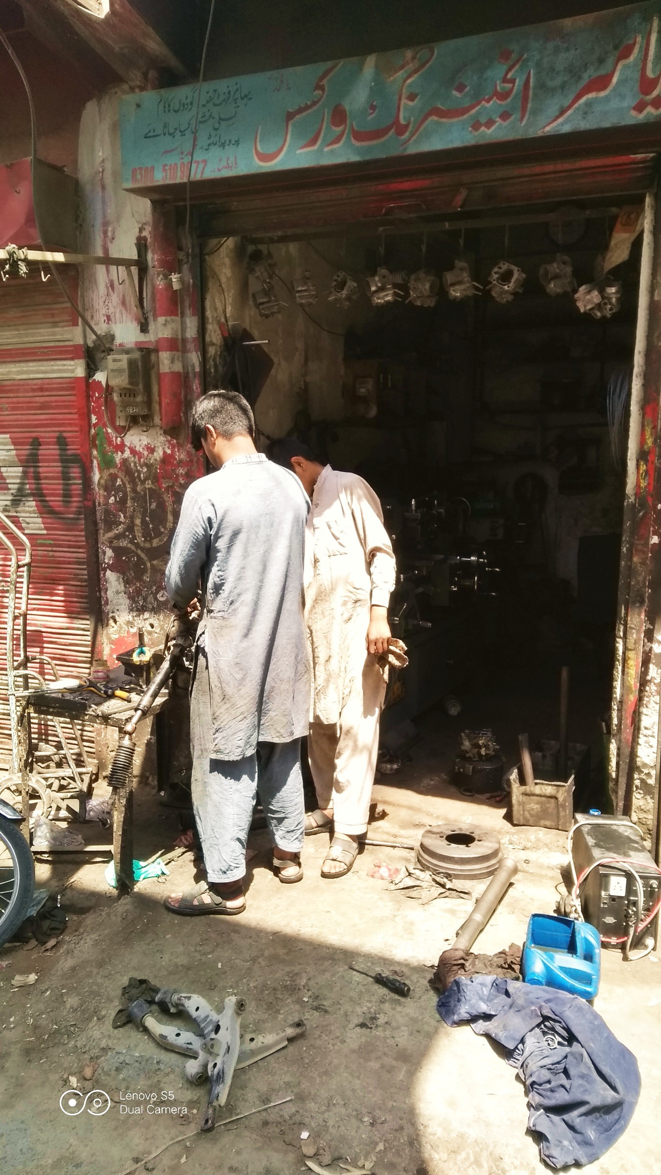

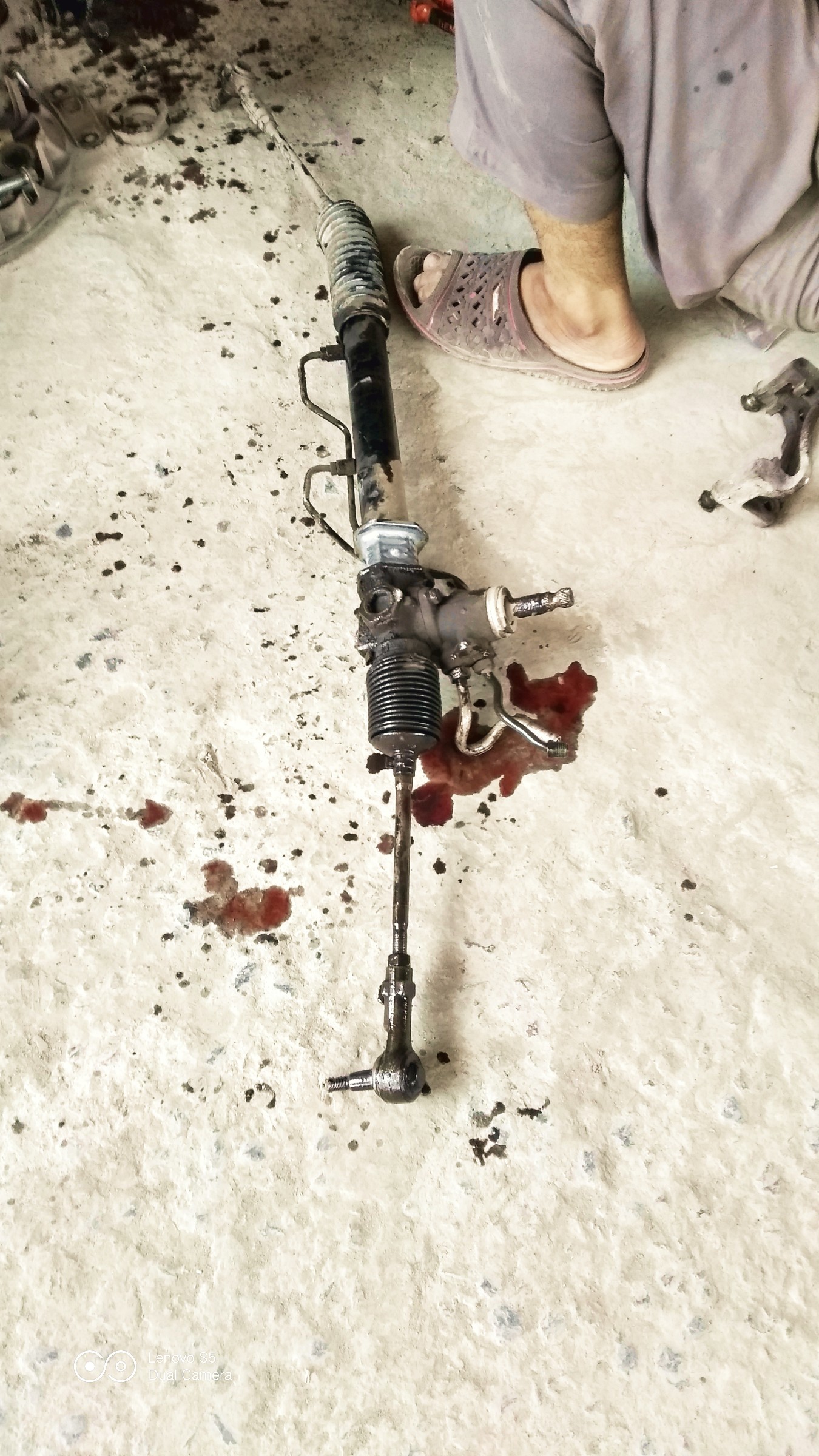

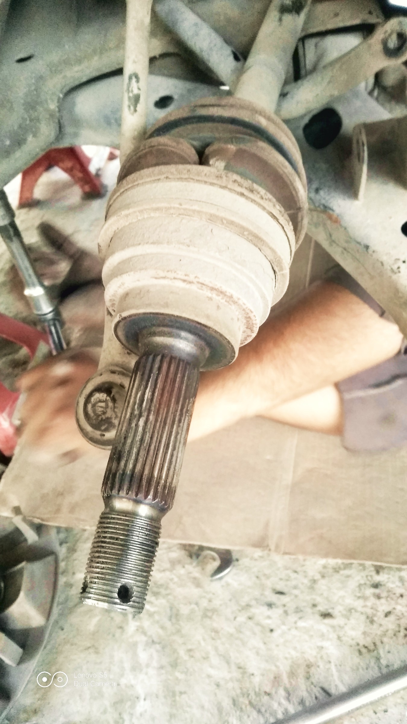

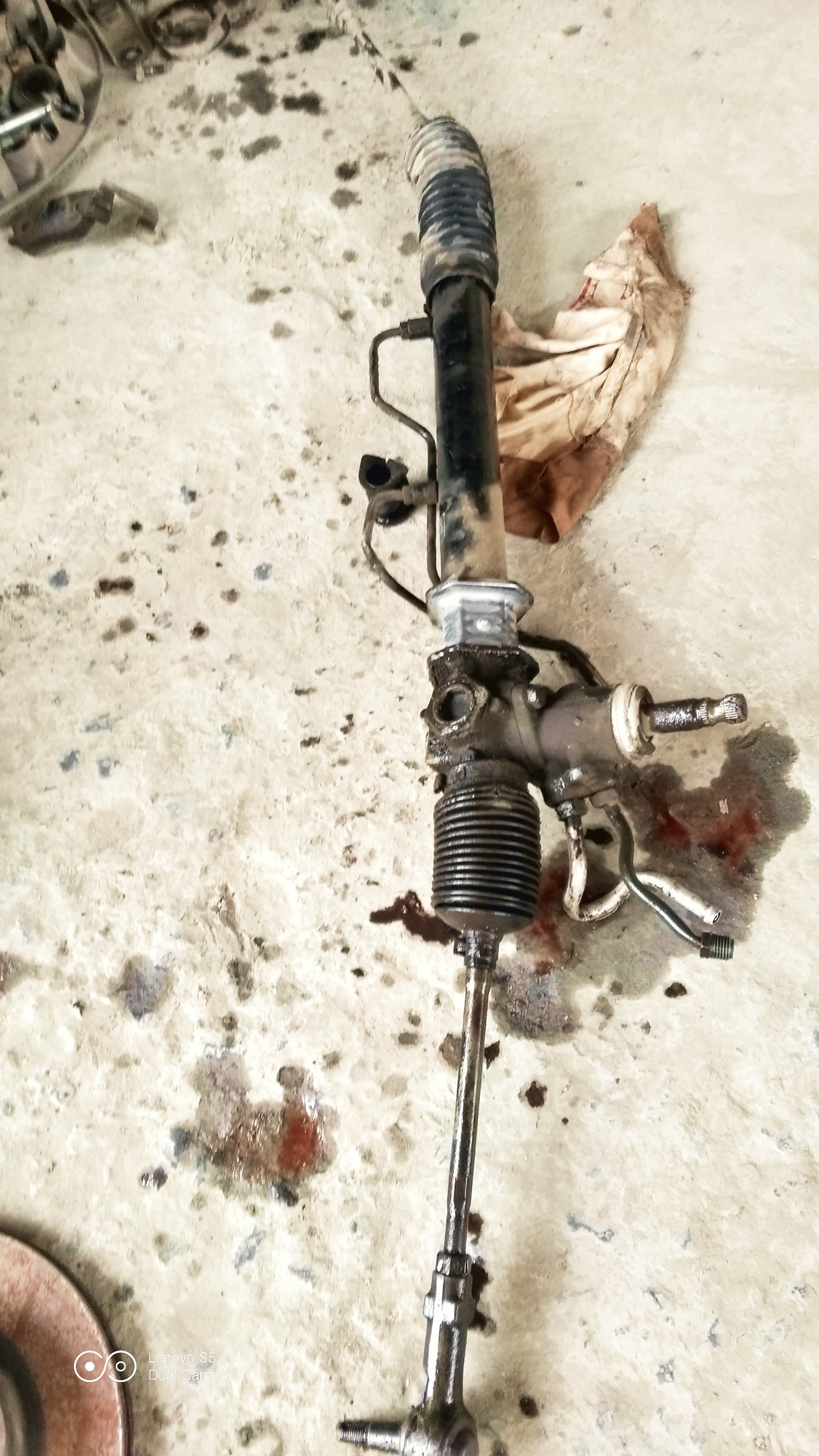

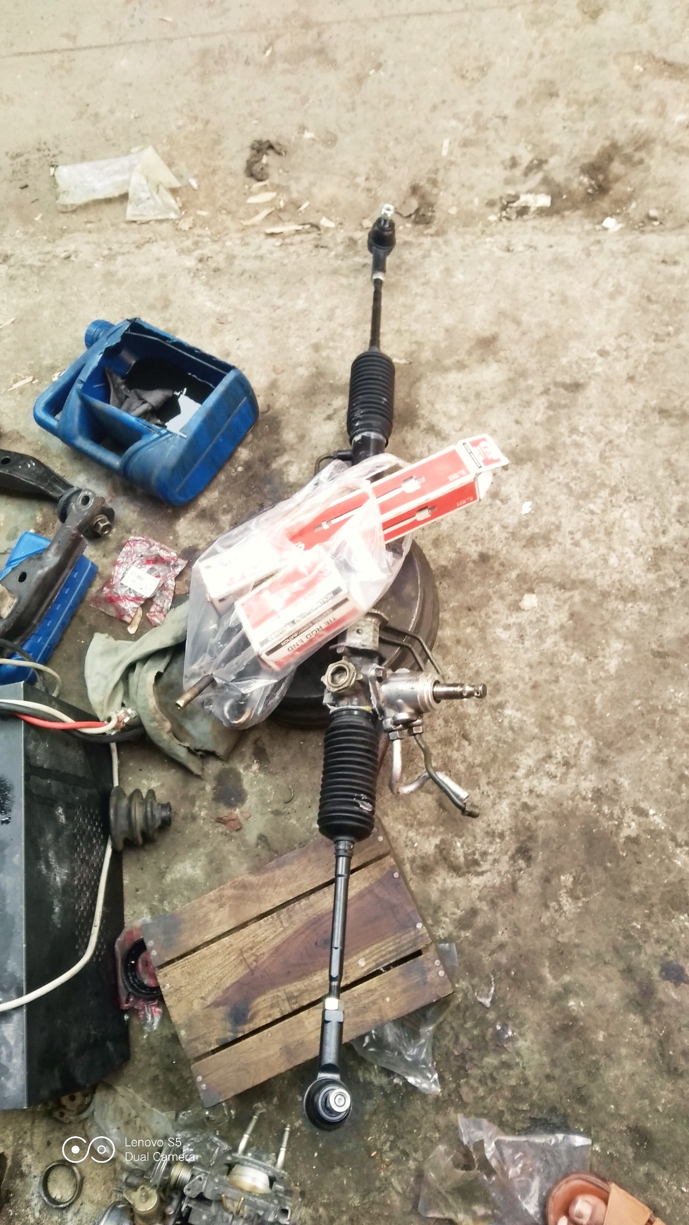

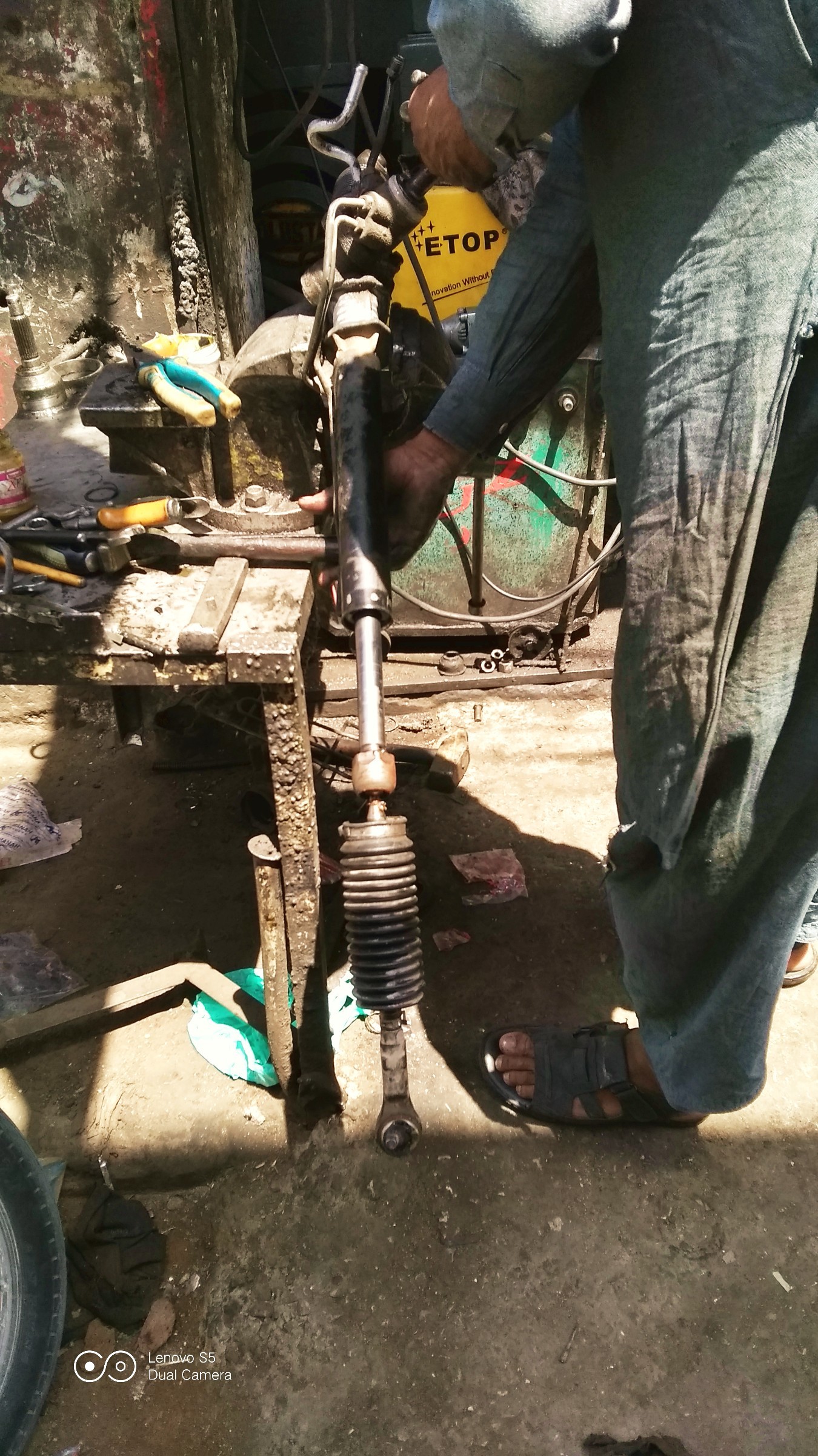

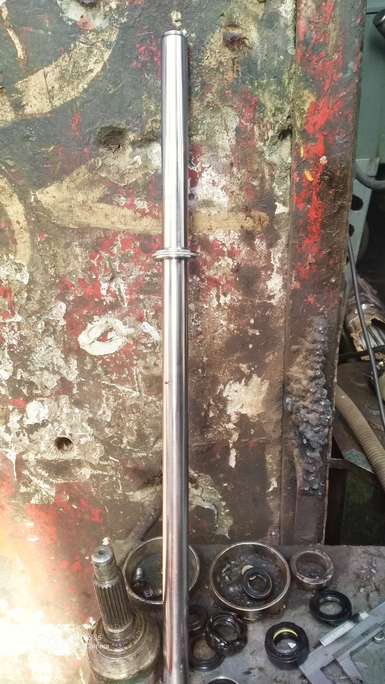

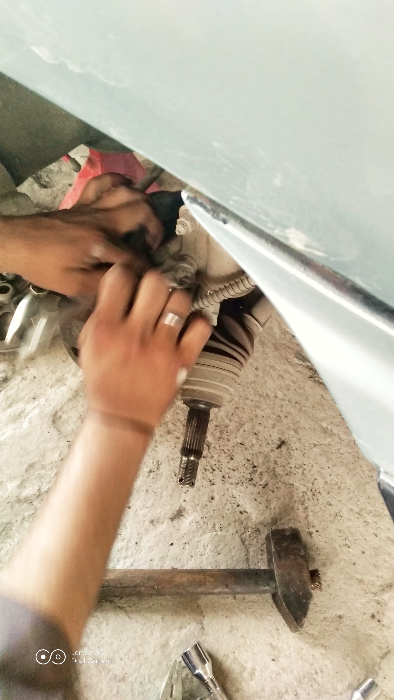

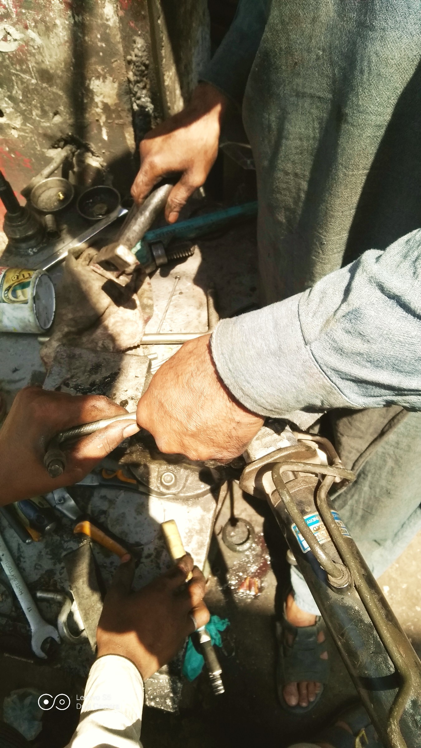

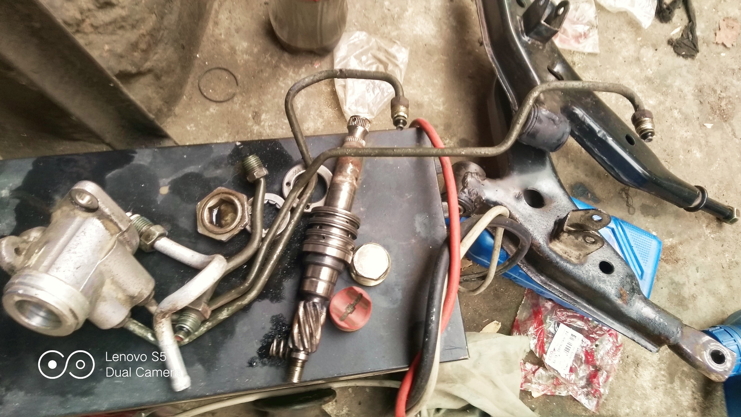

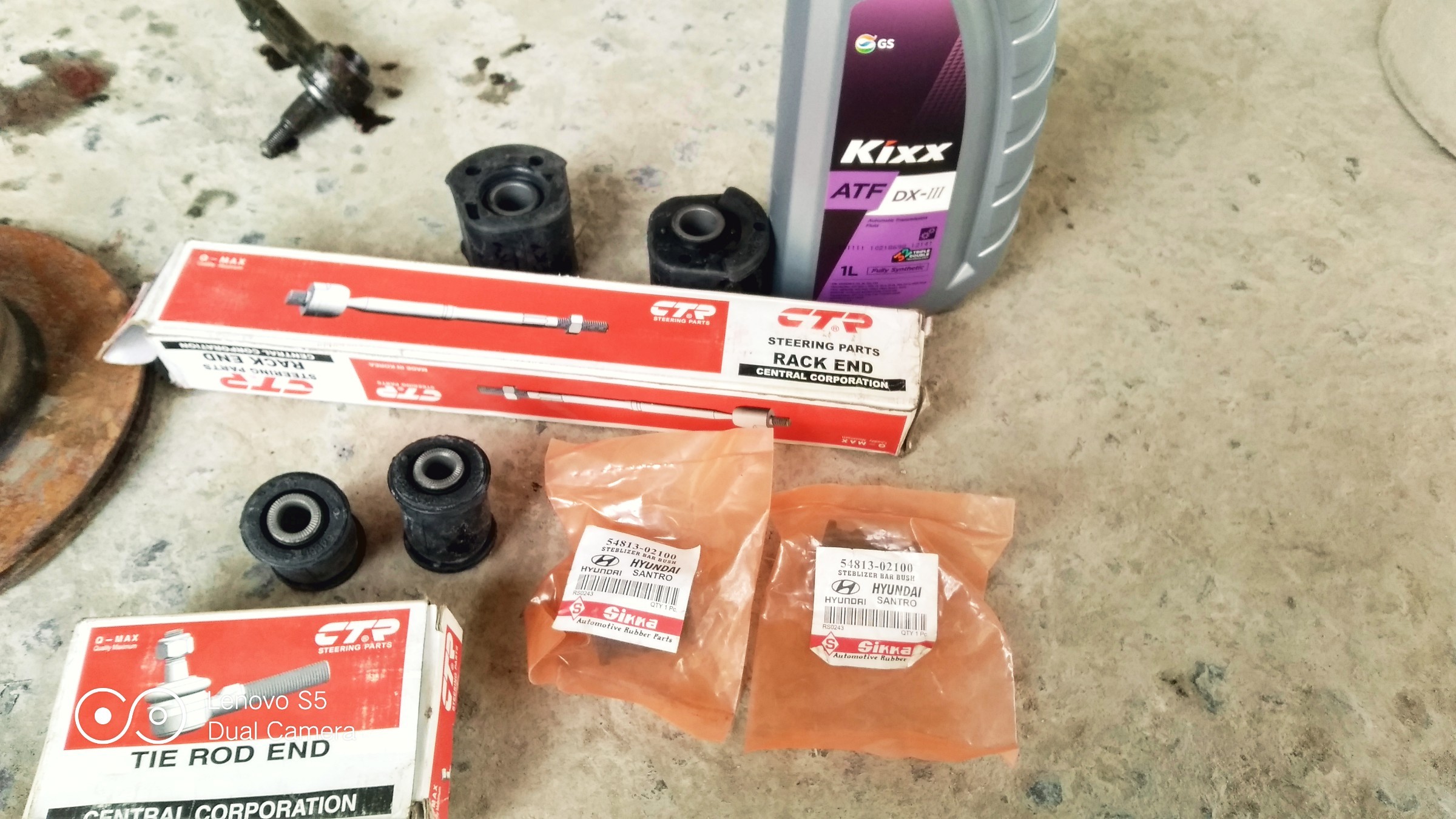

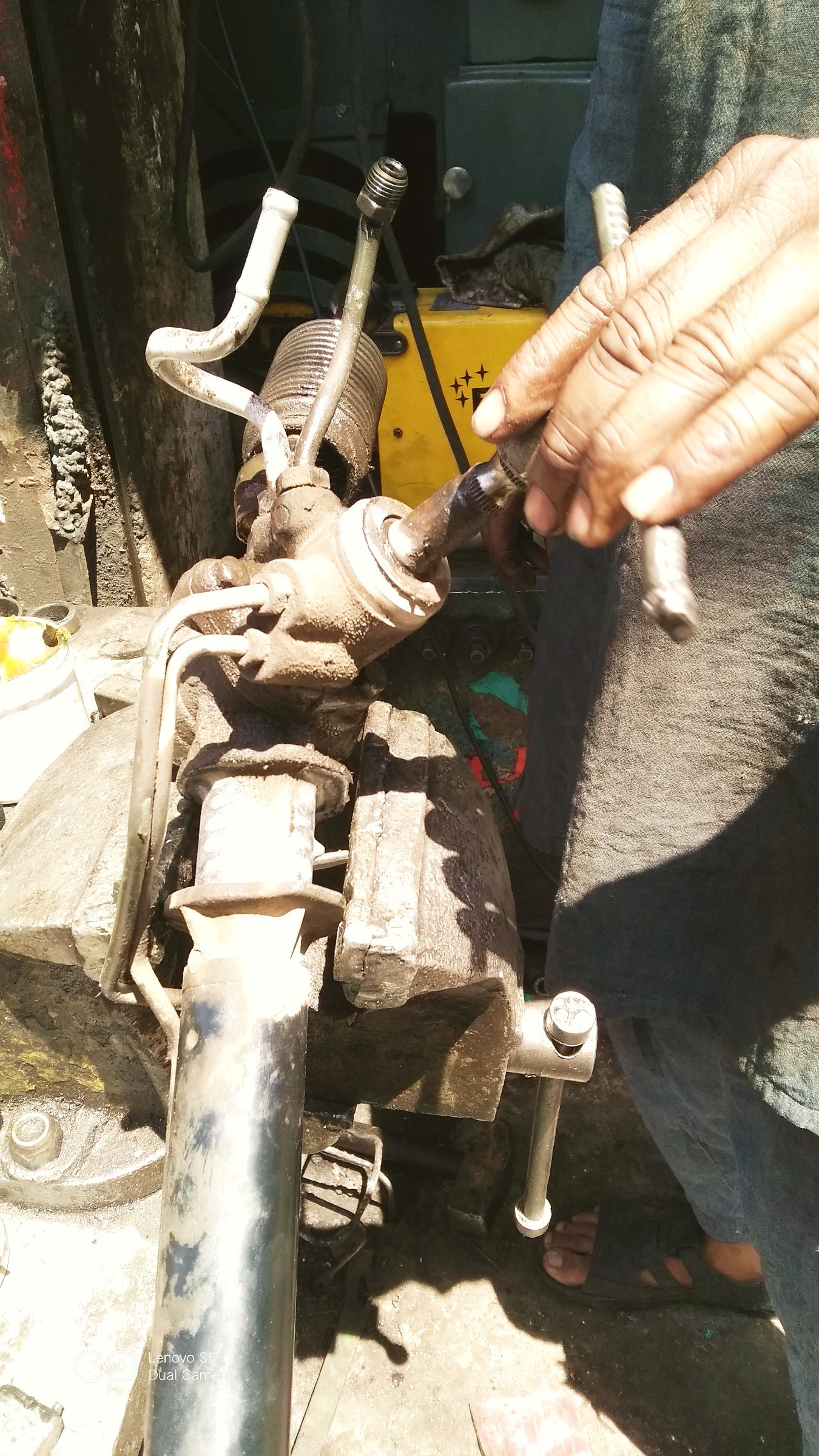

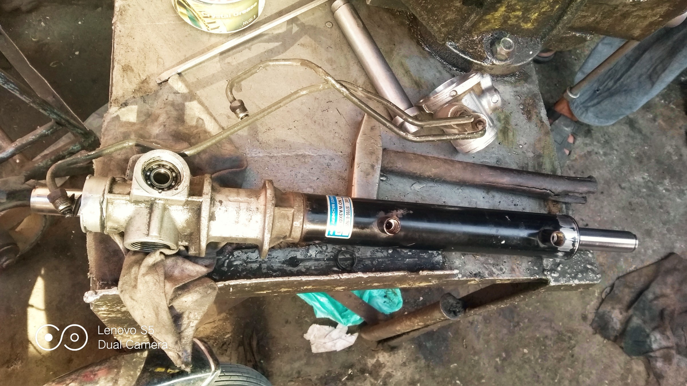

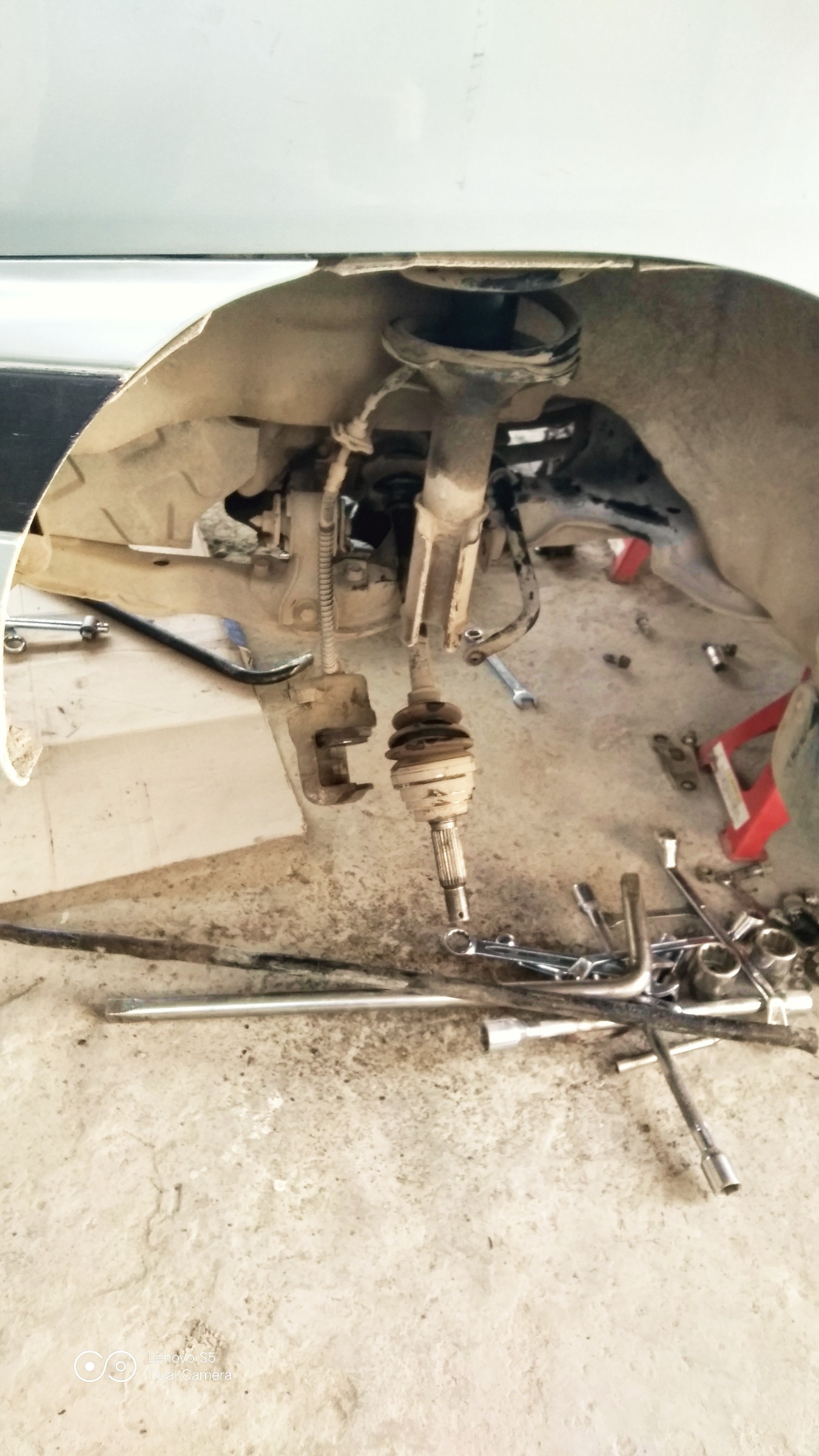

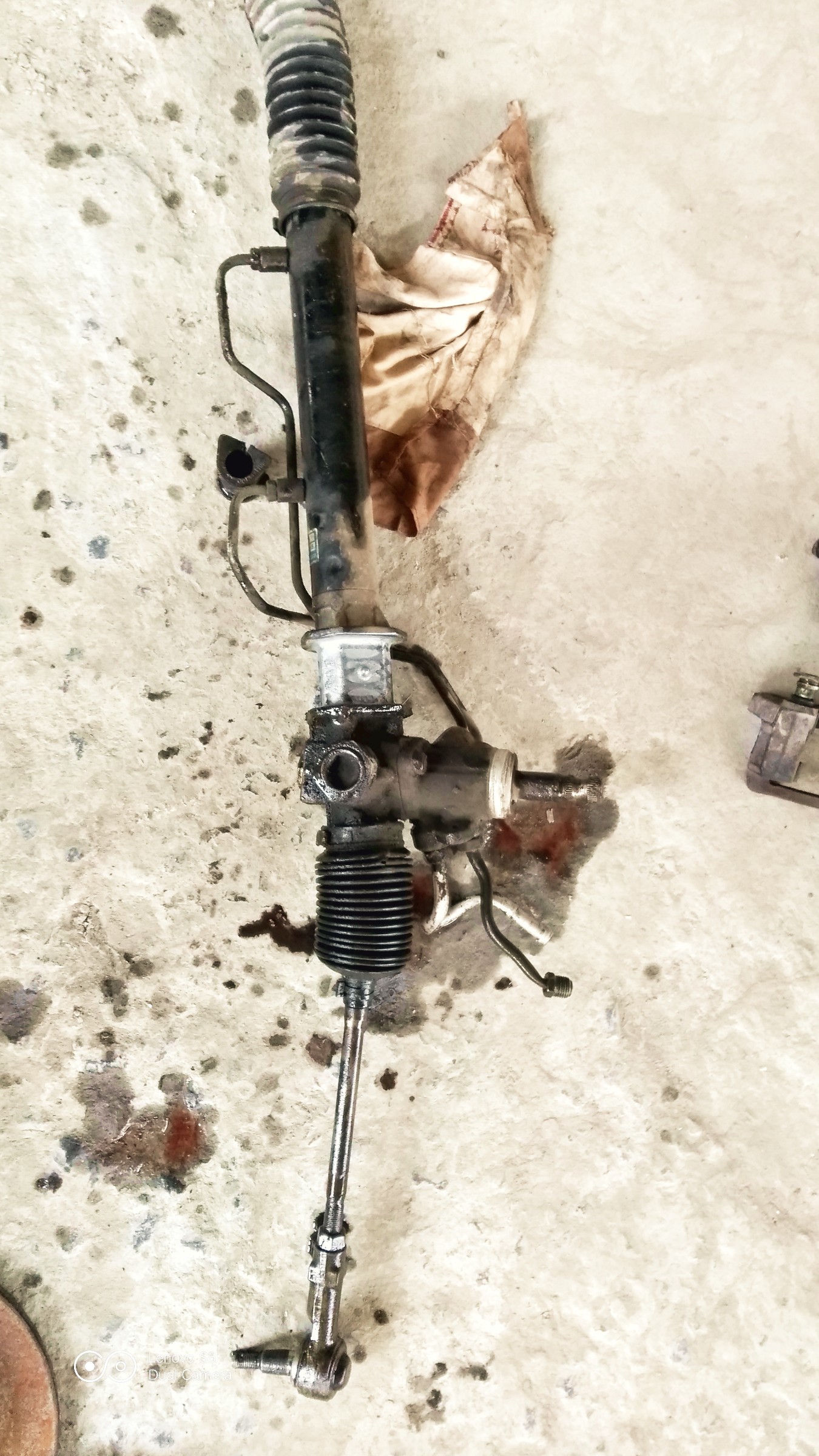

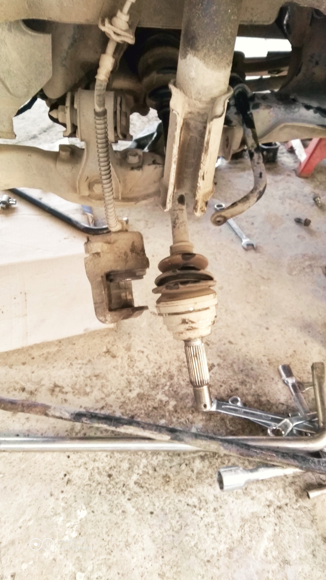

Got Complete Hydraulic Power Steering Rack Overhauled on 28May 2020. Workshop AutoHub IJP Road Islamabad

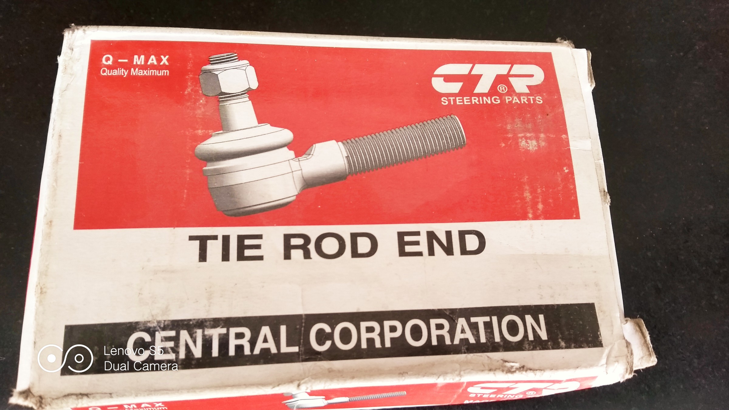

1- New Tie Rod ends ( CTR China)2- New Rack ends ( CTR China) 3- Complete Overhauling of Power steering Rack with new Oil seals(Korean) and Rod polishing by the Machinist4- New Control Arm Smaller & Bigger Bushes China)5- New Stabilizer Bar Bushes ( Sikka China)6- New Hydraulic Power steering oil ATF DXIII ( Kixx Korea)

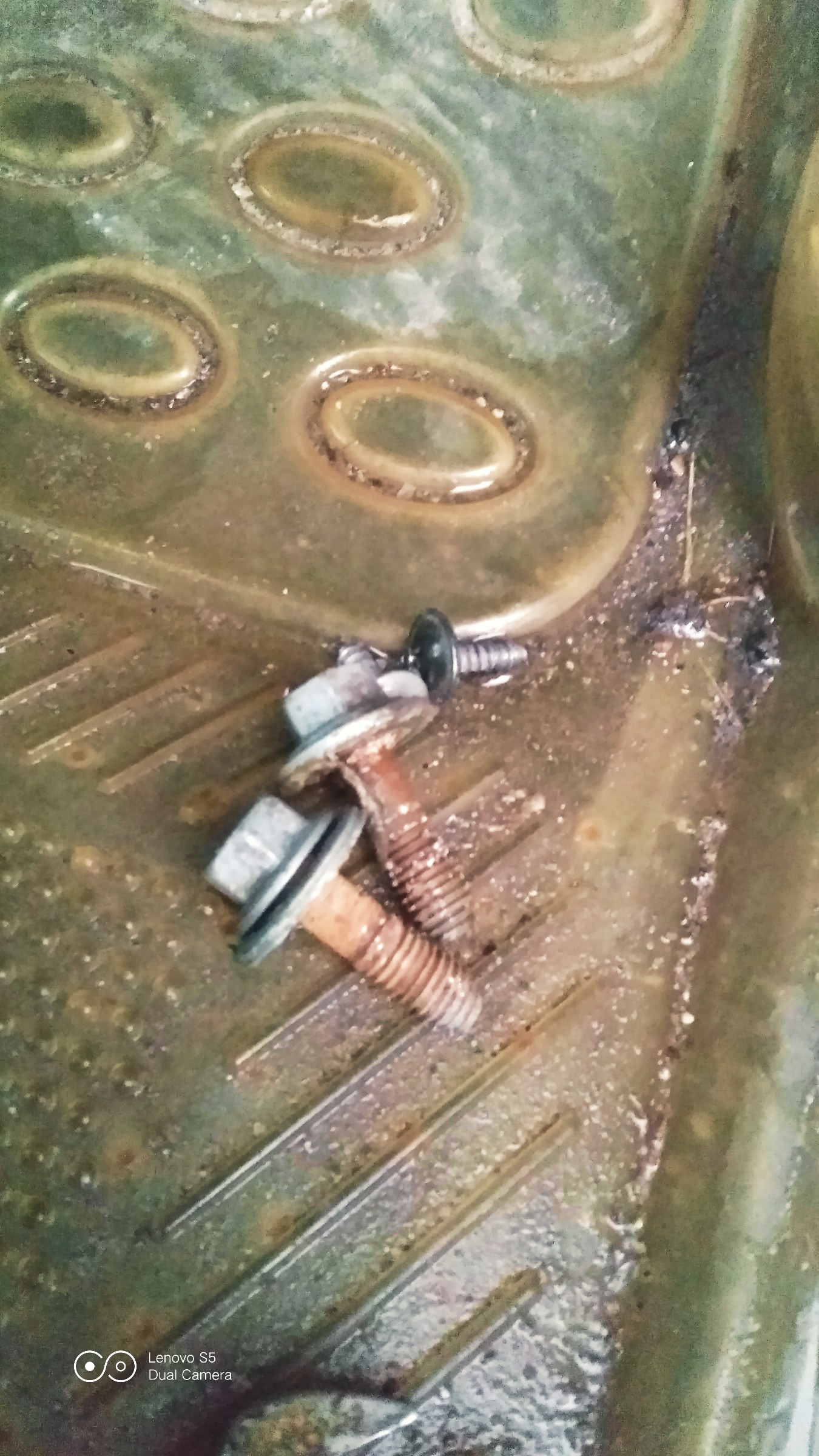

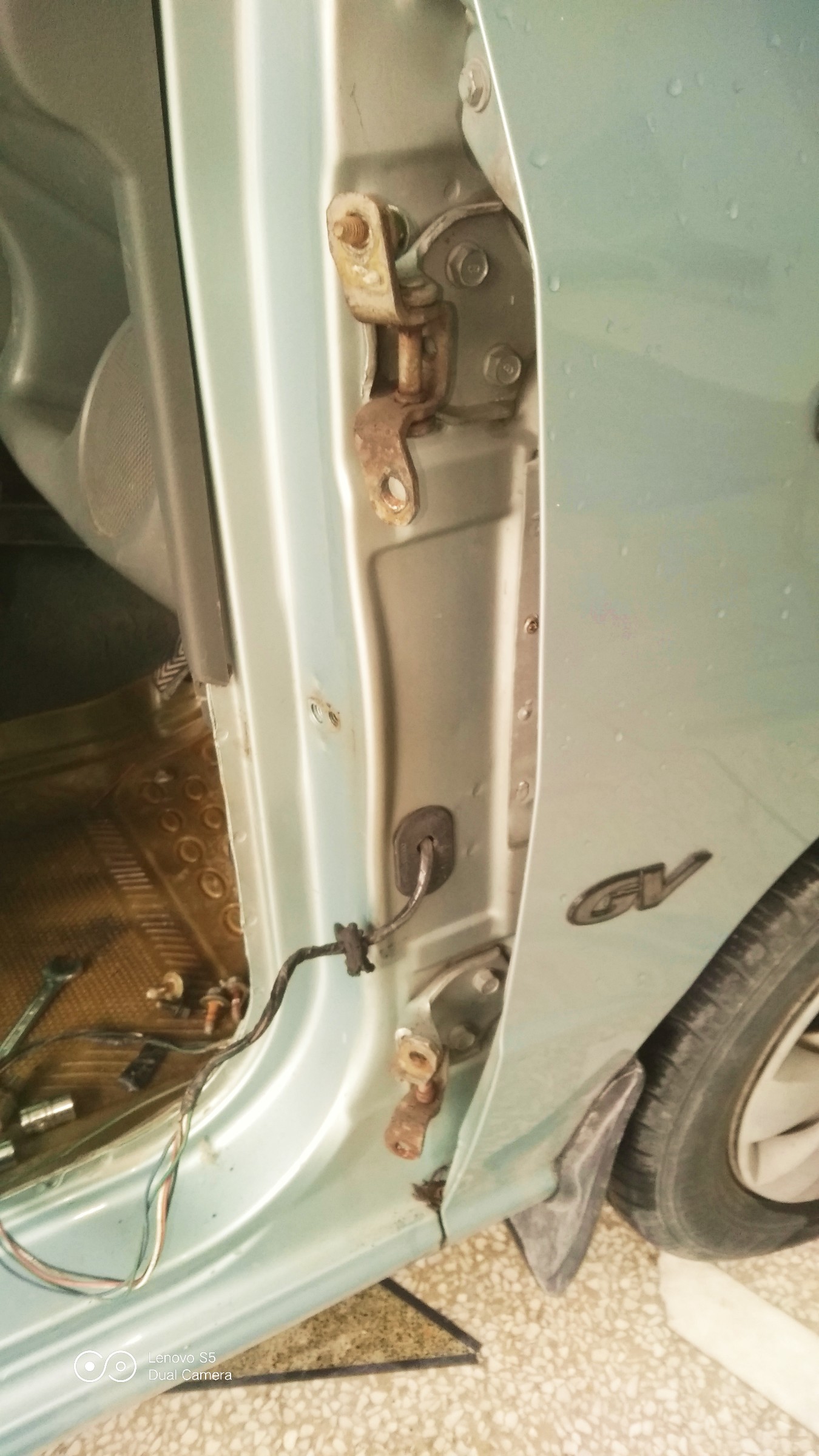

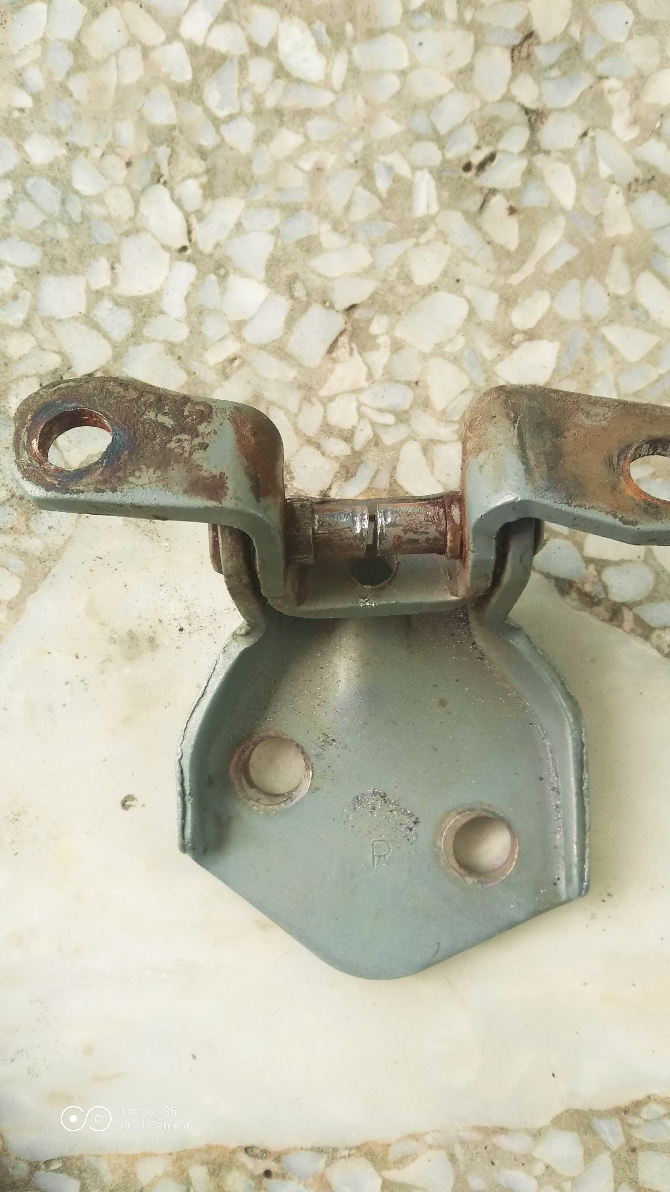

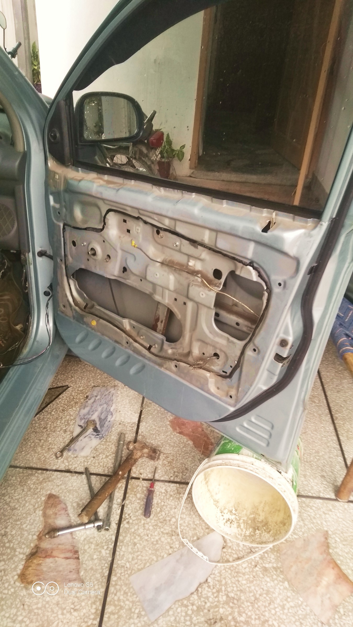

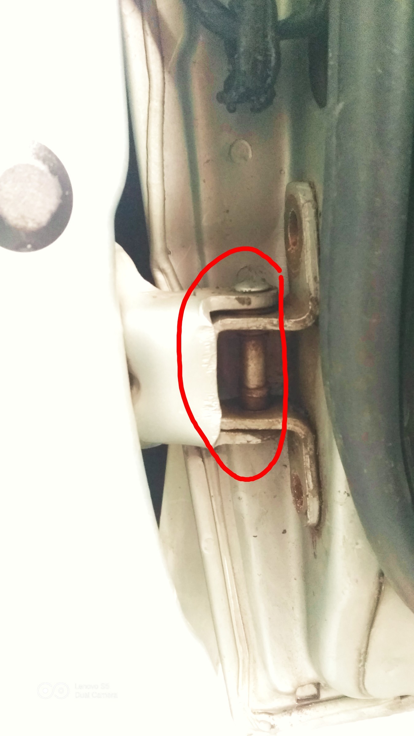

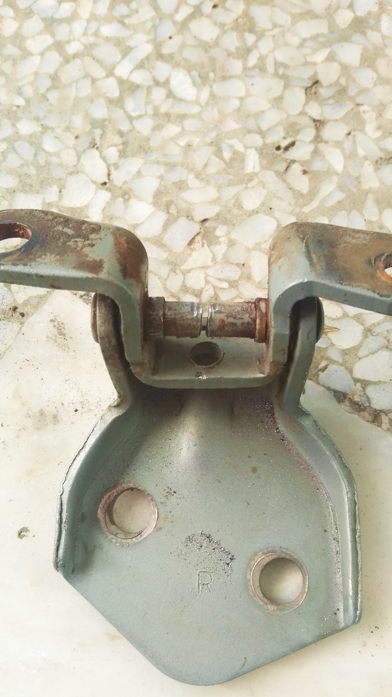

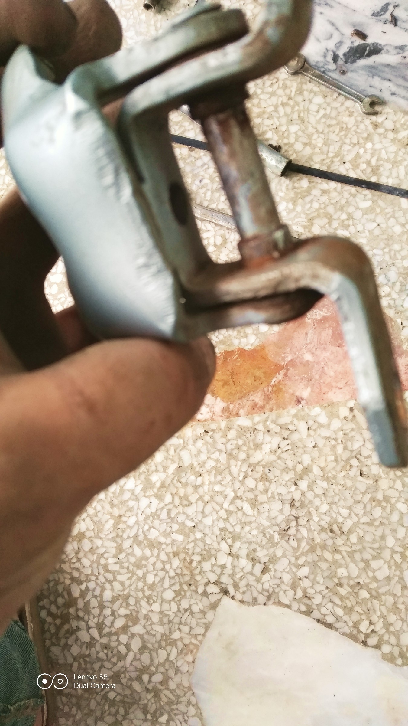

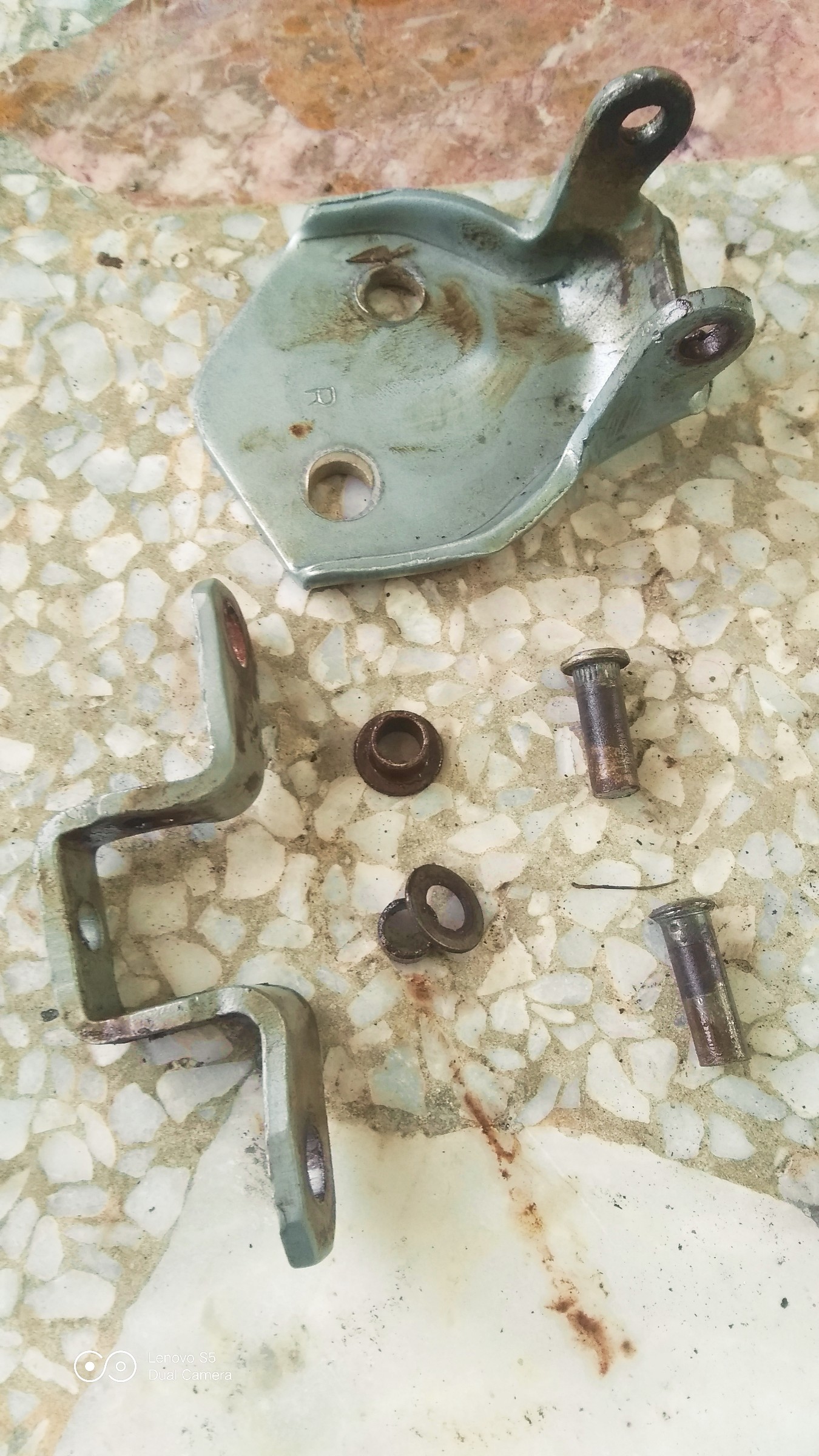

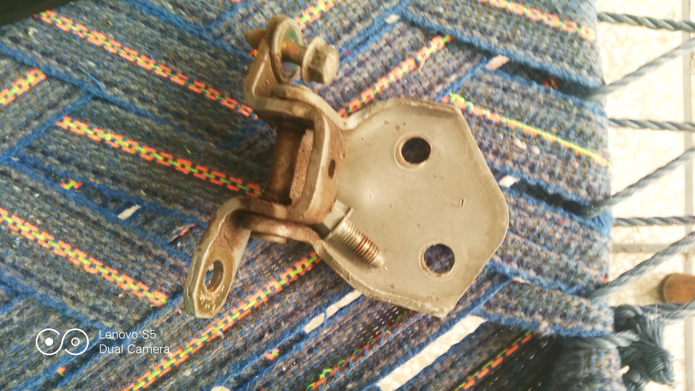

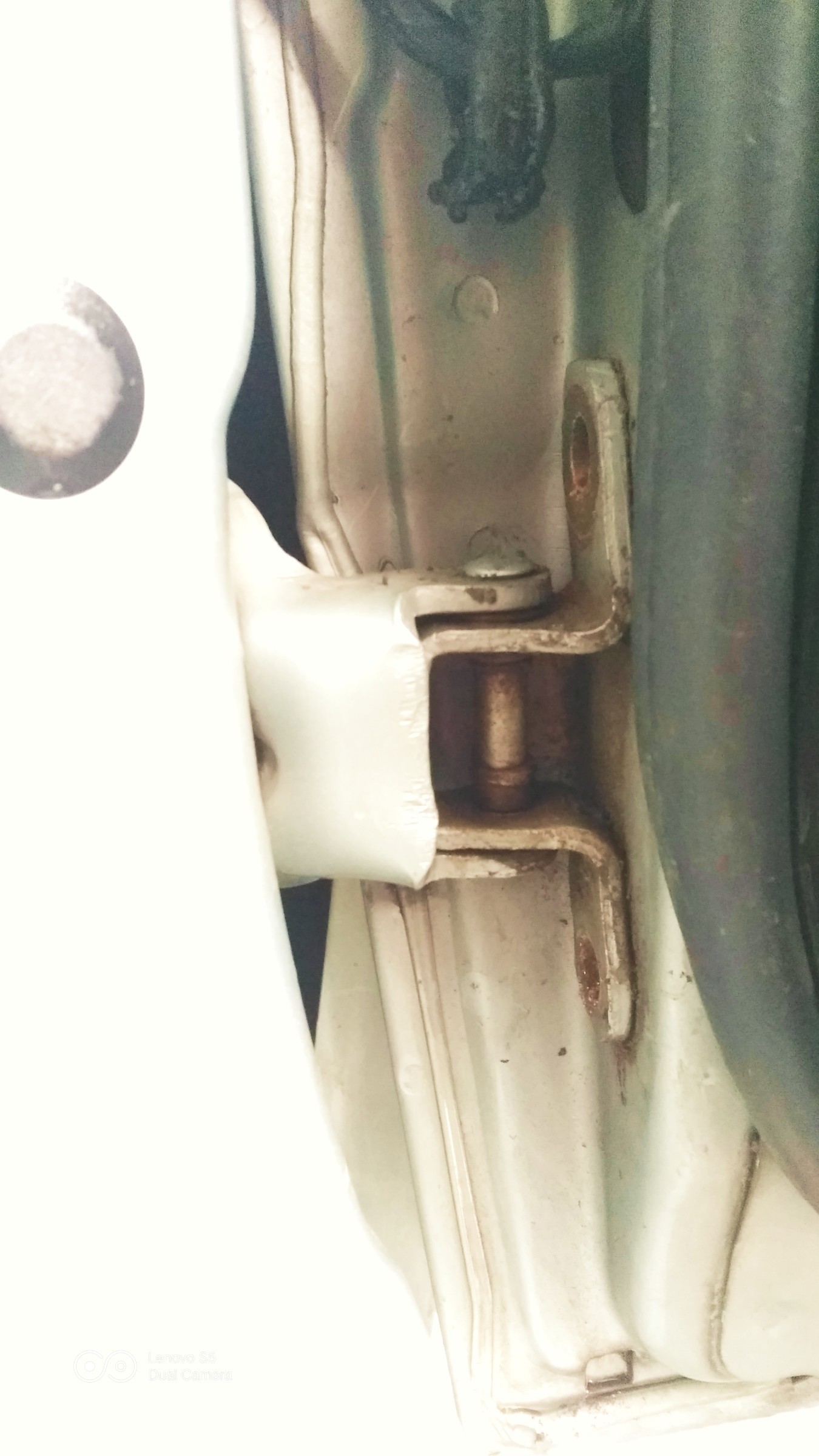

Today performed DIY santro front door hinge pin reworking. Had broken brass bush of the pin due to which door was giving noise,and had play.
