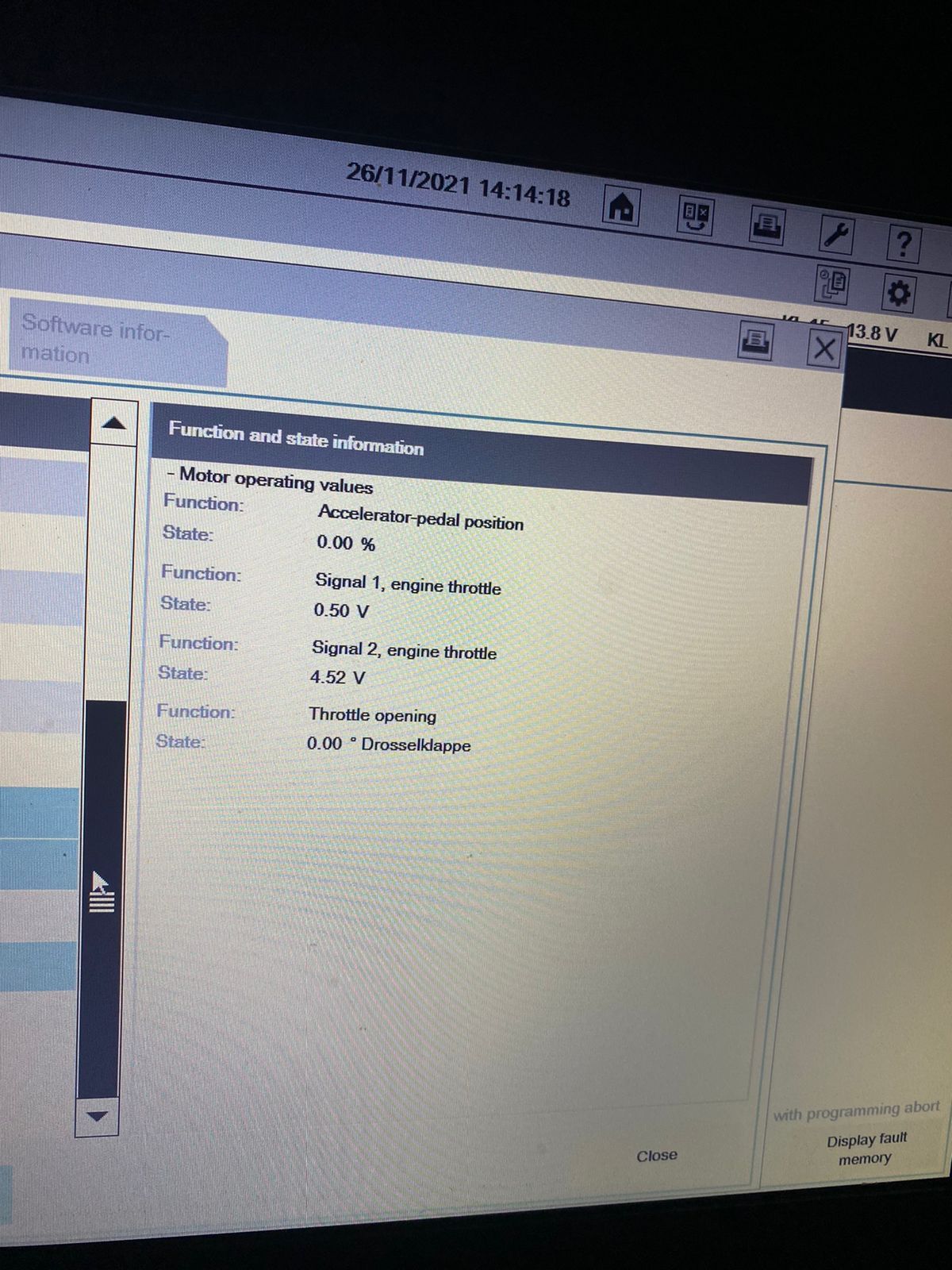

You are pretty mistaken if you are assuming this engine relies on its throttle body to control rpm or even has an IACV. The throttle is wide open 10 to 20 seconds after startup and the rpm is controlled by the valvetronic lift only. The throttle body is for backup when the valvetronic shuts down due to error.
