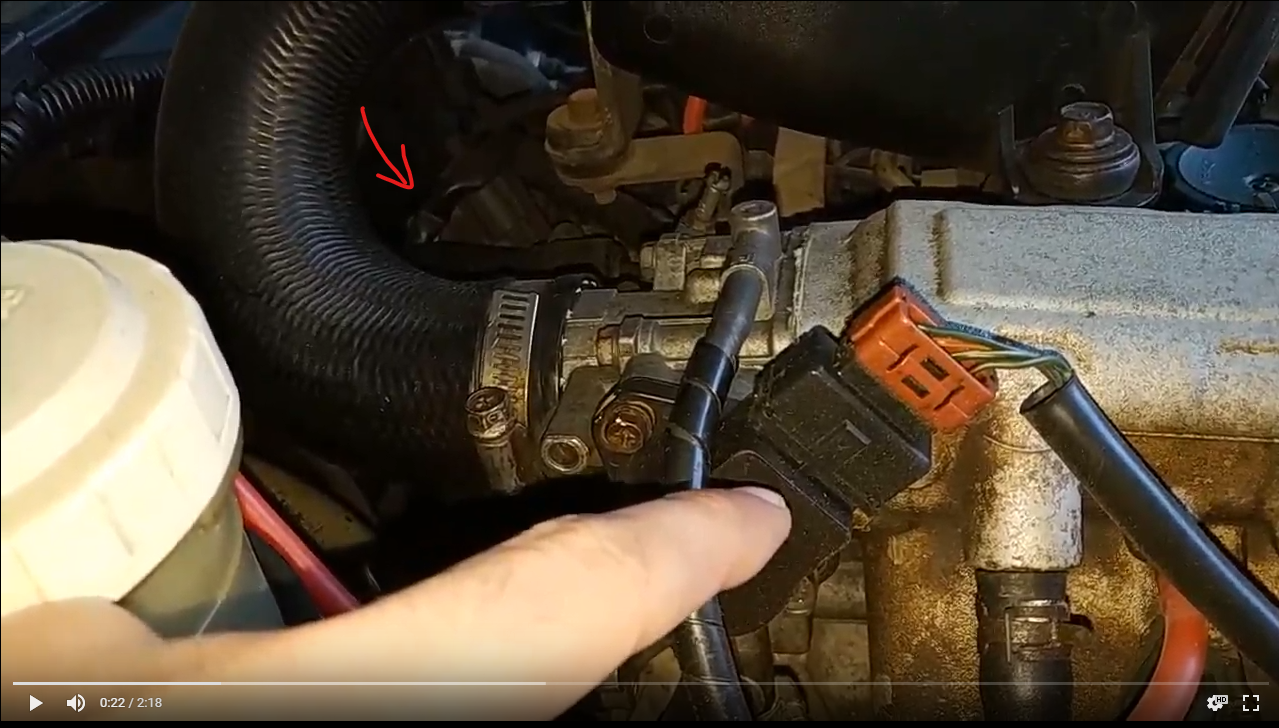

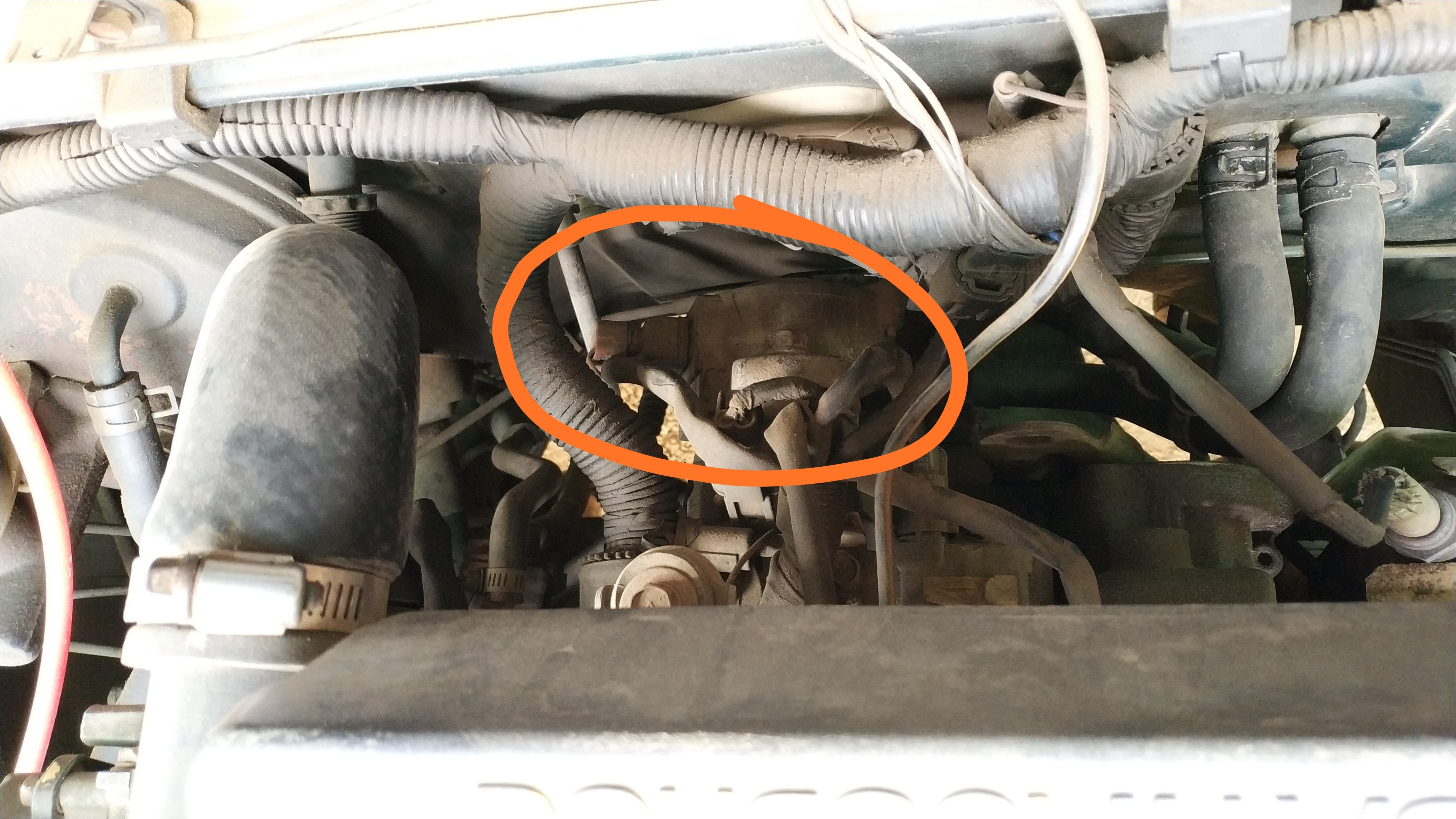

Distributor is located at rear of engine, just look over from top of intercooler. Follow these arrows,
You will find a component mounted at rear side of engine with a 12mm bolt and wire connector on it, and this bolt mount have space for rotation once bolt is loosened a bit. CCW = Advance, CW = Retard.

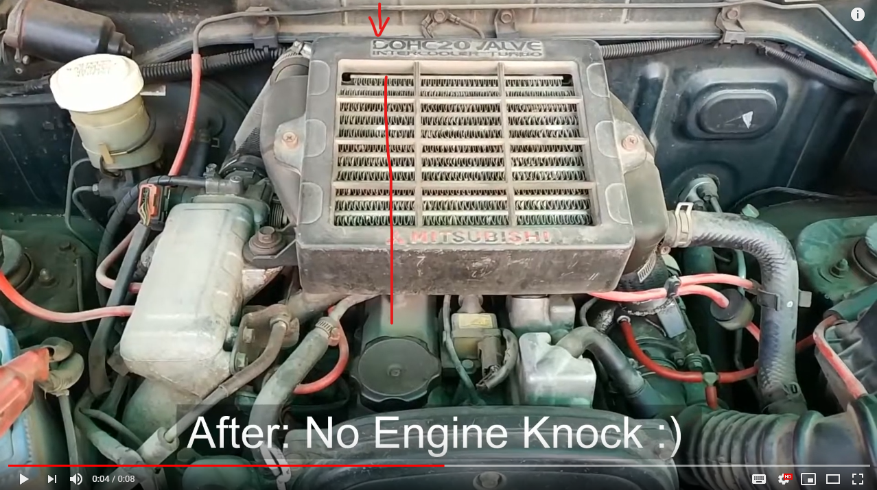

Do mark current position or take a photo with phone. Make small changes, like 1mm or 2mm max.
