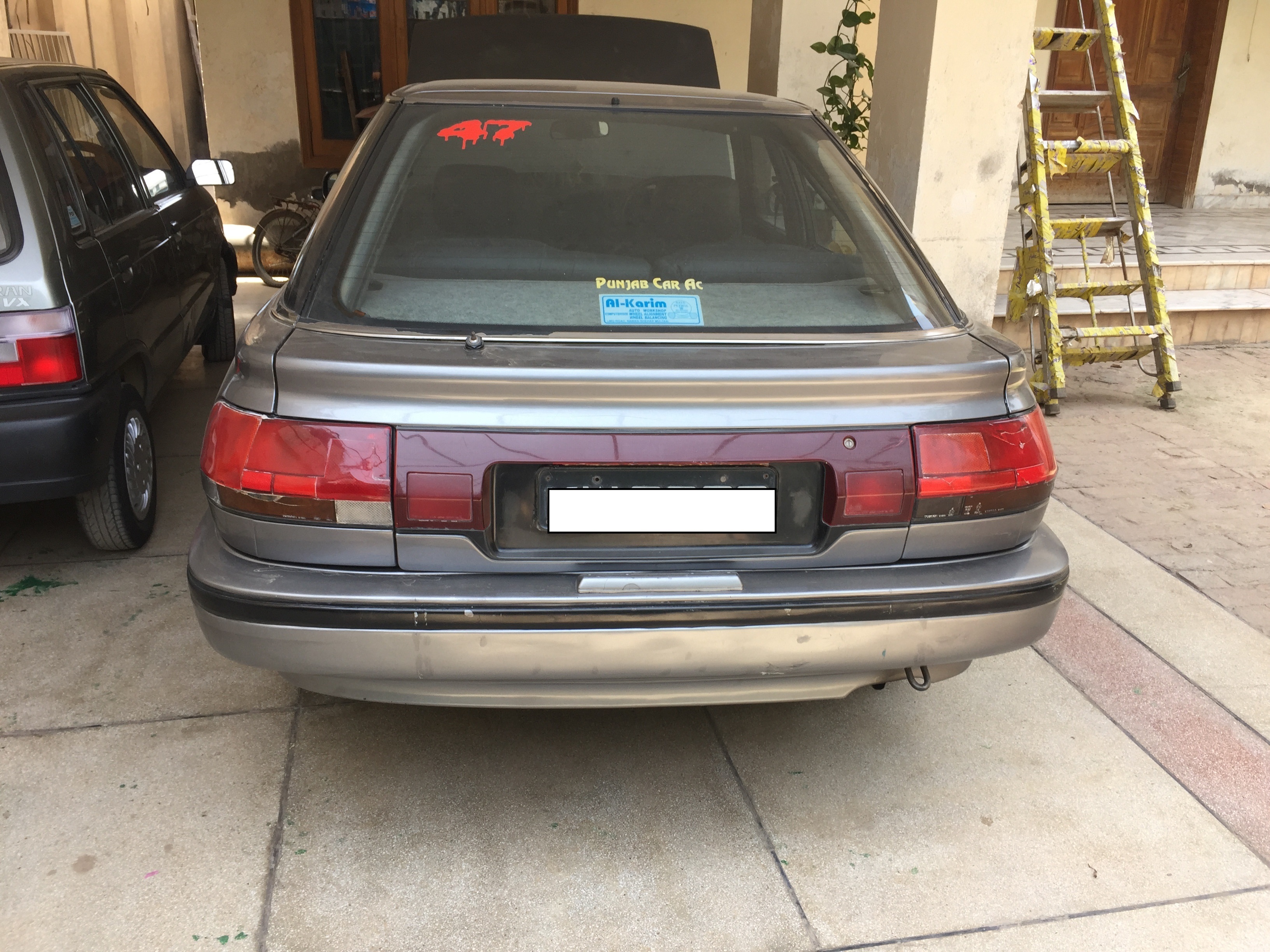

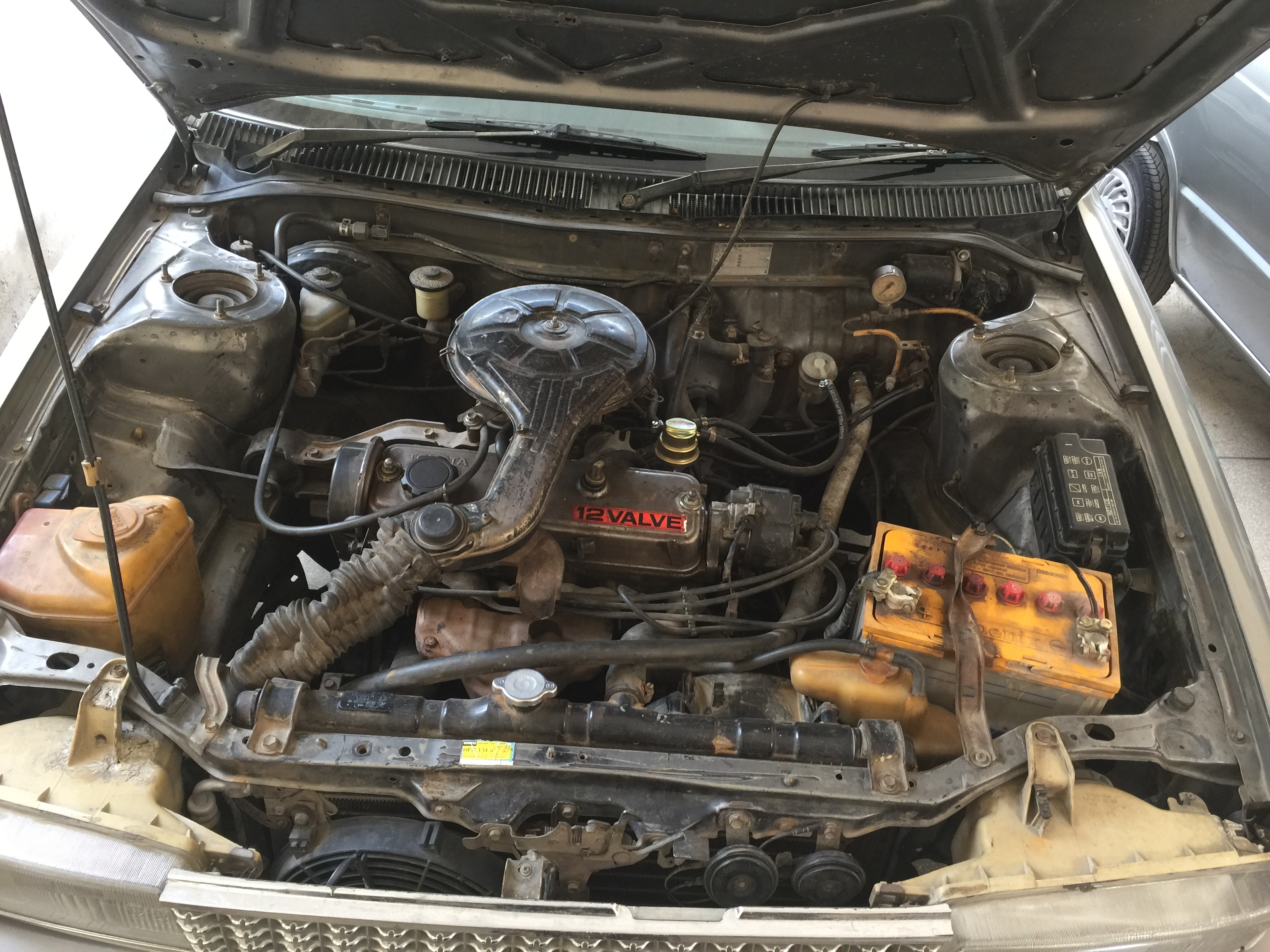

I really like this car (belongs to my uncle) I want to upgrade its suspension, air intake and wiring, Please guide me. I am a car enthusiast at a beginner level. this is 1990 European E90 Toyota Corolla Liftback>
see this topic https://www.pakwheels.com/forums/t/finaly-5afe-swapped-in-ee90/144812

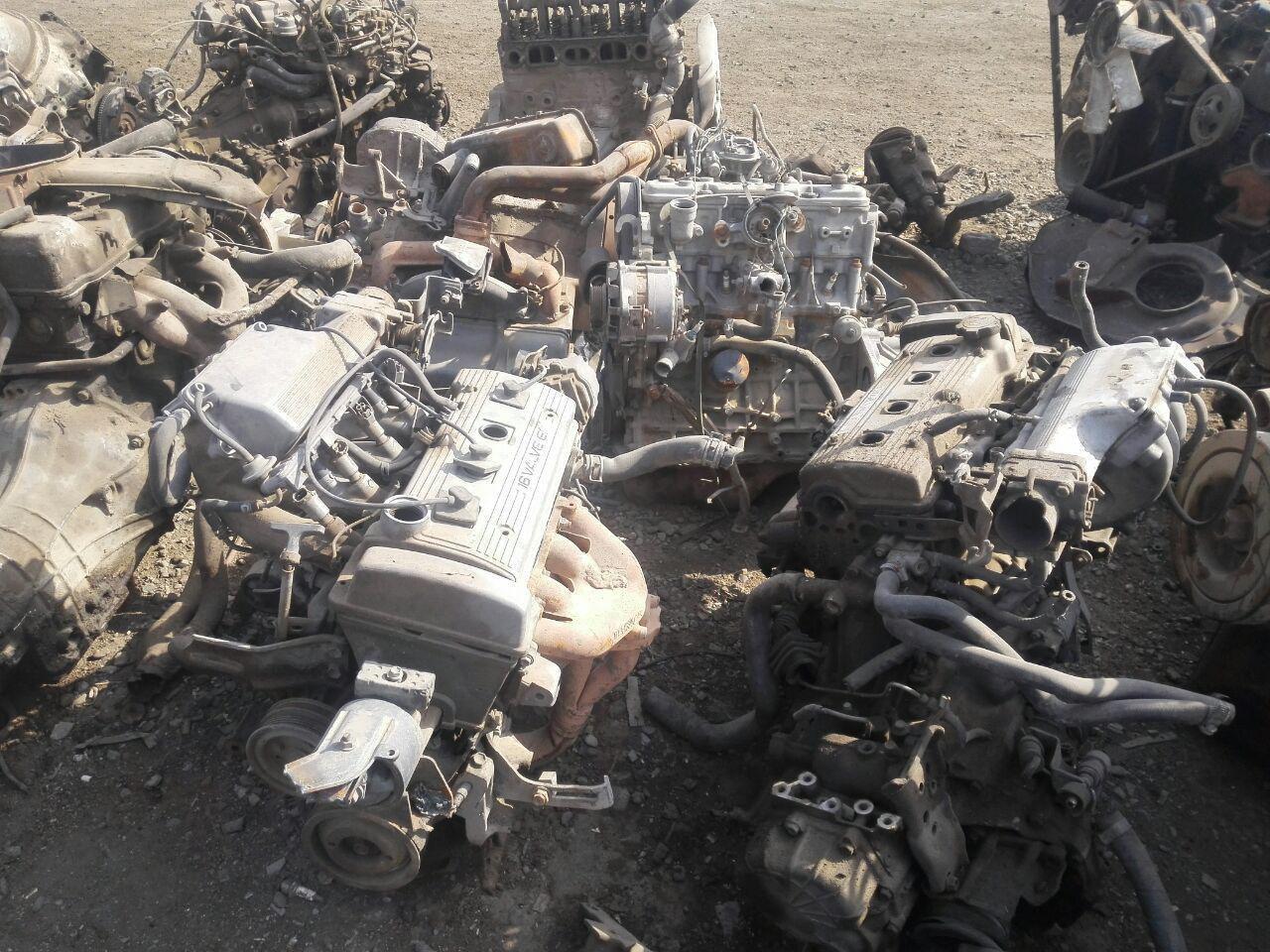

buy 3 motors corolla 4afe 1994 with 600$ in iran very good
I dont beleive the belt will. Unless u find an industrial market that has cog belts. The 4a carby engine had square cut teeth on the belt.
hello zulfiqar i want install engine 1994 i buy 3 engine

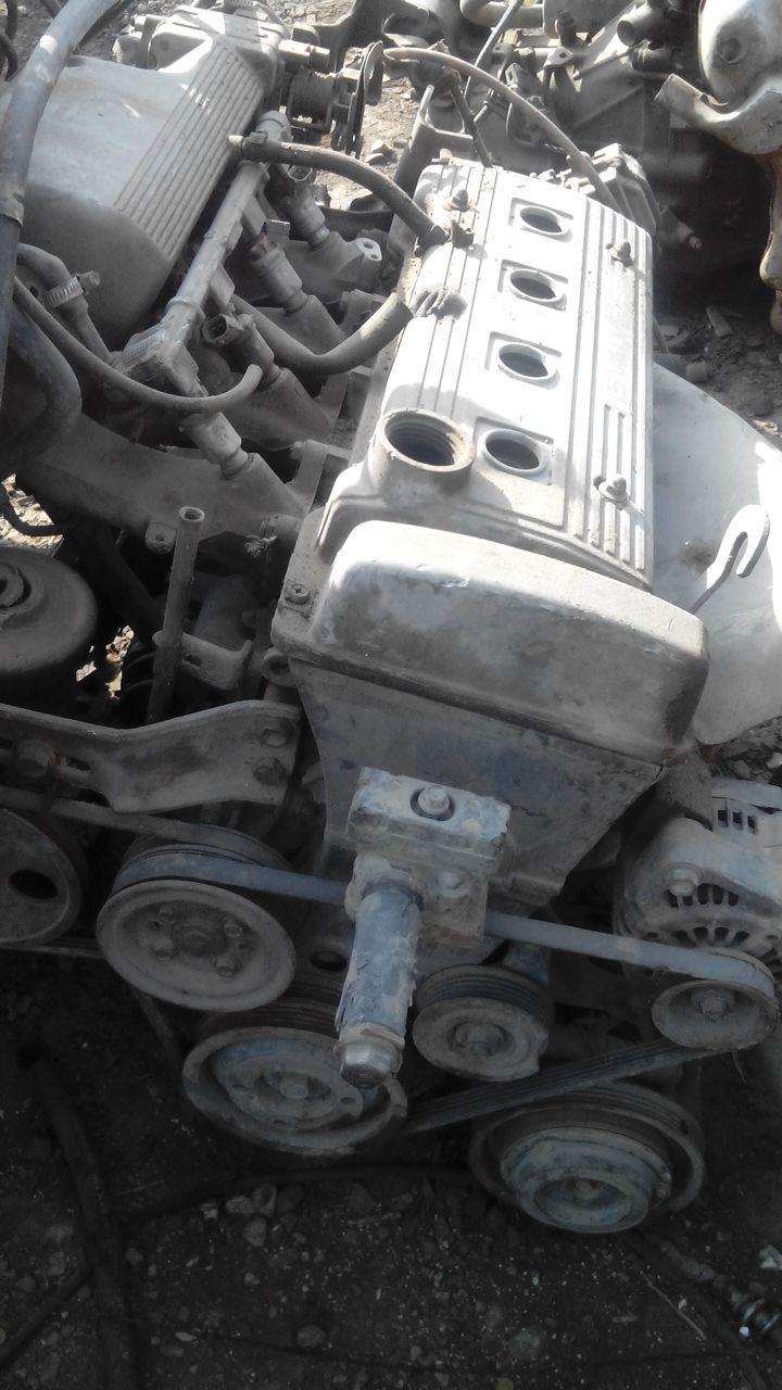

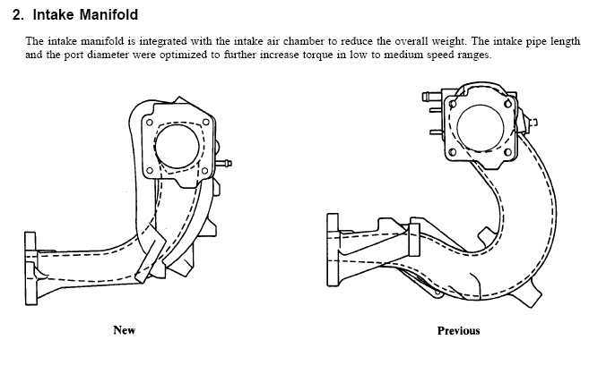

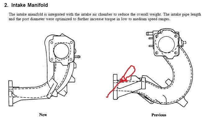

Hello. Timing is correct? Means you installed 4AF head on 4afe?There's not much difference. Compression is same and the cam lobes angles. Major difference is intake manifold shapes.
Why using carburetor? Cams of head you installed are Ok?Pulley is different i think. As last generations got different cam profile
Hi.i need your help...Im trying to put 4afe head on 4af block, to make it electronic fuel injection. I would like to know what also is necessary to complete my conversion? Can you give me your WhatsApp number?
