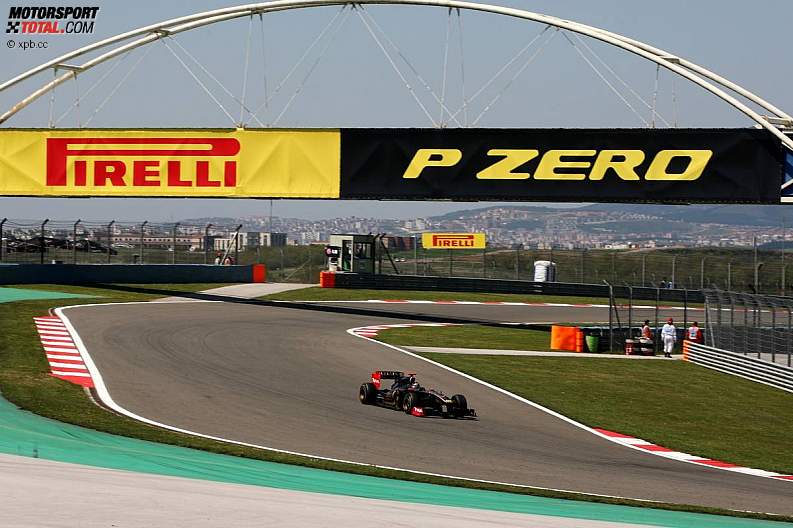

Although the Turkish Grand Prix is a relatively new addition to the calendar, its Turn 8 has already found an entry into Formula 1 folklore as one of the best corners of the season.
The high-speed triple apex turn challenges cars, drivers and tyres to the limits - and will once again be a focus of attention at Istanbul this weekend thanks to Pirelli's first event at the venue.
