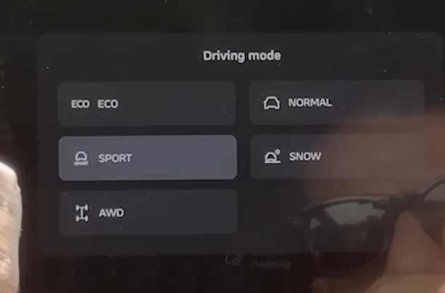

Yes, this is what I meant when I said you can force it to be in AWD mode. Saw similar option in another Hi4 based car though I don't remember which was that (probably Tank 300 or 500).
