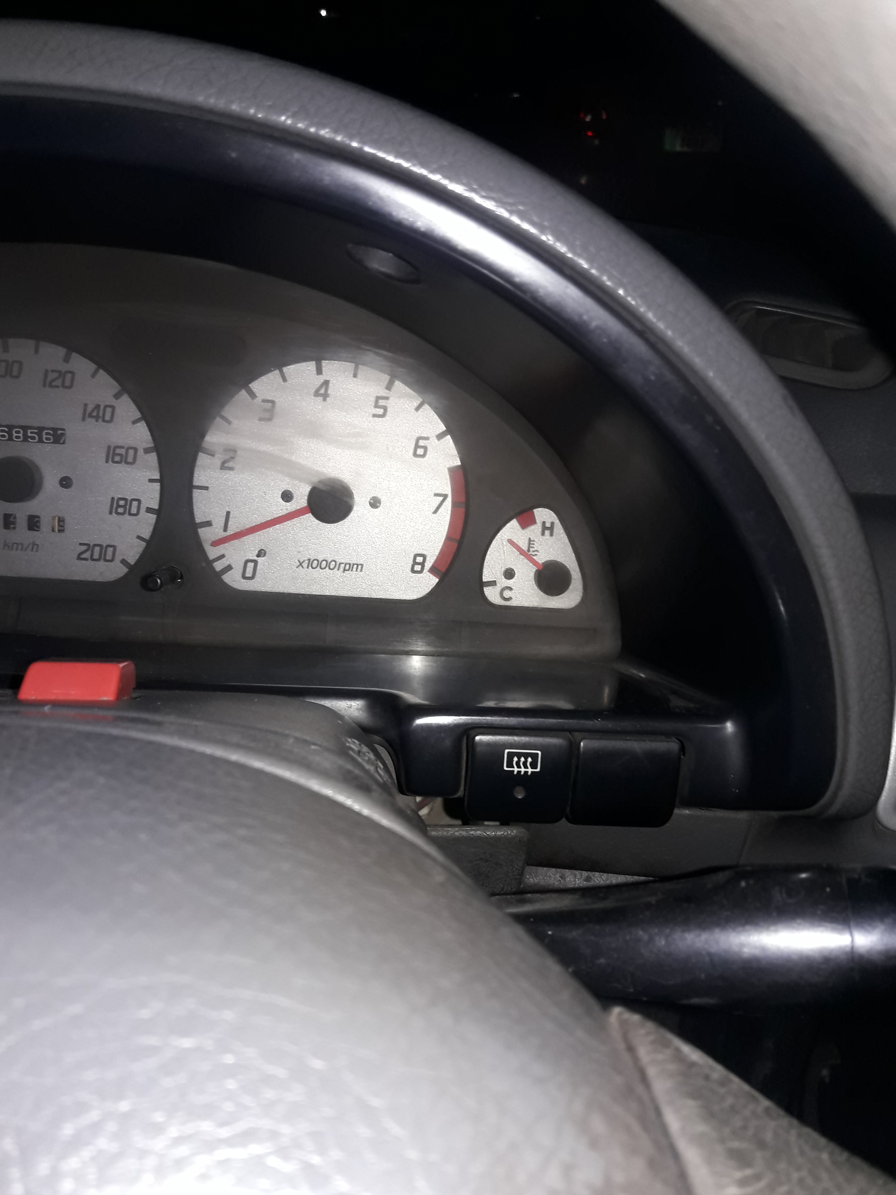

My 98 rolla still has auto fan with thermostat valve and Alhamdulillah sealed engine
Sent from my GT-I9105 using PW Forums mobile app
i think its littel high,,,,,,and can make problem for you in comming summer season,,,,,,,,
Check the bubbles in radiator if u see bubbles in the rradiator then ur car gaskit is weak that is why he mechanic have removed thr thermostat valve as with weak gaskit and TV car will build pressure and burst hosepipe
Is T/Valve (new) availble any shop in plaza? I asked few shopkeeper they denied.
Looking at the gauge this seems to be the normal operating temperature. If it goes any higher then you have overheating problems. If it stays lower than this, then check the radiator fan to make sure it turns off when the temperature needle reaches the centre of the gauge. If the radiator fan is running all the time, it means that the automatic switch has been bypassed Get it fixed. If car takes too long to reach the normal operating temperature, it can be because the thermostat valve is bad or has been removed. Test and replace if necessary.
Make sure radiator is filled with 50:50 mixture of coolant and distilled water. If the coolant you buy is already pre-mixed with water, then simply pour coolant in the radiator without diluting with water. Buy good quality coolant and not cheap green water. Check with Suzuki dealership for recommended coolant or buy Caletx, ZIC, Liquimoly brand coolant.
its ok, i have new cultus just done 3500km. Needle is always in middle never goes up & down.
This is very normal ... With Fan auto its perfect operating temperature ... But in hot summers with AC on .. direct fan is better helps your engine stay cool ... And with direct fan the temperature guage will be around 30 - 35% ...
My fan is auto and my fan starts when needle a bit up from middile plz tell me what to do
