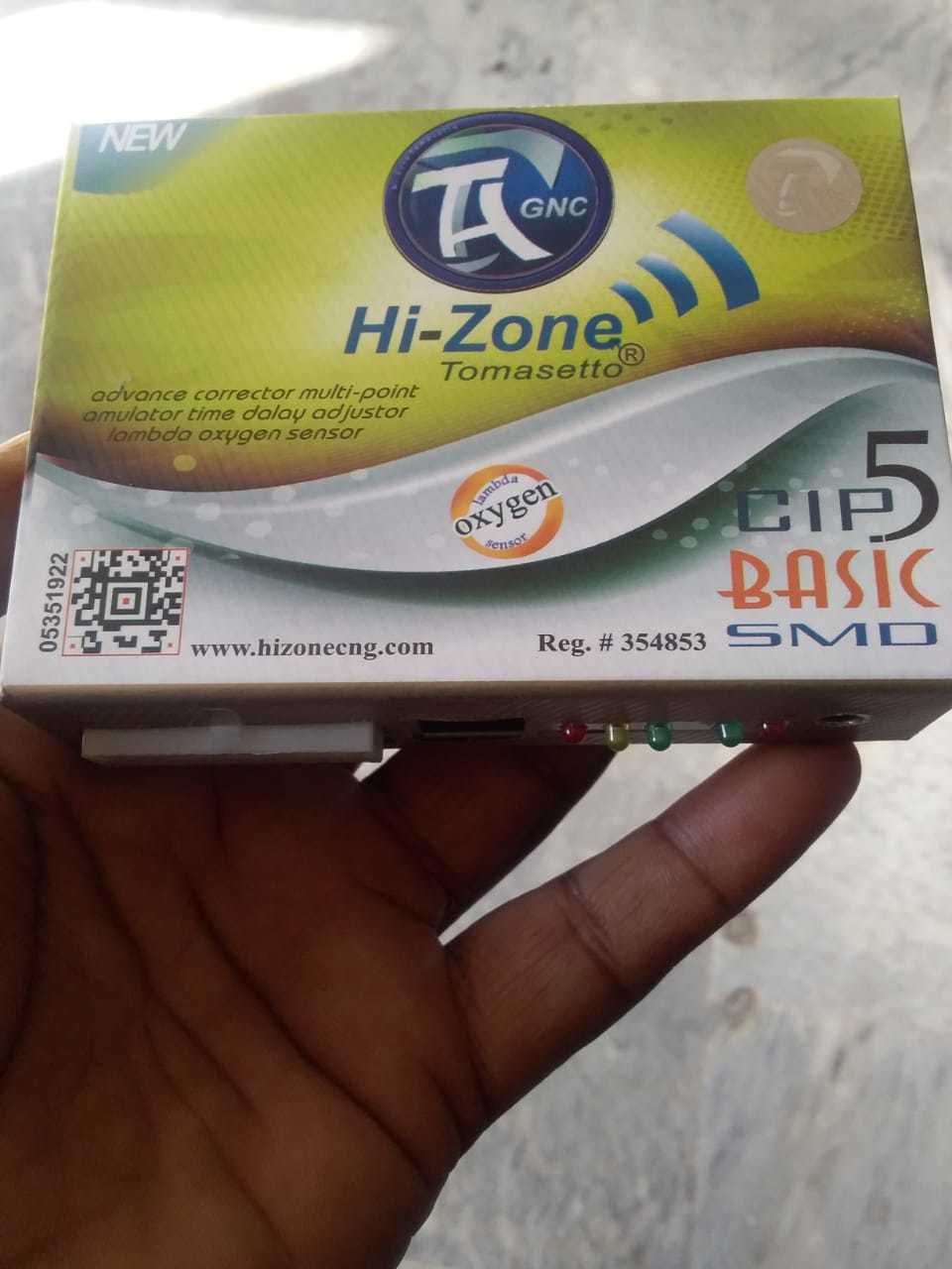

btw the hizone cng one is china import as per venfor...but tge color code of wiring and actuall is not matching. Also it has only 2 pair of wires(1 for map, 1 for tps) apart from 1 pair power supply(total 3 pair + 4 pair of injector emulator. this lead to 8+6=14 1 core wires in the 16 point terminal grip...lamda wiring missing...the label says so
the advancer red/green pair is woring with accelerator...want to explore of i can connect atleast oxygen sensor for the 3 leds to show tuning status ;red, yellow& green, only green is on permenantly (need to confirm but i think it green)
