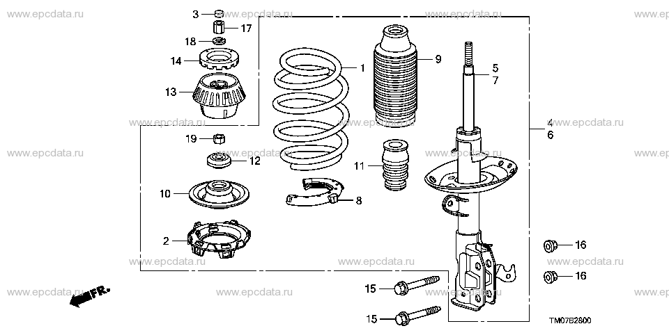

You can get this OEM, for the front struts.
Everything within the enclosed line is already pre-assembled and new - the different rubber parts, brackets and bearing. Makes DIY much simpler.
Part numbers:
51610-TM0-T022
51620-TM0-T022
Cost is around rs33,000 (pair) plus another 2400 (pair) for part 13 rubber genuine inner mount. KYB would cost around 15-16k for a pair but only the shock part.
