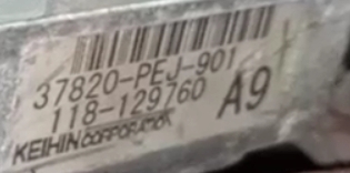

Engine : D15BECU
This is D15B non vtec automatic ecu.
Does it mean it's right ECU for this engine ?
auto and manual were different, but still your case is different. you have to check the wiring and connectors first.
Yes his engine is also non vtec d15b so he got correct ecu with the engine. Now only he needs to check for the codes and maybe correct wiring to solve the issue

exactly what engine do you have that has the ECU cost of 18k?
i bought a PKDM D15 manual engine ECU for Rs 3.5k from mardan / olx
This is jdm d15b non vtec. Not the PKDM exi D15.
Yes it's D15B
