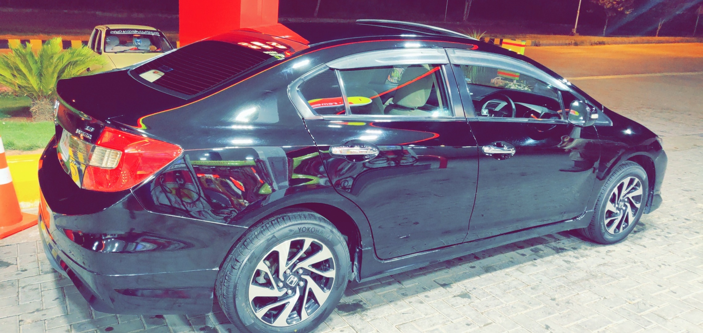

Are these 16" Rims? If yes, what are the Tyre's specs? I heard if you move from genuine Rim & Tyre specs, you have to compromise over comfort and mileage. Is that so?
Yes, These are 16' OEMs from from Civic X. Tyres are yokos bluearth 215/55. In islamabad, I get 11.5-13 in city fuel avg. 13 on high-octane
And any words about comfort? Does it increase or decrease?
To be honest, I feel civic to be struggling on bumps and on khadday wali roads as compare to my vitz. Vitz had smoother suspension without any doubt. Car seems makhan on good roads especially after new tyres.
It had 15' OEM rims and eurostar installed before. After installing yokos, it surely increased my comfort and drive smoothness. But I miss my Vitz 1.3 in terms of suspension
bro ek tou vo Toyota hai, opper se Japanese... kya bat krte ho! My dad has Toyota Fielder, he sometimes does not even bother to apply brake on small speed breakers
Yehi cheez hai. The only PKDM I had before this civic was mehran, a decade ago. I had 2 vitz. 1st gen 1.0 and 2nd gen 1.3 and dono ki suspension was kamaal. No offense to civic, I love my ride lekin ghatya road se guzarte huay dil karta hai kisi premio,axio wale k sath exchange kar lon
If you drive your car hardly 10k kms a year then fuel average shouldnt be much of an issue, hardly 3/4k worth more petrol would be consumed in either of your rides
