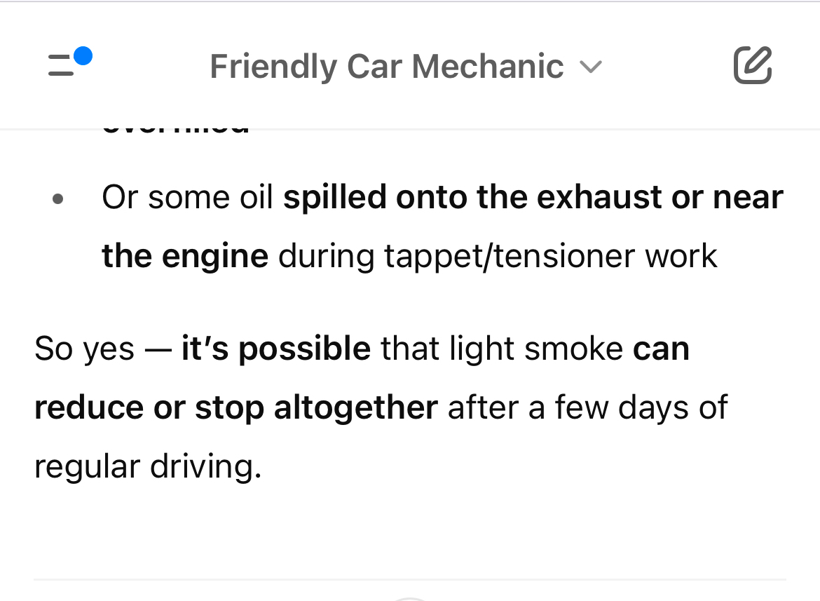

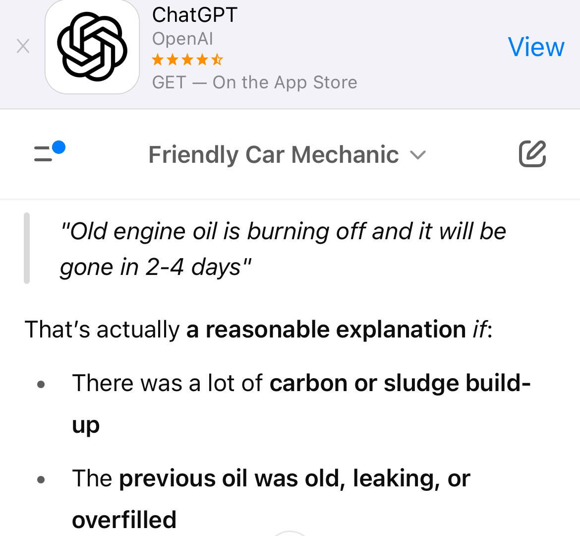

Old engine oil burning off if engine had carbon/oil deposits
Residue in the exhaust system/catalytic converter
Overfilled engine oil (check dipstick — oil level should be between Min & Max)

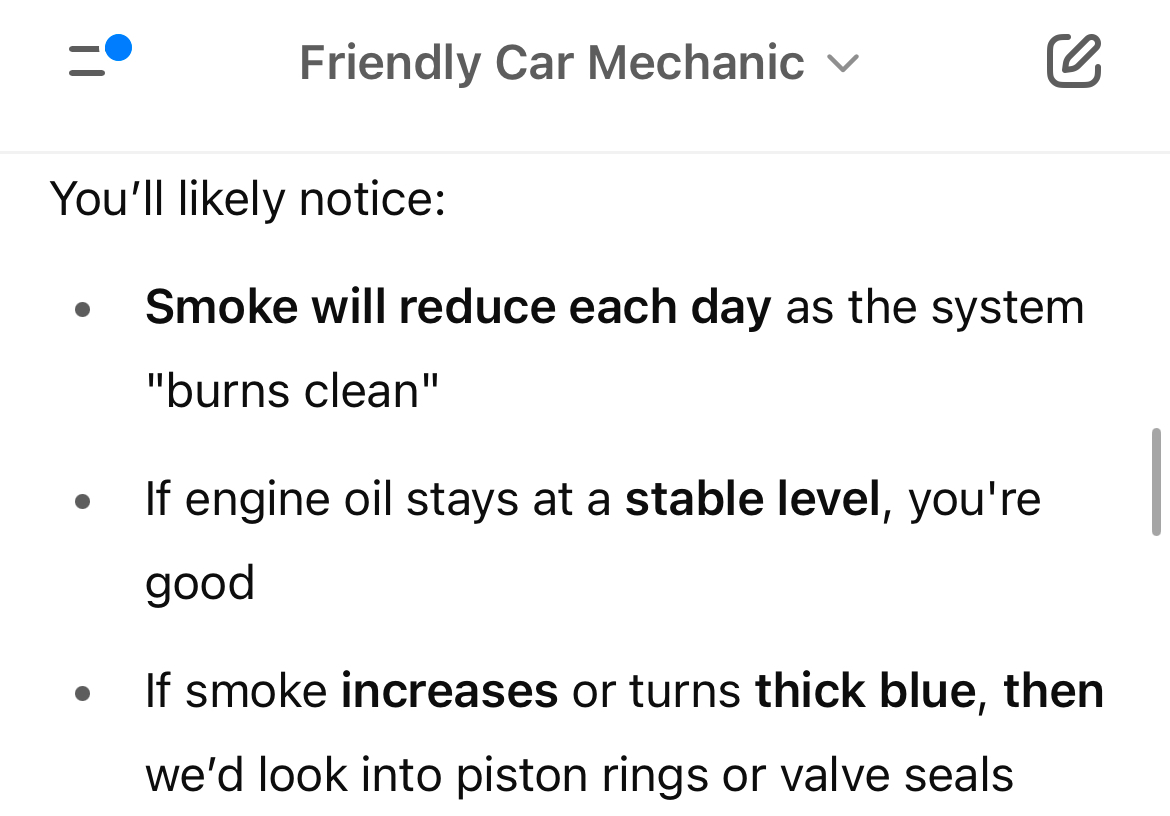

Based on What You Described:
Thin white smoke on acceleration only
No overheating
No coolant loss
Tappets adjusted
No error codes
Weather is hot/humid
