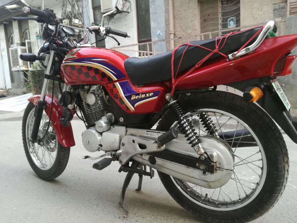

After my tour to deosai on my Deluxe 200, I decide to maintain the engine which was due from the very first day i swapped the engine.
So, with the help of @vickytulla, I got the parts which I needed for the engine maintenance aka overhaul.
So i chose kamran autos, multan road to do this job for me because it is nearby my home and I can have some critical eye on the work.
So the parts which were changed to make the engine brand new were following:
- Rings
- Valves
- Timing Chain
- Some gaskets
Luckily the cylinder and piston were in very good condition so they were used as they were.
After the overhaul, tghe most difficult thing for me was ' Running poori krna'
So mene sirf 50km tk running poori ki and lost my control and started to take it5 pleasure on high speeds. Alhamdilillah, this engine is 10/10 now and smooth as hell.
the only things that are required for its maintenance are tuning and oil change
i am using it as a daily commuter as well as a touring bike. Recently, I went on Pakistan Motor Rally organized by Pakistan Army. That was the only deluxe in the crew because only 150cc and more bikes were allowed. This engine gave edge to me and I participated in the rally.
