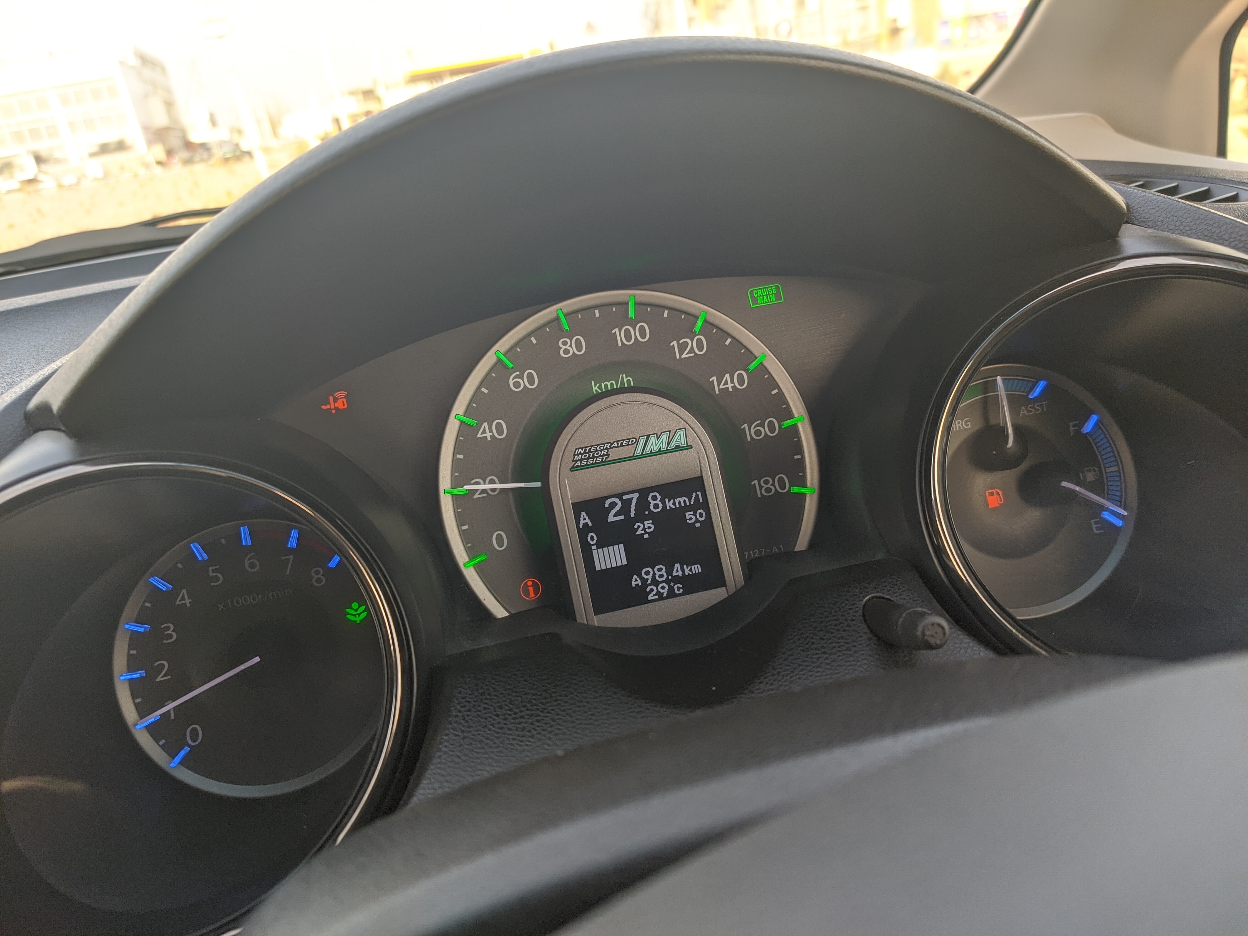

Fuel average best in spring and autumn, when AC and heater not used. Car used in Islamabad and so its fuel consumption may be better compared to cities with busier traffic.
Realistic summer fuel average has been approx 15-16kmpl in summers, the car meter may show 17-18, but I always calculate with fuel top-ups. Winters may be 17ish with heater regular use. And 19 in autumn / spring. Remember car meter always shows upto 2kmpl better than real figure.
Motorway M2 with cruise locked at 110kmph, and occasional push upto 130kmph, it gives 17kmpl in summer 18kmpl in winter, tested 10+ times.
