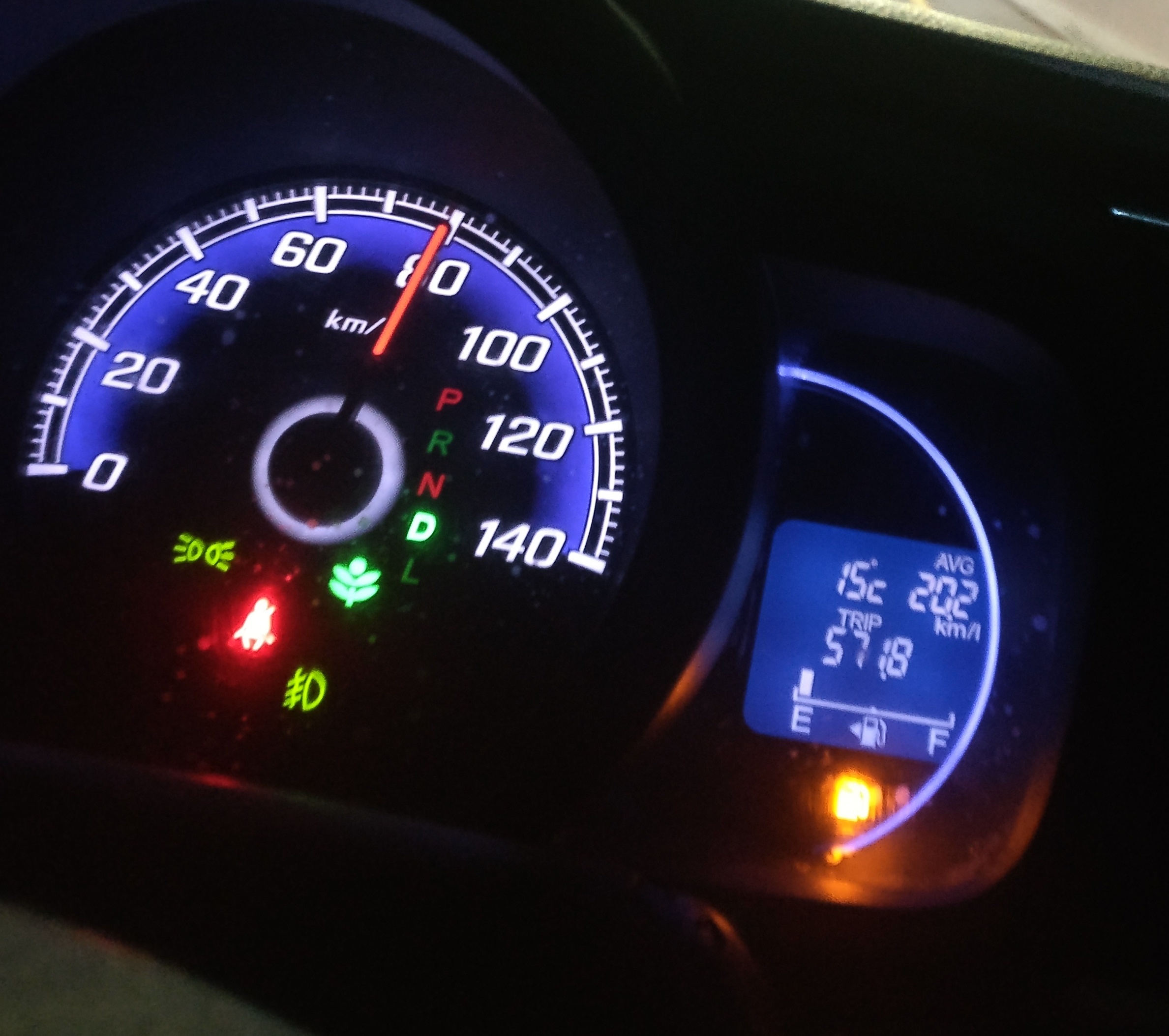

Eco idle has ceased to work for me as well. I blame it on TP calibration since it was working before the cleaning was done. I am looking into this and will let you know the remedy when mine is also rectified.

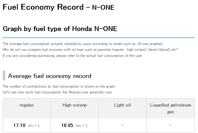

Yes for the bad fuel average, please look into having the carbon cleaning service done it will improve your fuel average by a large margin as well as drive with a light foot.

Also regarding the fuel average, are you following the changing light pattern and trying to keep the peddle in the green zone than the white or blue? (Green is the optimum eco zone).
