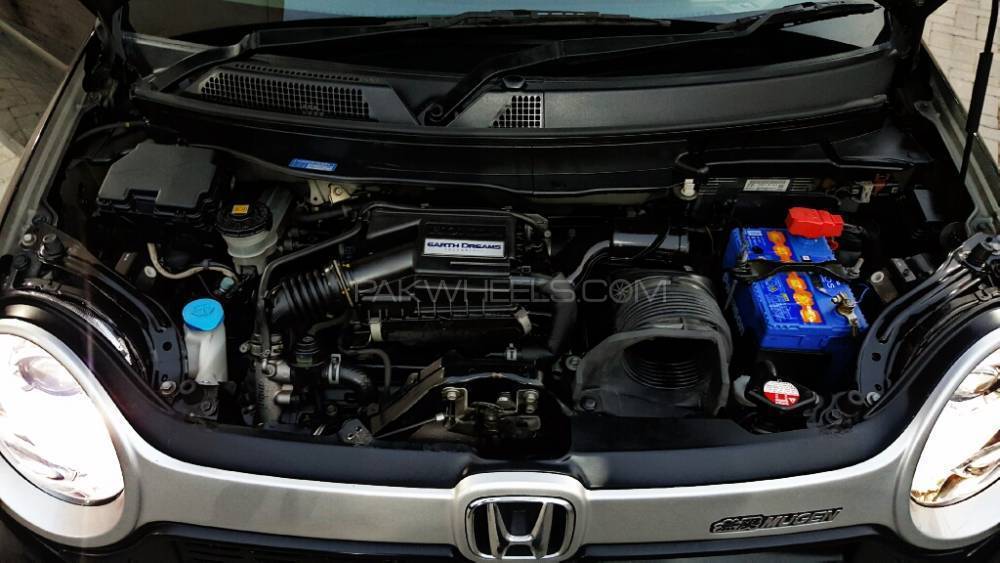

Both stock (G, Premium) and turbo (Tourer/Premium Tourer) variants have the same block which is S07A but turbos having lower compression to compensate for denser air in S07AT packages upto 2015.

^^CHECK YOUR STOCK BATTERY IS M42R WHICH IS NOT AVAILABLE HERE; GET DAEWOO DL46 OR DL50 TO ACTIVATE ECO IDLE AS IT REQUIRES 12.5V ON 5 SUCCESSIVE START/STOPS TO TURN ON INSIDE ECU**

If you depsite this still have no eco idle stop active then check your battery resistance sensor might be faulty or often thrown away by local 'ustaad mechanics'. It is placed on the negative terminal with a grip going to the hood latch.
