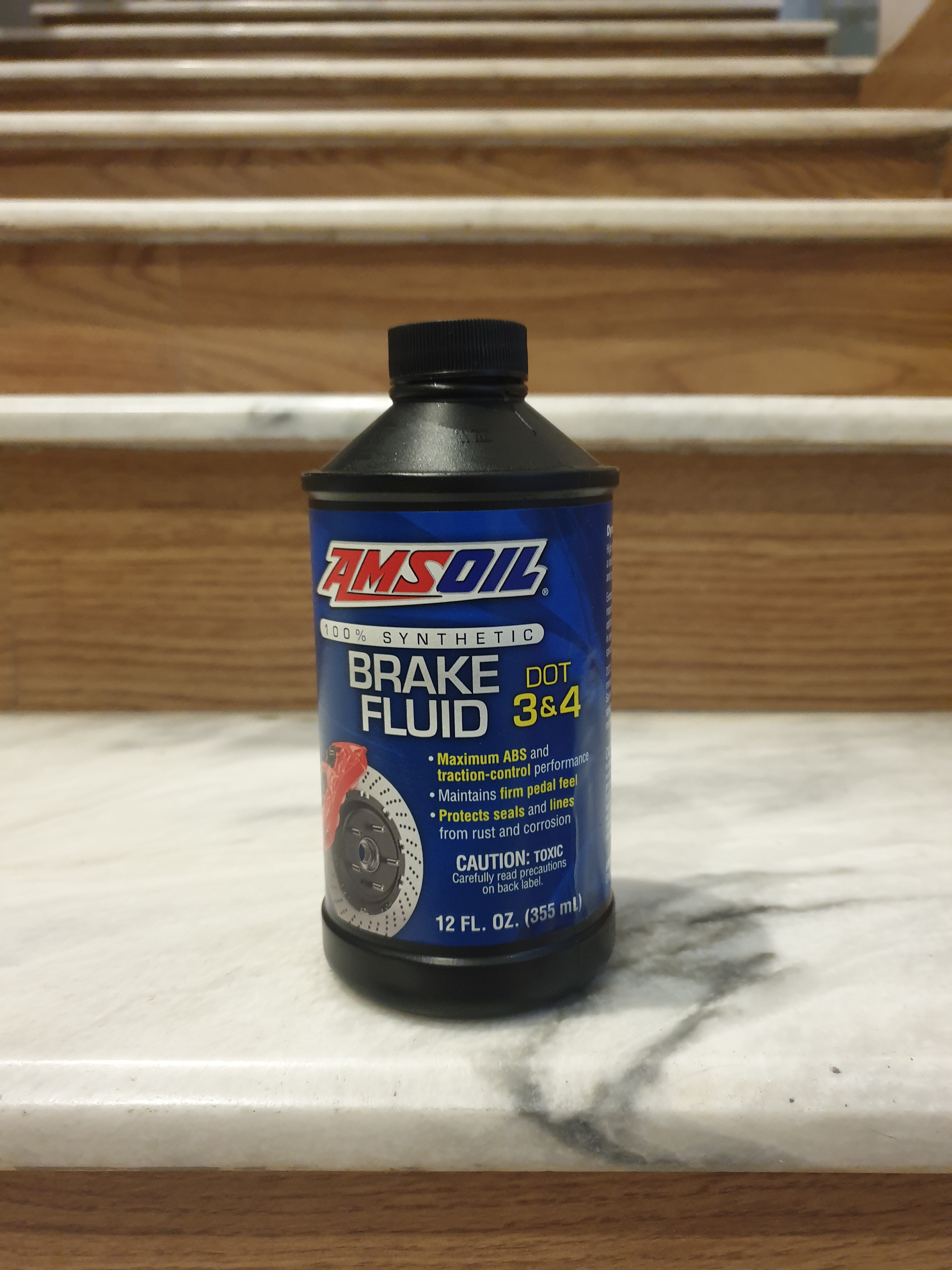

Actuator Fluid was also replaced today @ 40k kms. First replacement ever. Next Replacement @ 50k kms.
Poured Amsoil Dot 4 Brake Fluid. Pic attached.
Guy was insisting not to change so early. But i forced the change.
Had a weird encounter, as i was expecting the Fluid to be clean; "while sucking the oil via syringe, A white sludge was present at the bottom of the container "
Anyways; the residue was mix n taken out maximum as it could be.
After that finally, Amsoil Dot4 was poured approx around
150-200mL.
