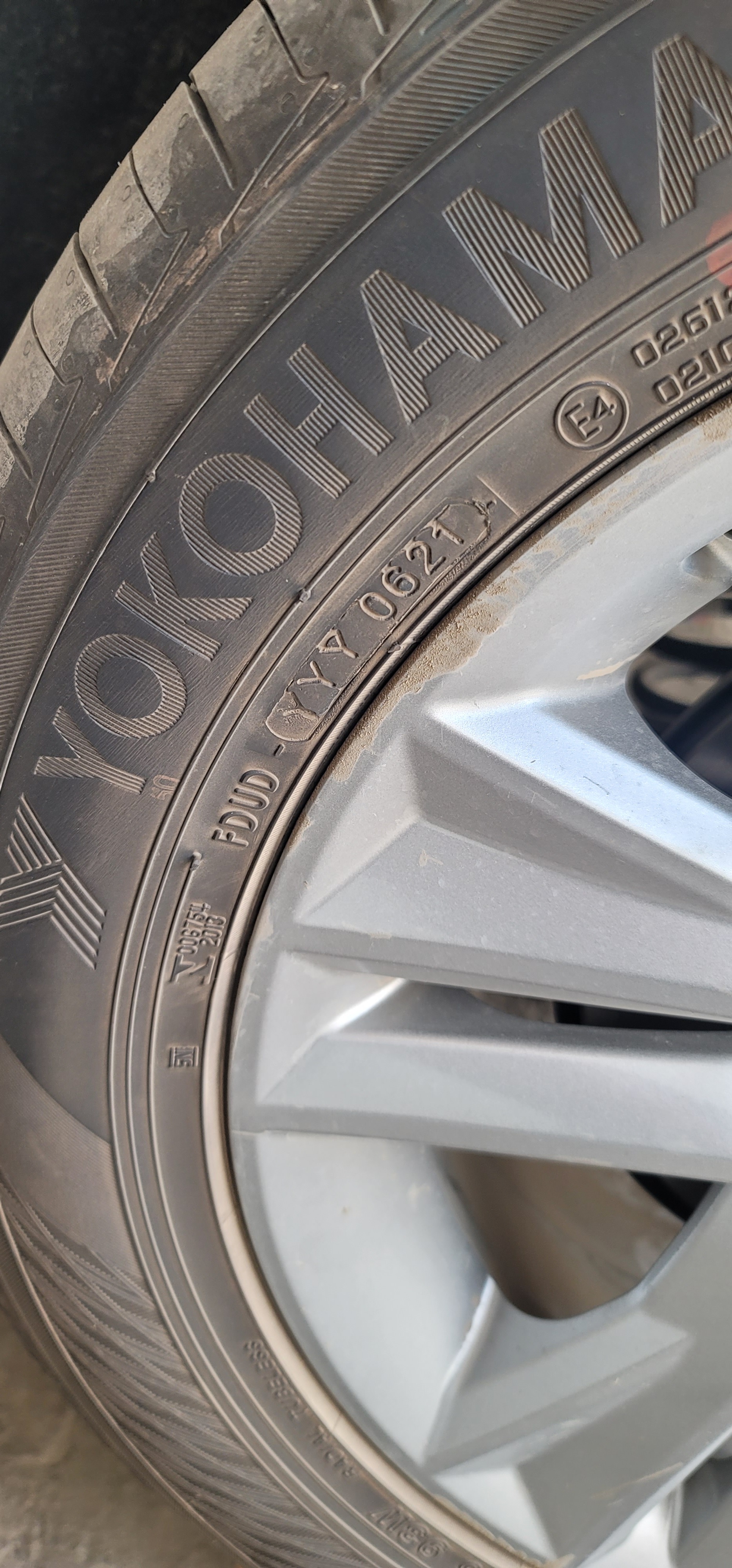

gr8 buy brother regarding tyres. best decision.

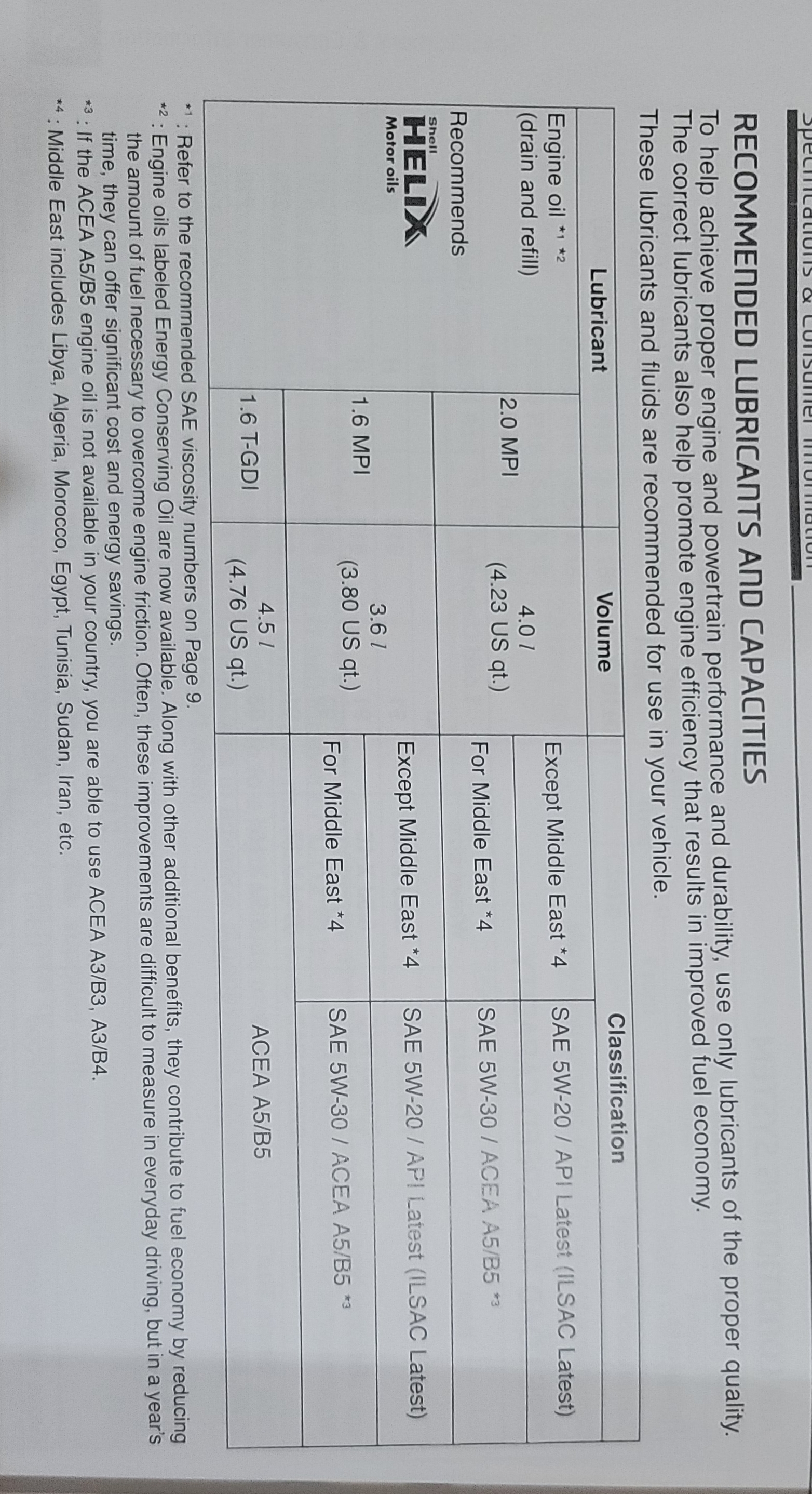

yes for oil grade your understanding is correct. 5w-30 API SN fully synthetic is the oil you need. Our weather conditions are quite similar to middle east since we have summers for almost 8-9 months now.
as per my experience shell helix does not have fully synthetic API SN 5w-30 on offer so you can use Mobil, Kixx, Total 5w-30 API SN fully synthetic oil.
What is the recommended change interval in the car manual? in toyota there is a table usually oil and oil filter need changing at 5k Kms/6 months whichever comes first.
table also dictates inspection and replacement details for different filters and components in the car manual.
please also check such details.
