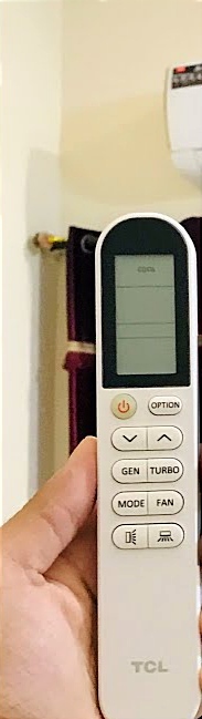

No Self Cleaning option in the remote
Turn off AC from remote then press Option / Auto Clean. This option only appears when AC is off from remote.
How to use this function?

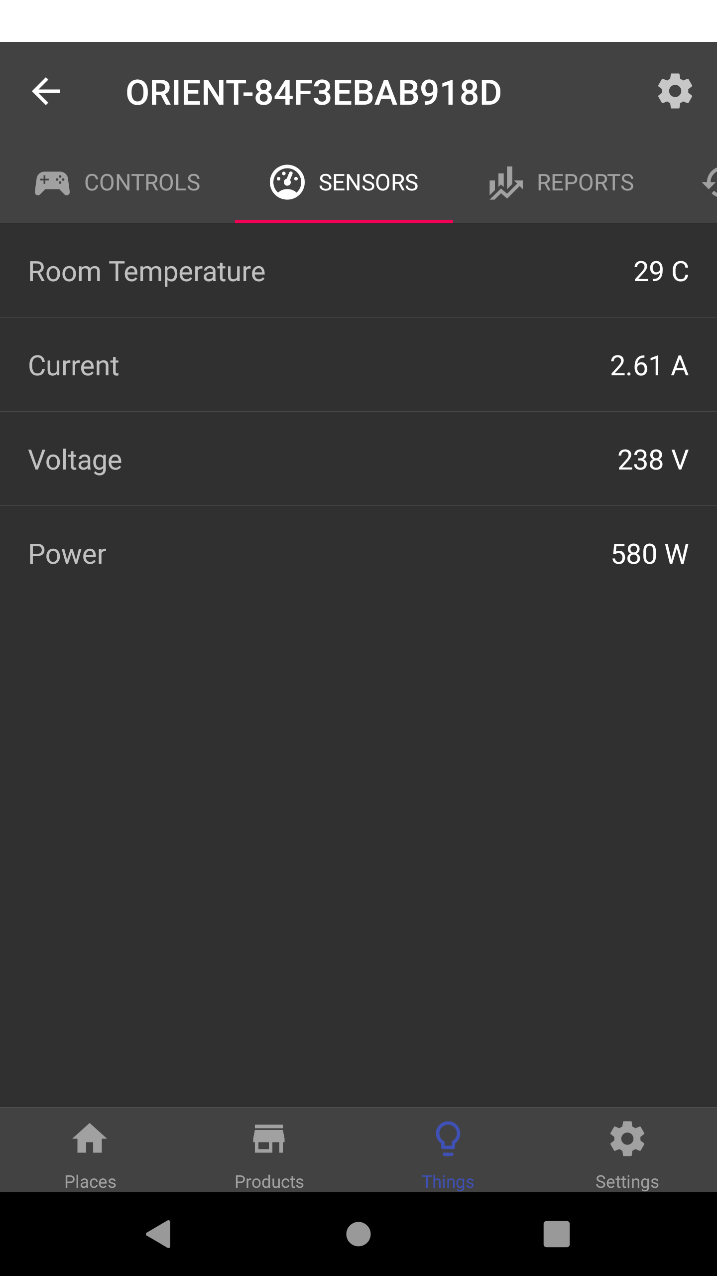

Orient App is garbageIt can only control AC But the consumption meter and room temperature and amps, these things doesn't update and are not even recorded properly. You may get watts of current time but then you cannot refresh it. You can then again close the app completely and then open it to update it. Also room temperature reading is always wrong
For power monitoring and recording better to go with Sonoff POW R2. You can buy from their official dealer Smartghar.pk

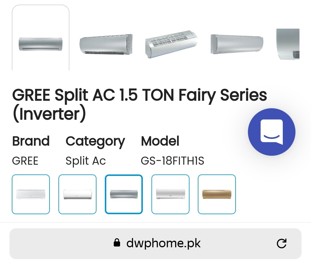

wow great to hear that, currently there Fairy 1, 2 and 3 are best models in T1 category and now for above models Gree is even giving warranty of 2 years on evaporator/condenser which i think no other brand is giving it.
it's just fine nothing special about this model.
you are right these above fairy models nowadays are being claimed T3 and i think before it used to come with T1 compressor anyways even if it's really coming with T3 compressor then I'm sure it would be the one that works good till 52, 53 or 54 degrees i mean not the real T3 inverter like Haier thunder inverter which works good till 63 degrees and i think a good T1 compressor even works till 50 degrees.
you are right, all models other than FITH series which @krafiq mentioned are t1
