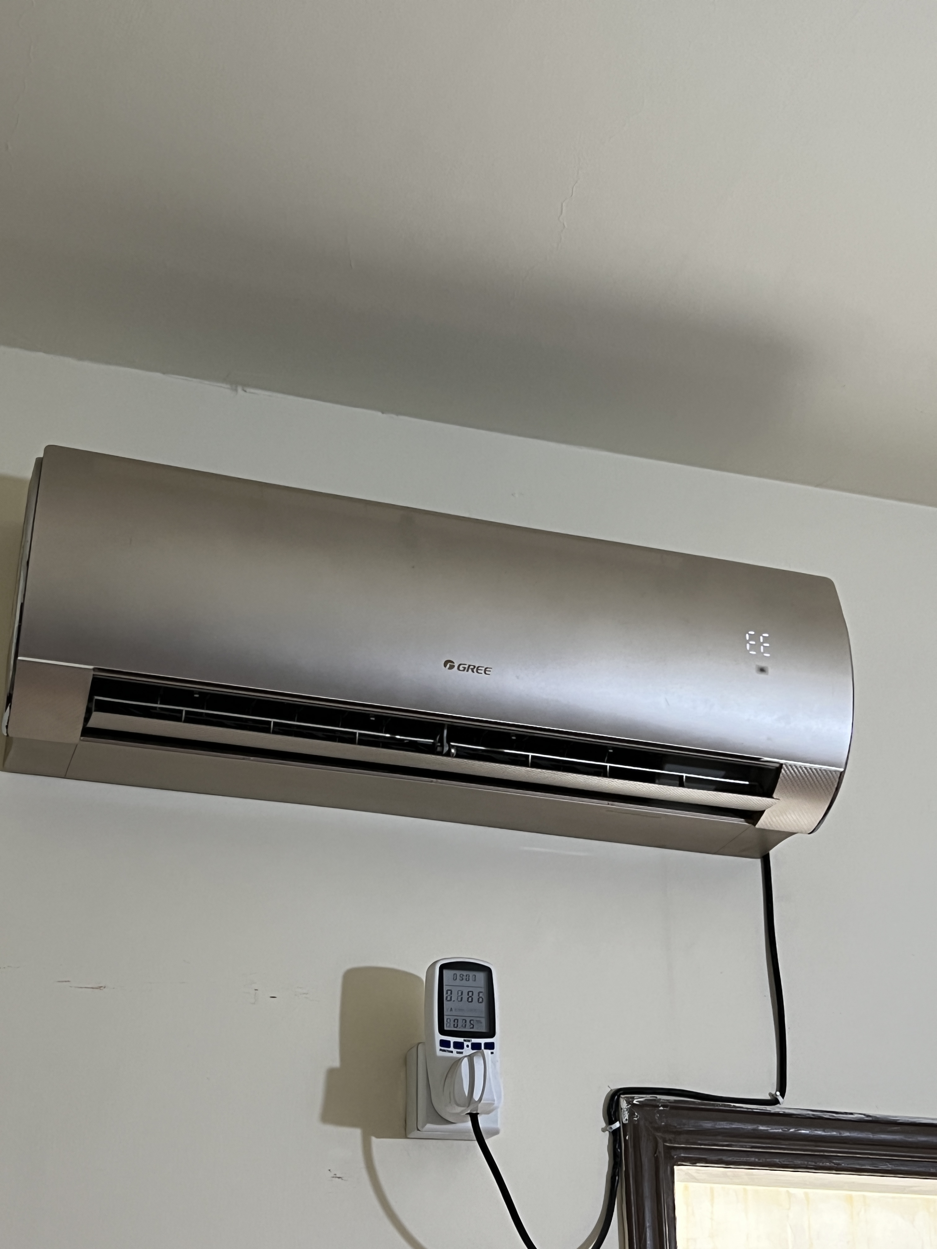

So 2 days ago my parent’s Gree Fairy 12FITH1C started giving EE error, sometimes it works and sometimes it doesn’t (doesn't most of the times)
I have launched complain with Gree and they said guy will come by Wednesday with 500rs visiting charges.
Does anybody know what the EE error means? Unfortunately we have lost the manual and the warranty card so can’t really check whatsup
EE error code is for outdoor main PCB board memory chip issue. You can look up gree error codes here
https://www.sidzcoolcare.com/error-codes/gree-ac-error-codes/

The Gree guy is saying its a PCB issue and asking for warranty card even before coming (which I have lost) however I do have the dealer invoice. Previously Kenwood guy asked that if i don’t have the warranty card they will charge some amount but not sure with Gree. It is however in warranty according to the invoice..
What should I do? Will Gree offer warranty without warranty card?
I do think you'll need one but check with the tech that comes to fix your AC. Maybe they agree with the invoice but there's little chance
You can check warranty using thishttps://www.greecomfort.com/gree-warranty-registration-search/
