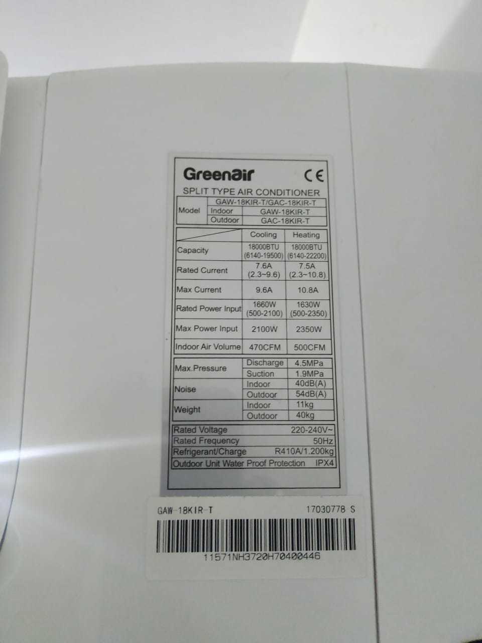

ambient temp in my area goes as high as 52°C. and i understand it will affect the cooling as well as the time to required to reach the set temp and might not be able to chill to the room at it minimum temp setting.
my query is that if set temp is 24-28C and as it is the within the normal room temp range. so if you guys are setting the temp of say 24, in above mentioned external factors, how long does your inverter take to reach the set point and at what amps??? and after it has achieved the set, how much amp does it consume to maintain the temp.
and one thing i do understand that to cool down the room in the start it will take max amp, but when it reaches the set, will the inverter consume the minimum amps at every set point???
i.e. in case scenario of set points, 28 , 24 , 20, 16. after achieving these set points in whatever period, will the AC draw same minimum amp or will it vary ??
