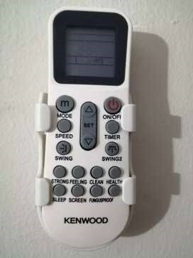

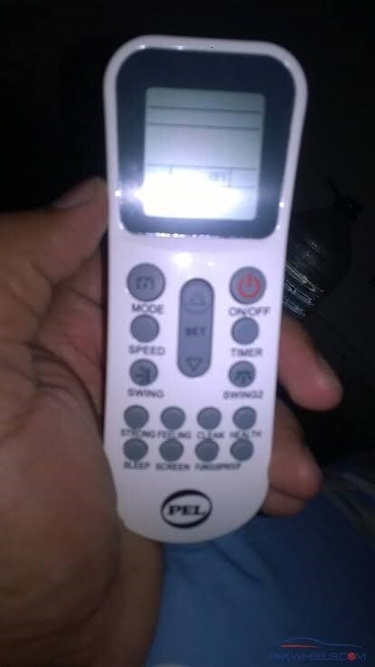

These Remotes are of Type-2 Inverters (self defined "Type-1/2" tags, not a standard, just for our understanding).... You can see these units are not having any ECHO feature in it... as its Amperes increase switching is very closed controlled... while Many of the other units are coming with Echo Feature and Fast/Turbo Cooling as Tag lines... which normally goes upto 7-8 Amperes even on 2-3C temperature difference... I installed Haier, TCL Elite series earlier both were Type-1 and returned it back after installation... However currently i have installed Orient Ultron Divine in my Common (which is Type-2) while Orient Jupiter 1.5Ton in another 13*15ft single closed room (which is Type-1). Orient Jupiter has Echo Feature in it.
Basically it is different technological approach of PCB/Programming towards achieving the desired temperature.. T-1 are designed to achieve the set temp. faster and then drop down Amperes gradually while T-2 are more focused towards controlled Temp. increase w.r.t temp. differences.
