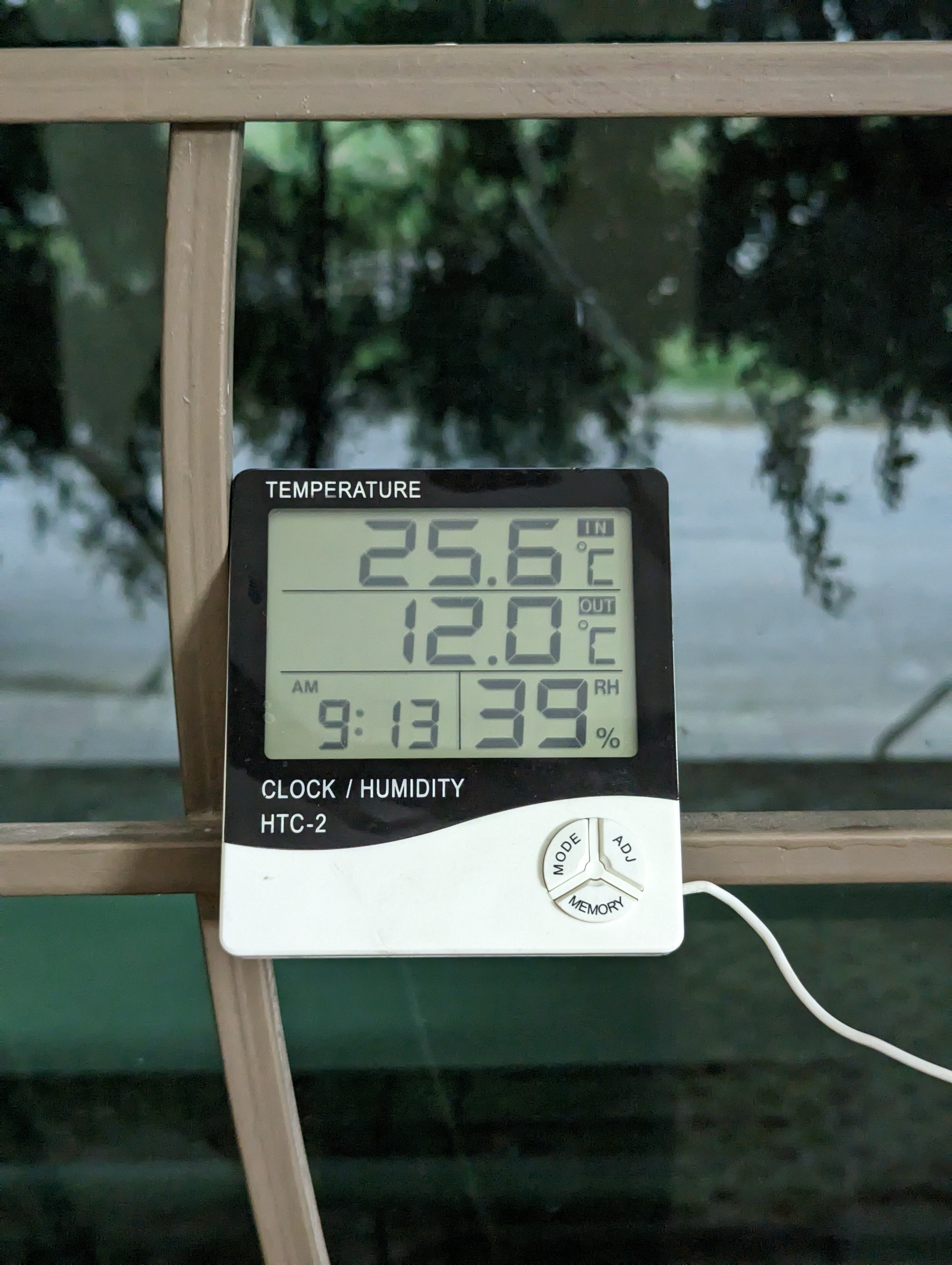

Edit 1, today (11th June) tested again (evening)
outside temp, 35C
temp in the room before turning on ac, 33.5C, relative humidity at approx 55%
15 mins after start, up to 30 mins and onwards, ΔT was 18-18.2C throughout
intake temp, 29.9-30
vent temp, 11.7C

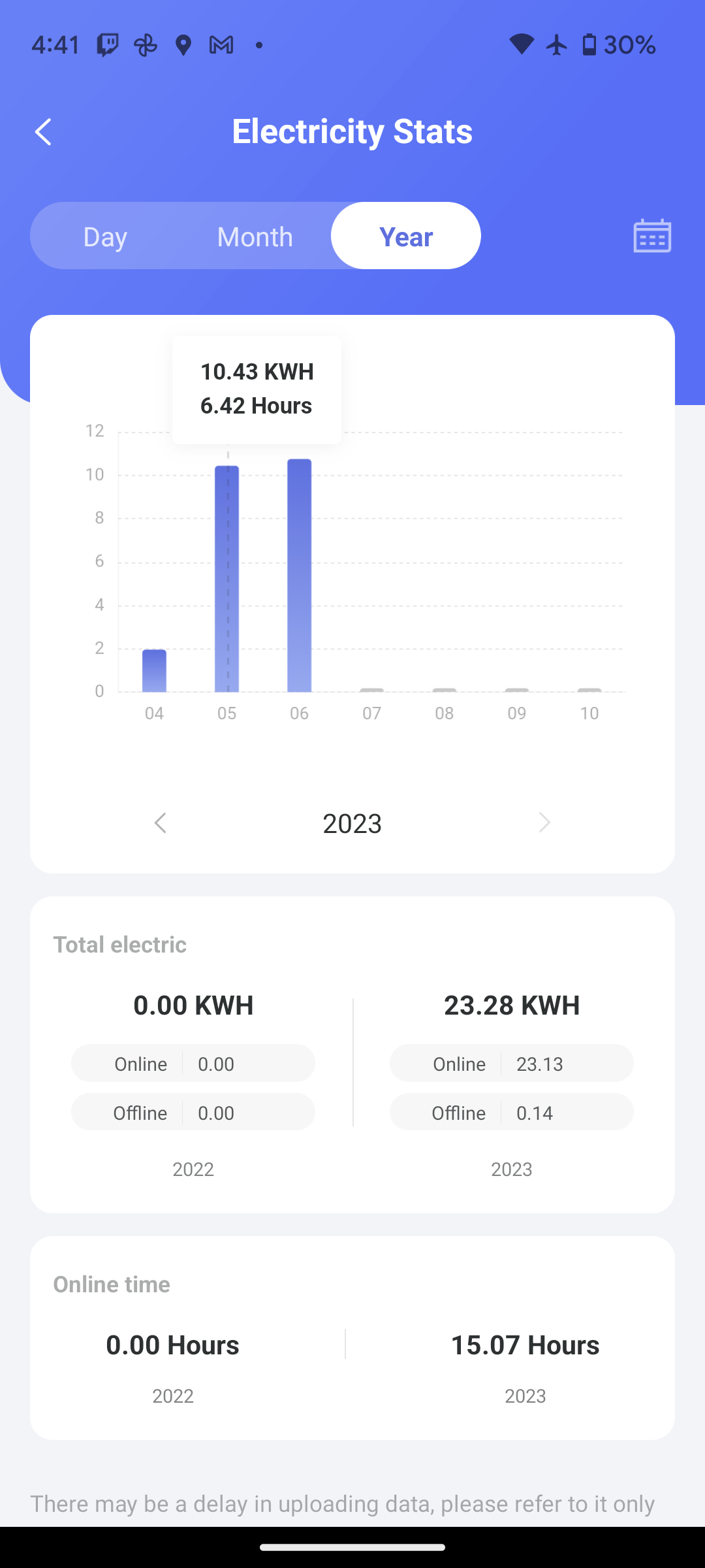

stable instantaneous power consumption, 1325 watts
Fan speed, Turbo
Edit 2: (at night), Outside temp is 32C
ac is consuming 290 watts/1.2 amps
fan speed, full (one step lower than turbo)
room/intake temp, 29.5
vent temp, 18.8C
