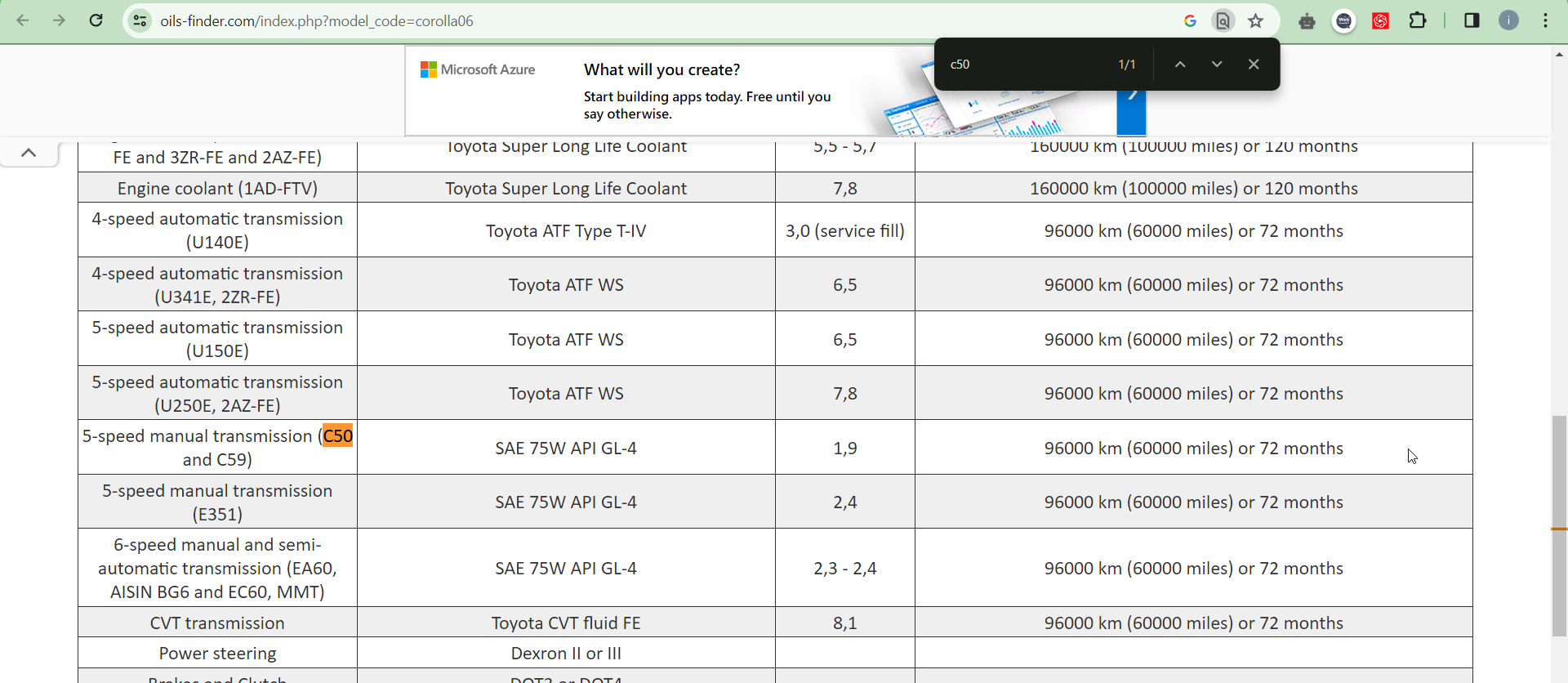

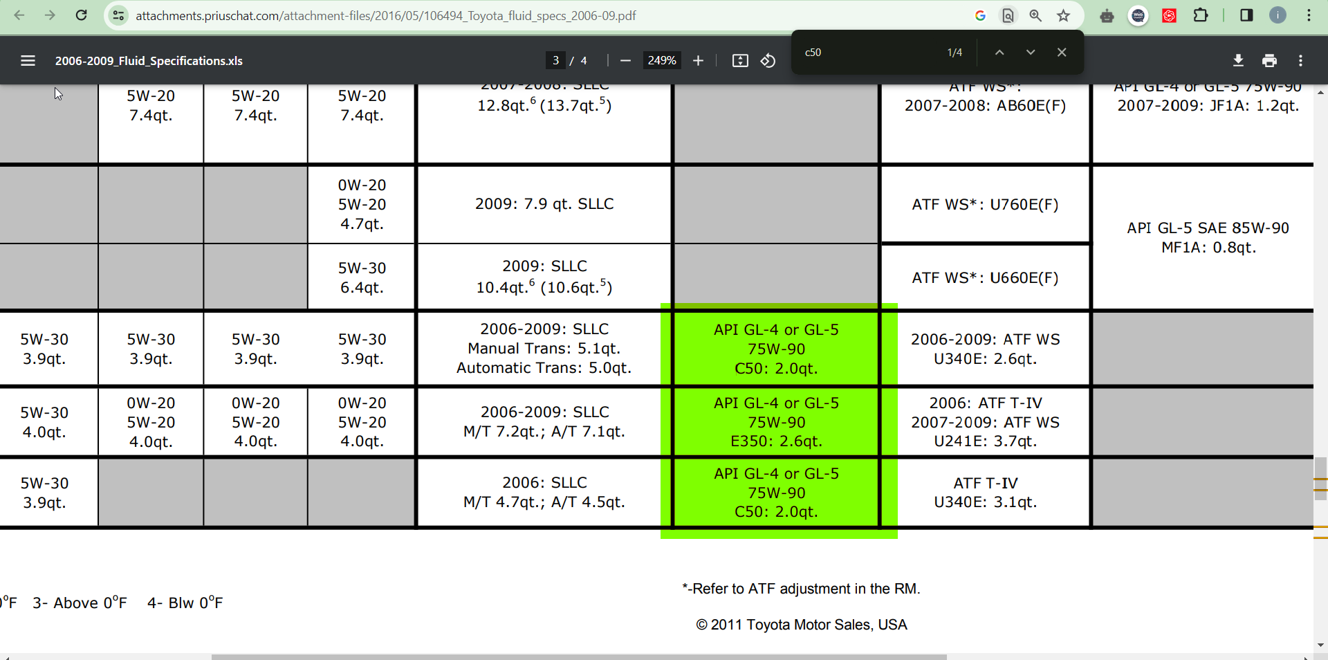

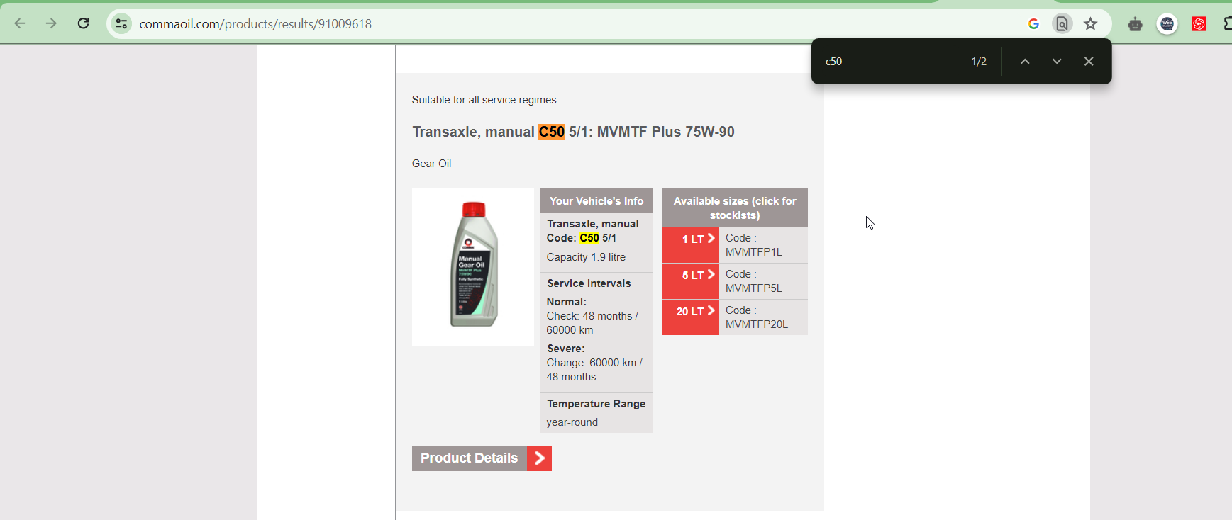

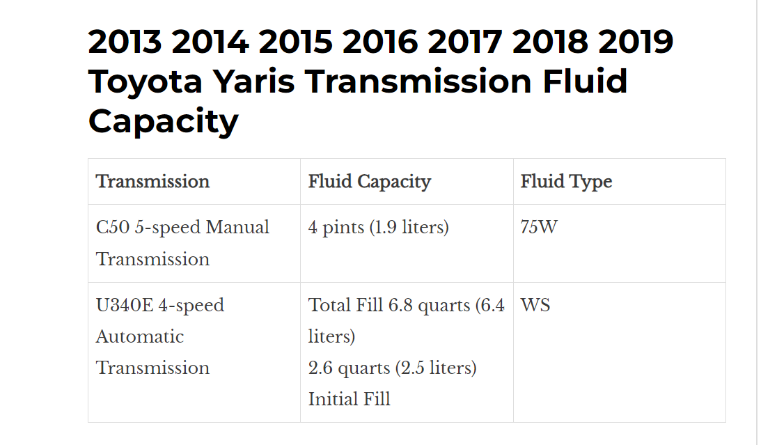

Our bhai here has got hold of the toyota motor usa manual for yaris. Its a different dimension, but what do we know - other than fix and repair them. 🤣
