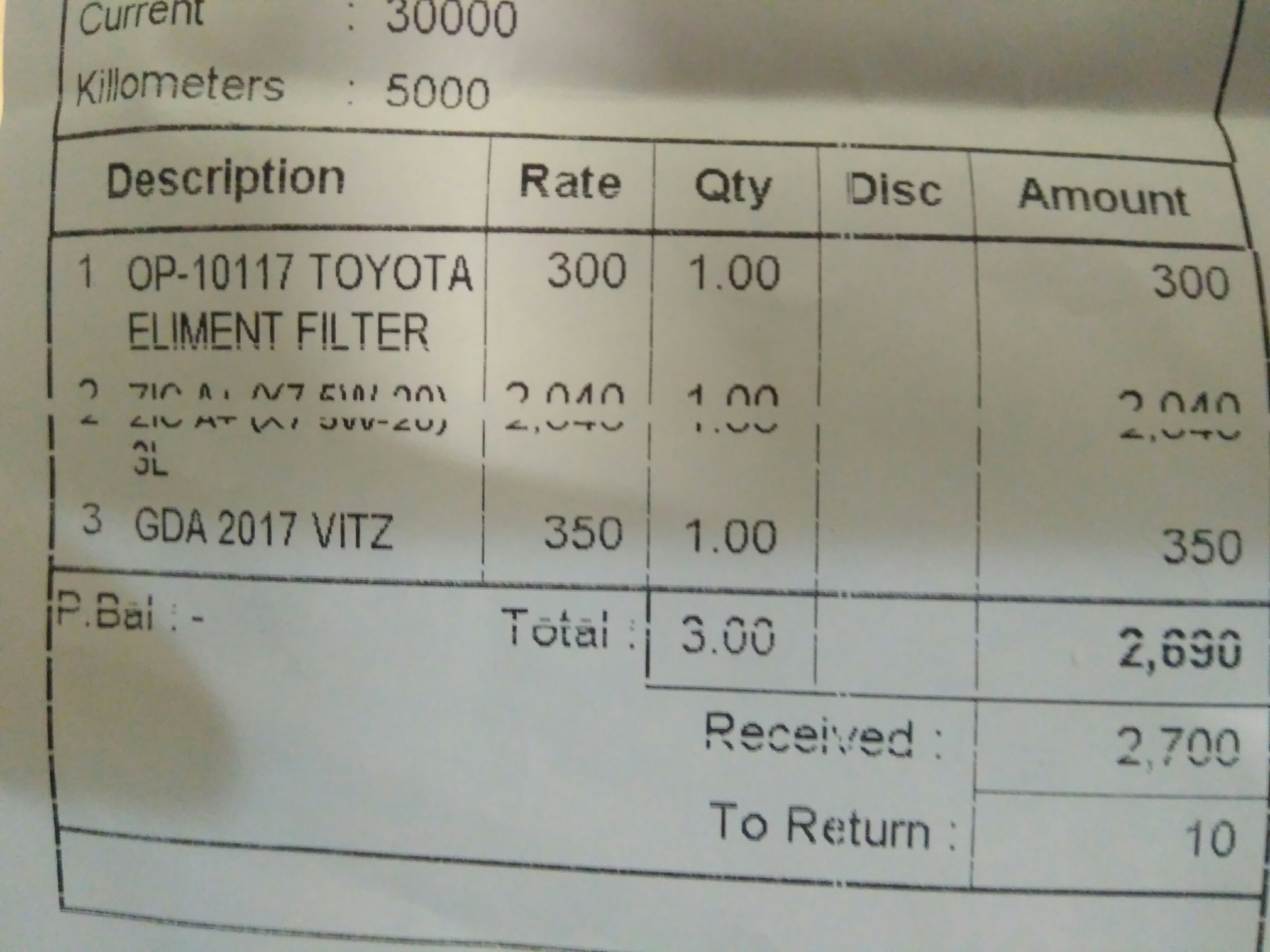

Switched to zic A+ on pakwheer's recommendationWill give my feedback near or around 4000km's Oil filter lepponAir filter guard
Let's wait for the results...

Yes i have added some oil after 4000 km... using LM 5w30...
