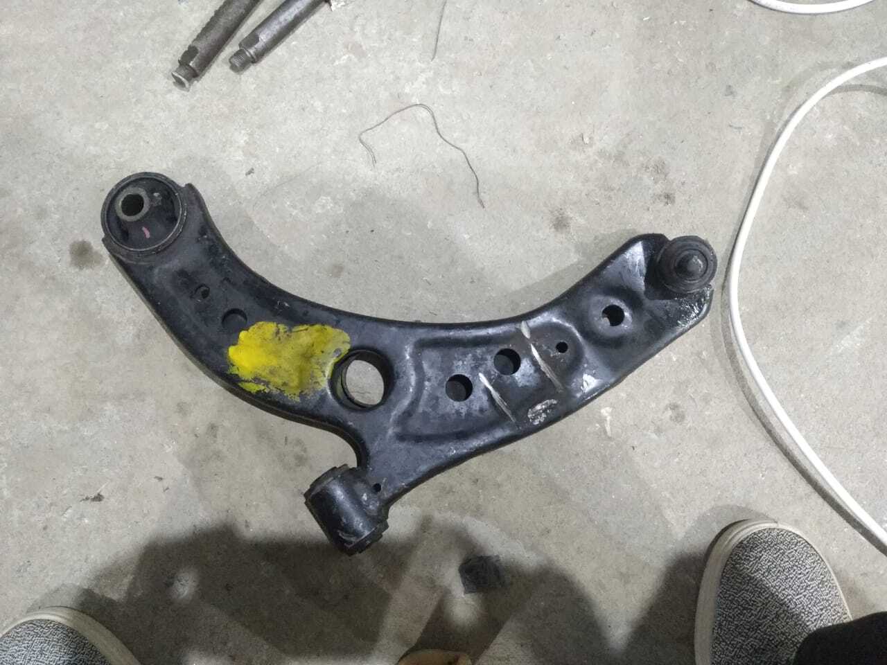

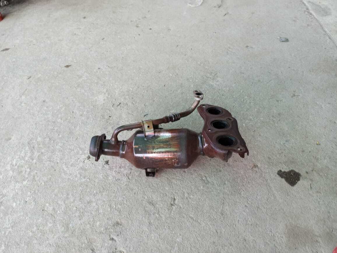

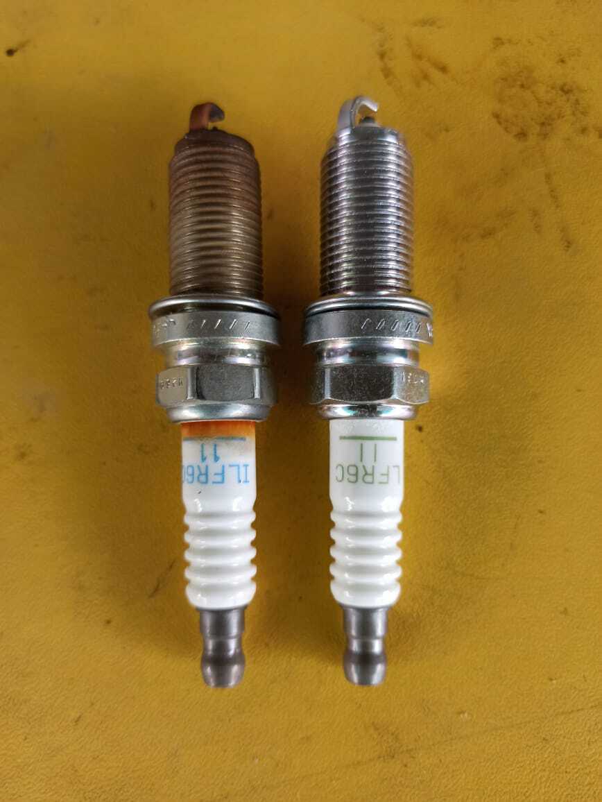

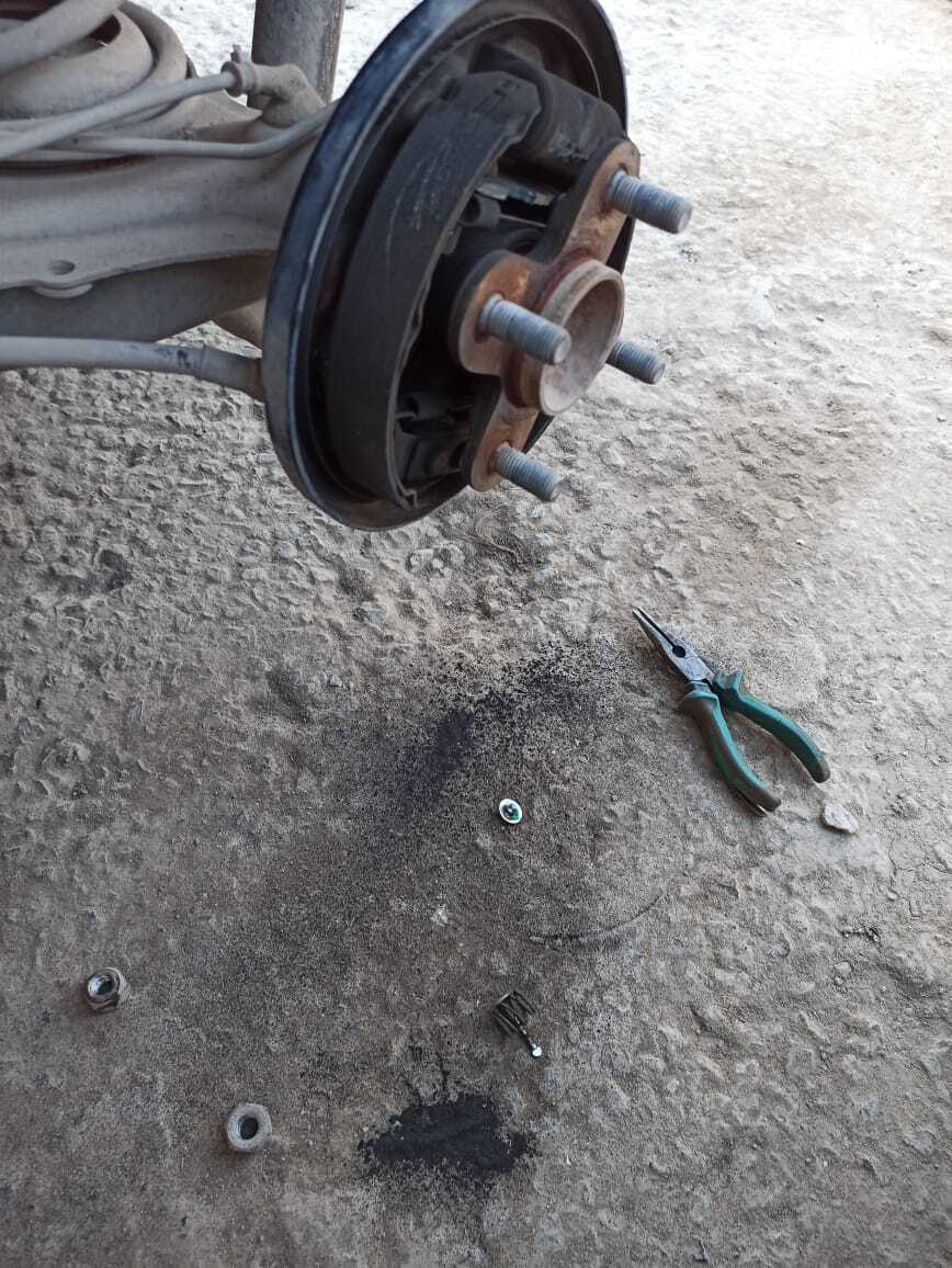

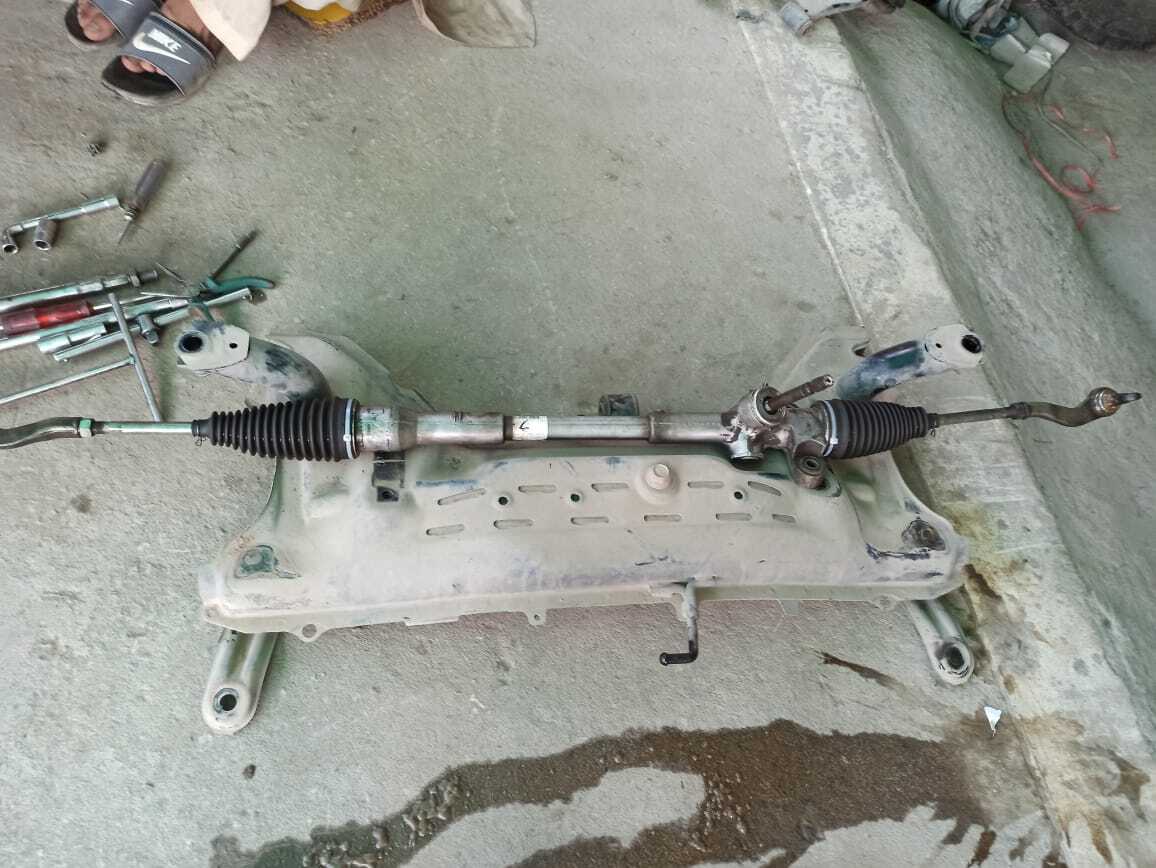

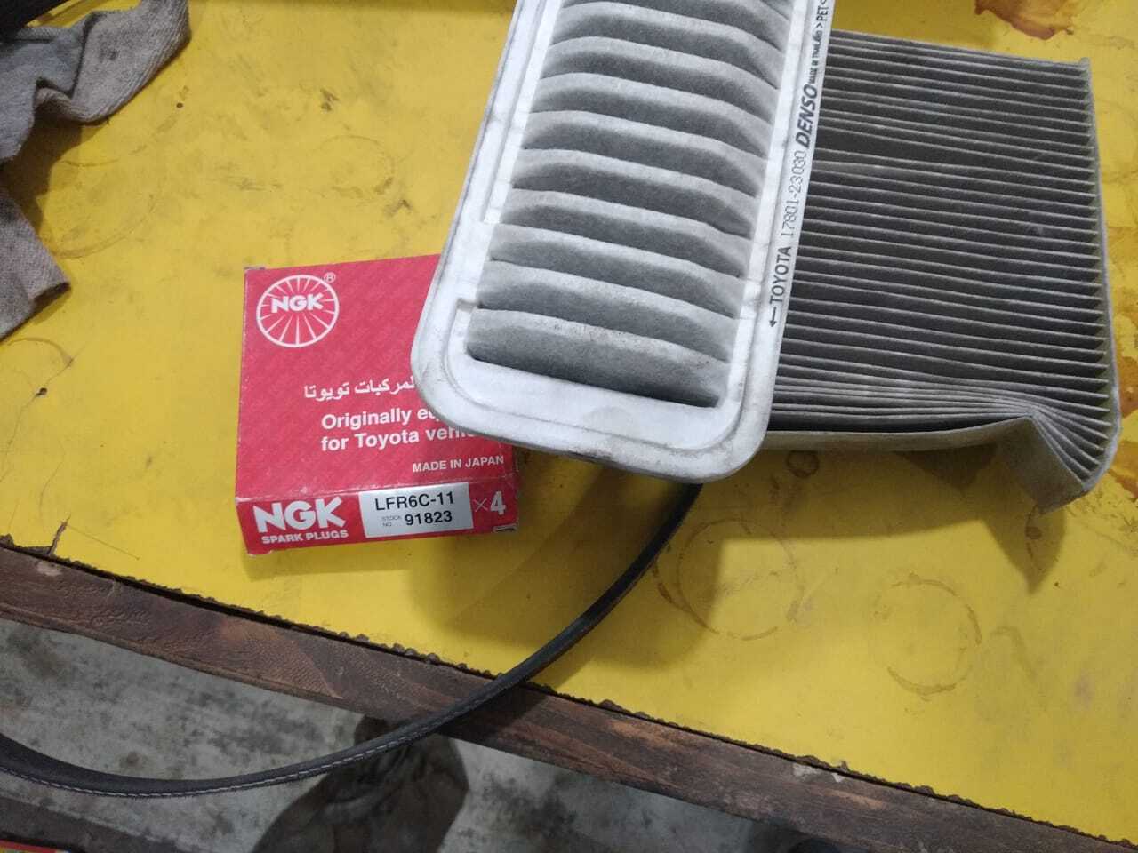

got kabli chimtaysteering bushnew plugsfuel filter servicedCAt converter cleaned new rear brake shoes new serpentine beltcabin and air filter drives like a new car now
From where you got the stuff and where you got the job done? Can you share labor and parts prices
If I am not wrong, the need to change Control arms arose because of fixed Ball joints (which had worn out)?
Spot on Kharad said they are damaged beyond press or anything
from a pakwheelerburraq auto's i told Bilal i cant run around for parts and all.. he gave me turn key solution junkyard items and new items came on bike deliveries which i was chargedtotal amount including alignment 25000 rup will look for breakup if somewhere around
