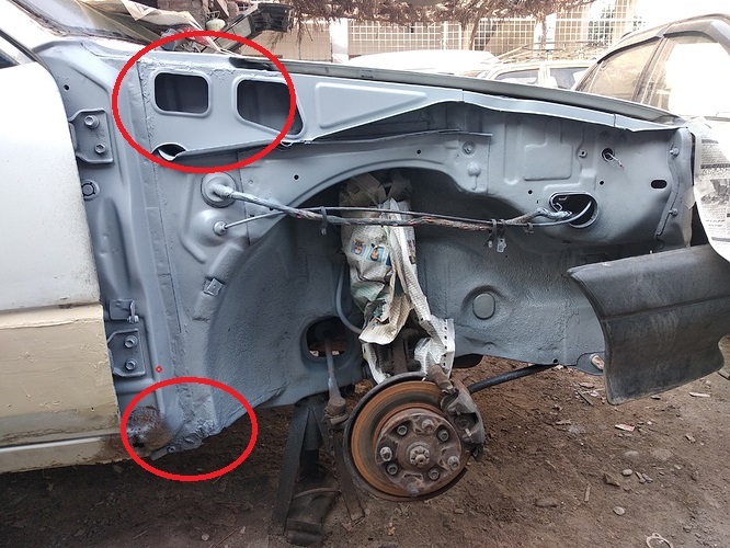

Did you stripped the rust before colouring?
Yes...sandpaper and then iron brush used...
All the rust needs to be removed before the spray brother. either by a wire brush o a grinder or if possible sand blasting.

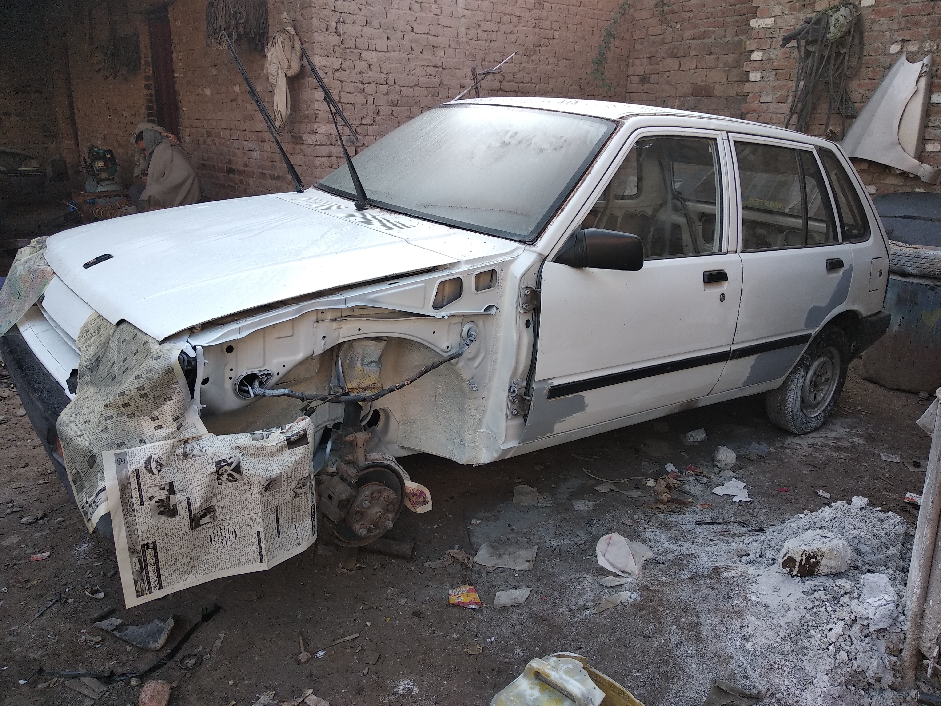

Shazaib, How much money would I have to complete the denting (many panels need to be changed), painting, shockers, jumps, suspention, Ac. Could any expereinced fellow tell me about any rough estimate?
Rust reformers are also good option.
Lower circle area will be replace by a new piece.
Yes.. dentor cleaned the rust and will aplly coat then will paint..so i think its enough for it
Minimum 50 thousand.. maximum 70
Do care of every spot
That is the replace piece..
Alot lot of rust still remain @mistarshahzaib ask the denter yo remove all of it. U can also use rust reformers but they will be a bit heavy on the pocket...
Dear Omer.. you right.. but work still in progress .. all the rust will be removed and repaint...
Awesum job Bhai... Good progress.. best of luck
