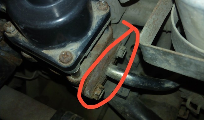

Arey yr kia mtlb k apnlogo ko gussa ata agr kch krlen ? Isko saaf krny sy gari khrb hjaegi ? Saaf hny walu chez thi tutorial dekh k krlia saaf or post krdia k dusry kiai member ki help hjae, kch dino pehly contact cleaner ka kra th tou ek bhai keh ry thy k apko kia lgta sportcar bn jaegi , orub ye 5kmpl ,bhai mery as a car guy mery liye ye b ek achievement k khud kra mai ye ,or 5kmpl tou ni kisi b lhz sy 0.1% frq tou pryga ee for sure, islie with respect agr appreciate ya kch positive ni kehny ka dil krta tou asy b mt kaha kren k dusry ko bura lgy,
++1.
Great job! Post more pictures and ignore the negative comments. These negative comments have ruined the forums.
Thanks bro
Please post a complete DIY with pictures. This will help everyone.
Ok I'll post with pictures next time whatever that can help others , I already cleaned mine EGR and posted the pictures i took at that time So i can just simply tell you guys 1) snap off 2 nuts on right side (blue)2) 2 nuts on upper side (red)3) EGR will easily get off you don't need to do much to remove it from place4) use brush ( i used painting brush )5) cleaner like wd40 ,tb cleaner etc ( i used petrol because i don't have any at the moment , in a pressurized bottle that is normally used by detailers)6) spray cleaner on both sides (front hole and right hole) and use brush in these points and spray again , 7) repeat this until all the dirt comes outLet it dry ( i used blower ,just to be sure and placed it under sunlight for 10-15m)
8) install it and you're done

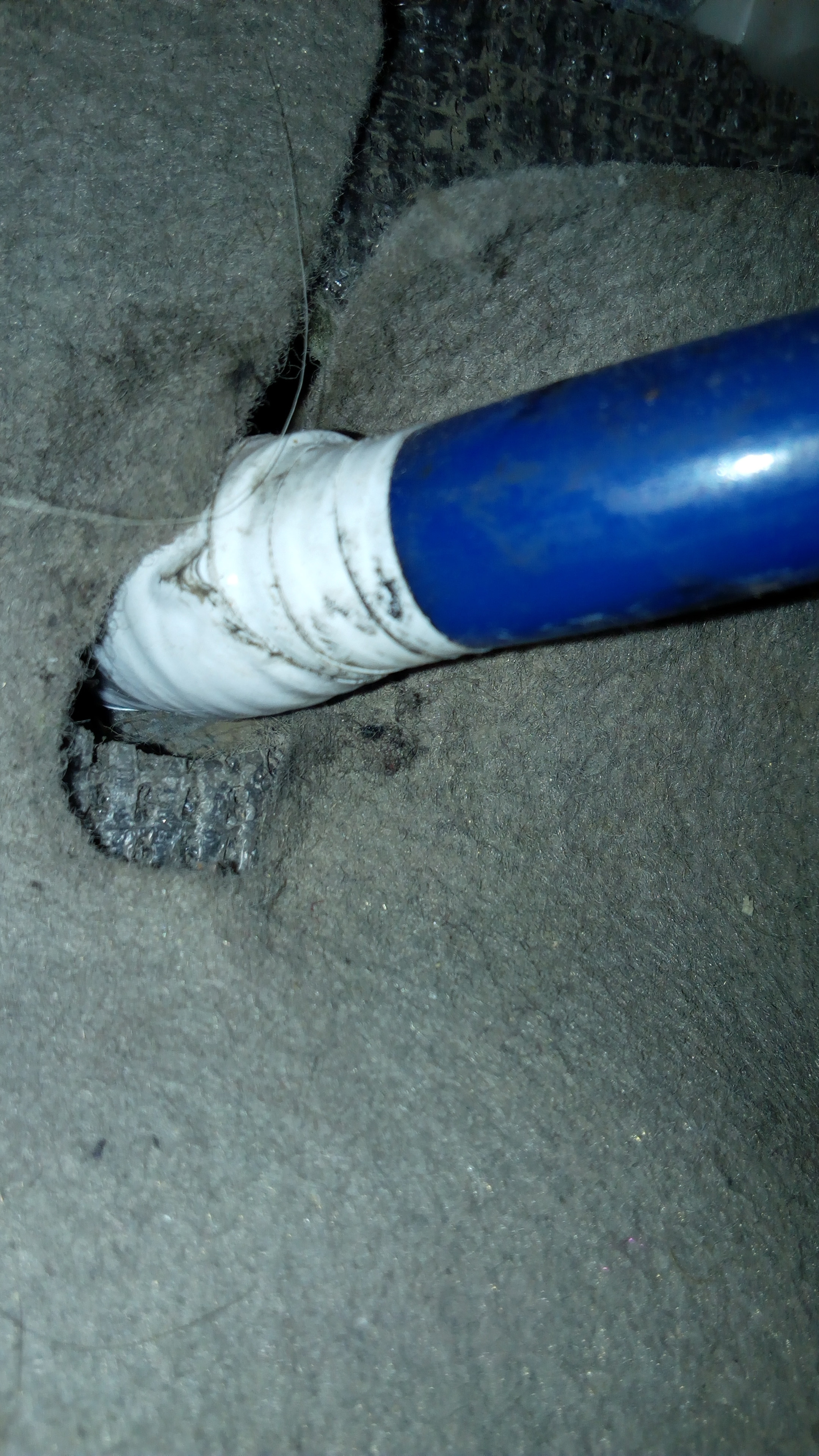

Salam bhai logI m having a little problem with my liana Actually i m not in Pakistan my wife told me that Ac is continually throwing its water inside by side seat. Carpet of that side is very much wet she doesnot know what to doMene socha ap bhaiyun se thori help li ja sakey if it is possible to do D. I. Y
Buddy same msla tha meri wali mai b , left front side ka carpet bht gela rhta tha , mery case mai ac ka drainage pipe farig hochuka tha totalyy or uska stopper b gal gya hua tha woi andr pani phenkta or bahr k pani ko b andr welcome krta th , eid k dino m hua tha tou new pipe ni mila islie phir jugarr lgayaNormal jo pipe ghr m use hta uska chota sa piece lia or usk darmyan m kafi zada tape (electric) lgai k wo itna mota hjae k uss hole m fit ae jismy stopper lgta jis sy pipe pass krta or pani andr na ae ,khair it worked veryy well even barisho m b ni ara pani andr I hope pix can help u understandBaqi jo farsh k rubber hen unko b check kren wo b aksr gal jty time k sth jb ye gari li thi tou 1 trunk ka or 1 floor k rubber thy e nai meri wali m
Ye charo ek e pipe k hisy hen or circle shape m stopper h jis sy pipe bahr jta or baki area seal krta hole ka
