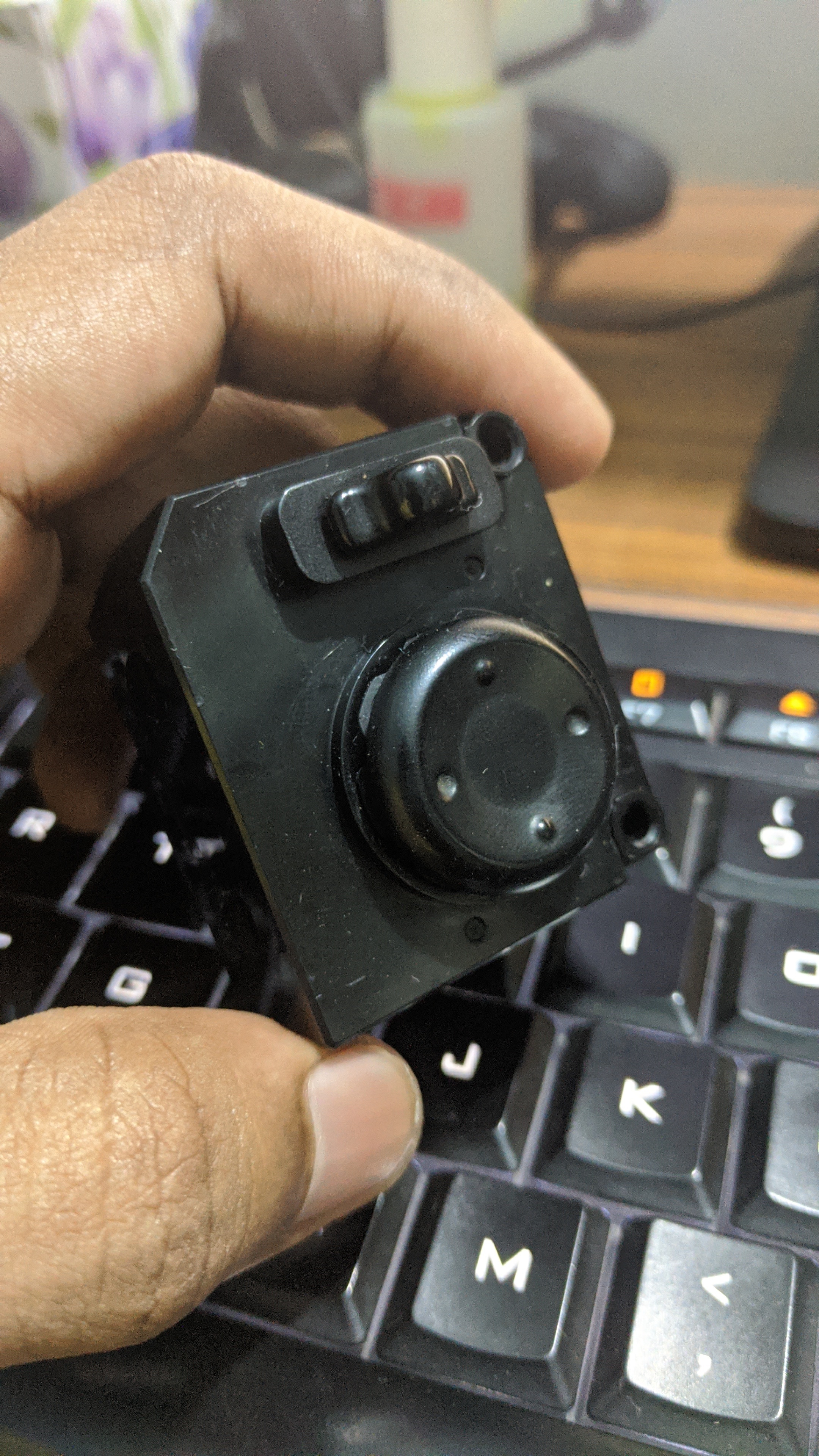

Where in Karachi can I find the Mirror switch for Suzuki Liana? This one doesn't work properly.
