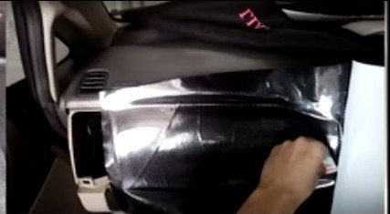

I tried but failed miserably, the sticker was of inferior quality (i guess).I will try again INSHALLAH.But that attempt helped me to understand that cracks will remain prominent to some extent even after wrapping.
See YouTube videos on interior repair

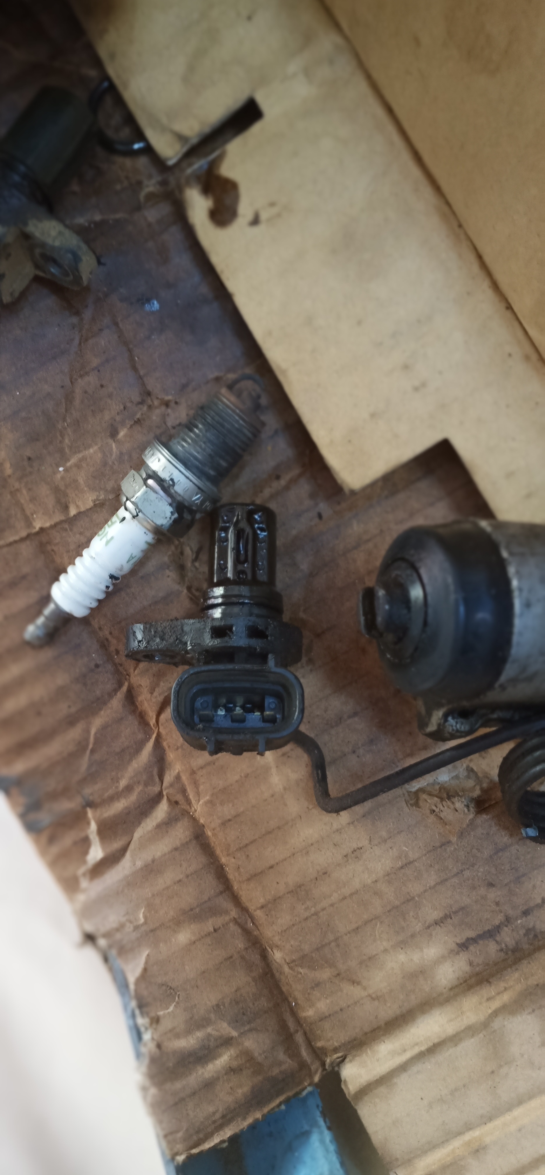

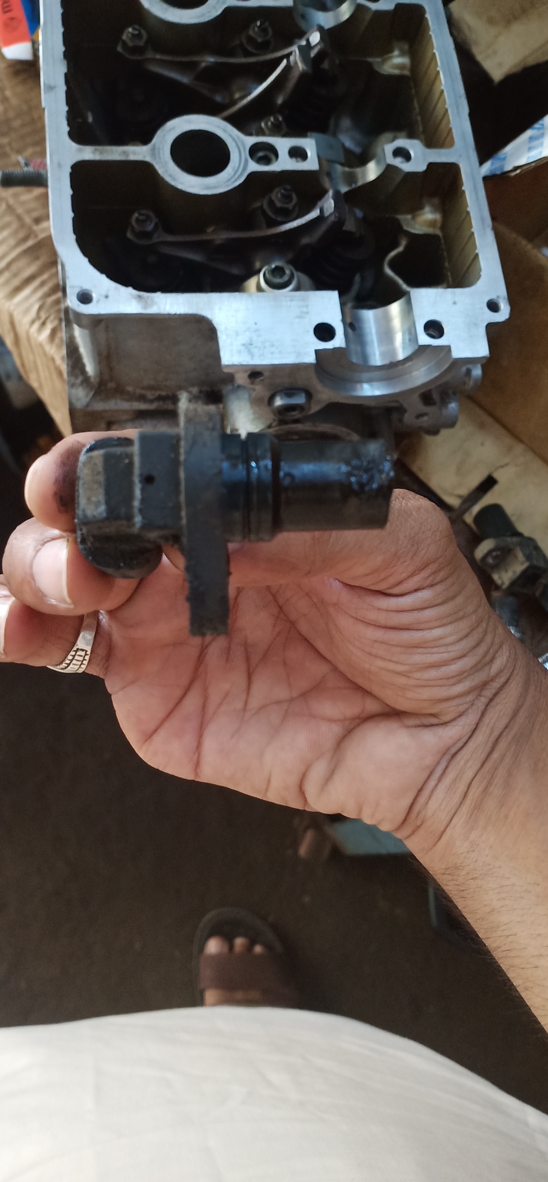

Hi salam Liana 2008 rxi Missing rpm up & down jumping like 1500/2000 & some time engine check some time not & some time not start first self some start in hot conditionSo go's to mechanic & tuned but problem was not solved same again I go mechanic & saying rpm not stable mechanic saying me b coils issue but not cnfm soNow I check by Scan and show camshafts sensor faulty Now mechanic saying 2000 Kabli camshafts sensor & 2000 labor Mechanic saying its big work need time 5/6 hours Liana camshafts sensor back side Generator wagra open krna hoga or engine cold hoga to kam hoga Kiya itna difficult ha kiya ???
Camshaft sensor is right above the timing chain cover and below the power steering pipe. It's a 15 minute job. Change your mechanic ASAP! The RPM jump is probably something else on the throttle body.
Bro scan se e pata chala tuned krwai throttle body wash krwai plug's new but no improvements So scan k bad camshaft sensor error show hua & 15 mint's job bro Power steering pipe's open hoga kiya But bro hot engine m y kam e nh hoga jab engine cold hoga tab open hoga I think
Now today go's to mechanic for For sensor change with kabli Crank senor & camshaft sensor Camshaft sensor is OK just change crank sensor kabli 1500/ Now missing and rmp issue resolve mashallah
See the condition old crank sensor
Great! Btw, why was the valve cover opened? Cam sensor comes out with just 2 bolts on the side.
Yes bro just in 15 mints job your correctNo bro it's not my Liana value cover
