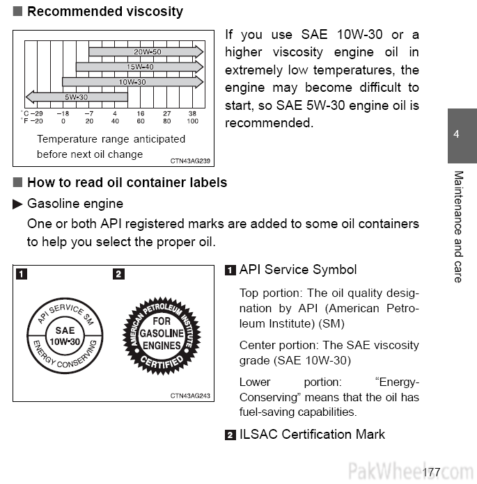

the recommendation table in every vehicle user manual is for cross reference only., user has to determine the operating conditions and select lubricant accordingly.
when outside temperatures are soaring to 45C after daily run, if you park vehicle at night ... to start again at 8 am in morning the SUMP temperature is never below 10C ... [ during summers ]
i did this test randomly during ramzan shareef this year in Karachi, at fajr the oil temp was 12 C measured via ifra-red thermometer inserted through dipstick slot
