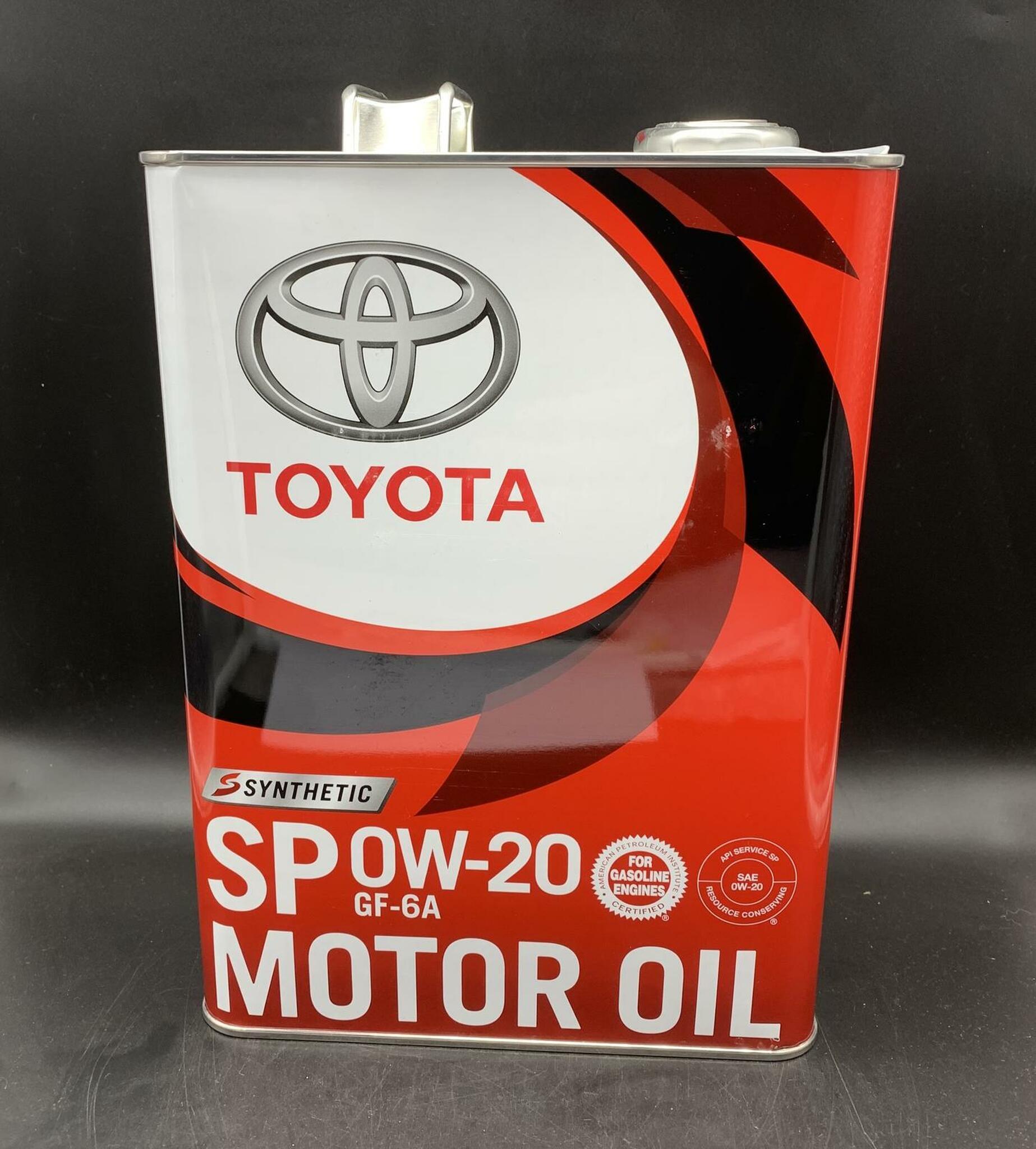

0w20 was already available at dealerships. but imported and expensive,this one
now 0w20 which imc launched is packed by idemitsu pak (idemitsu also makes suzuki genuine 0w20 and 5w30 for paksuzuki)
One mention RC while other SN, wht should one choose as price is almost same. Nd i guess 5000 is for synthetic in our environment

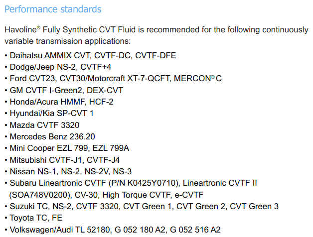

I suggest you buy Havoline Fully Synthetic CVT Fluid. It can be used in Honda CVT transmissions where HMMF and HCF-2 are required.
The best part is it will cost you half the price of Honda HCF-2 fluid. Buy it from Caltex official store from Daraz to avoid buying counterfeit.https://www.daraz.pk/products/havoline-fully-synthetic-cvt-fluid-4-l-i123130641-s1279988531.html
