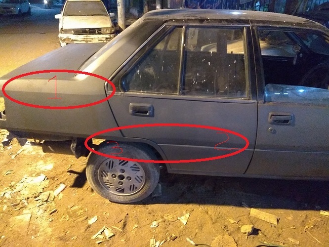

check the attached pics with marking:
1) both the lines are incorrect and not leveled. despite the putting, these lines have to be sanded and made even because once paint is applied this uneven line will be highlighted more.
2) again the line seems like the door has been bent. so make them straight. ask him to ad the putting and then re sand it to make smooth straight lines.
3) the corner bent where the door is meeting the wheel arch is somewhat misaligned as it seems that the door is in and the wheel arch is out. adjust this before anything i think this needs to be adjusted by the dentar and not the paintar by applying putty,
