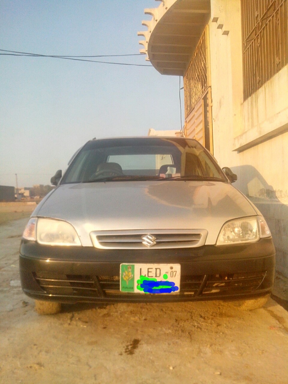

I was going to Sargodha on Thursday. as soon as i crossed bhalwal i stopped in a gas station and went for rest room came back started the car after 100 meters car stopped and wasnt starting.. it was getting self but wasnt starting current was fine. i checked petrol pipes no petrol was coming... Fuelpump fuse was also fine i sucked petrol and petrol was coming so faulty fuel pump..
Anyway i asked a chingchi wala and went to near by mechanic he checked the fuel pump current it was fine i asked him to check the fuel filter may be that was choked he said agar choke hota to suck karny se bhi petrol na aata he suggested me to install inline Electronic fuel pump.. so i installed that and it is working fine except i makes a very bad ratteling noise when ignition is on.
