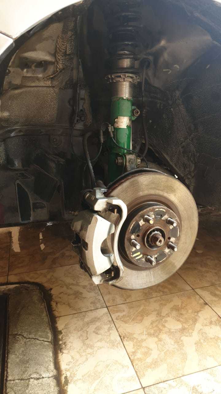

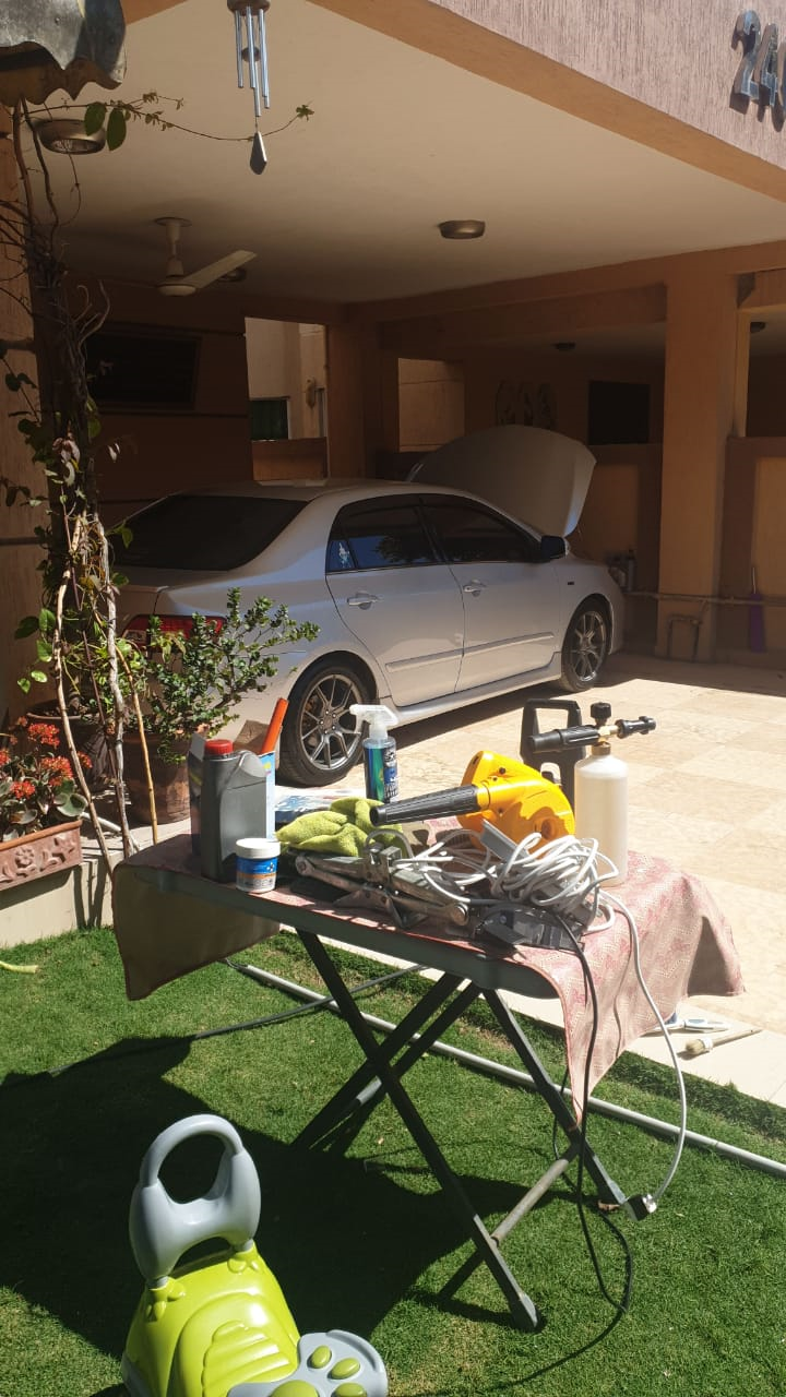

I used a heavy diluted megs APC a wire brush and sandpaper to clean the calipers from the years of brake dust and also found out that the calipers are a nice silver color at front from factory and a grey color at the back, if they were all silver I probably would have thought about painting them:P

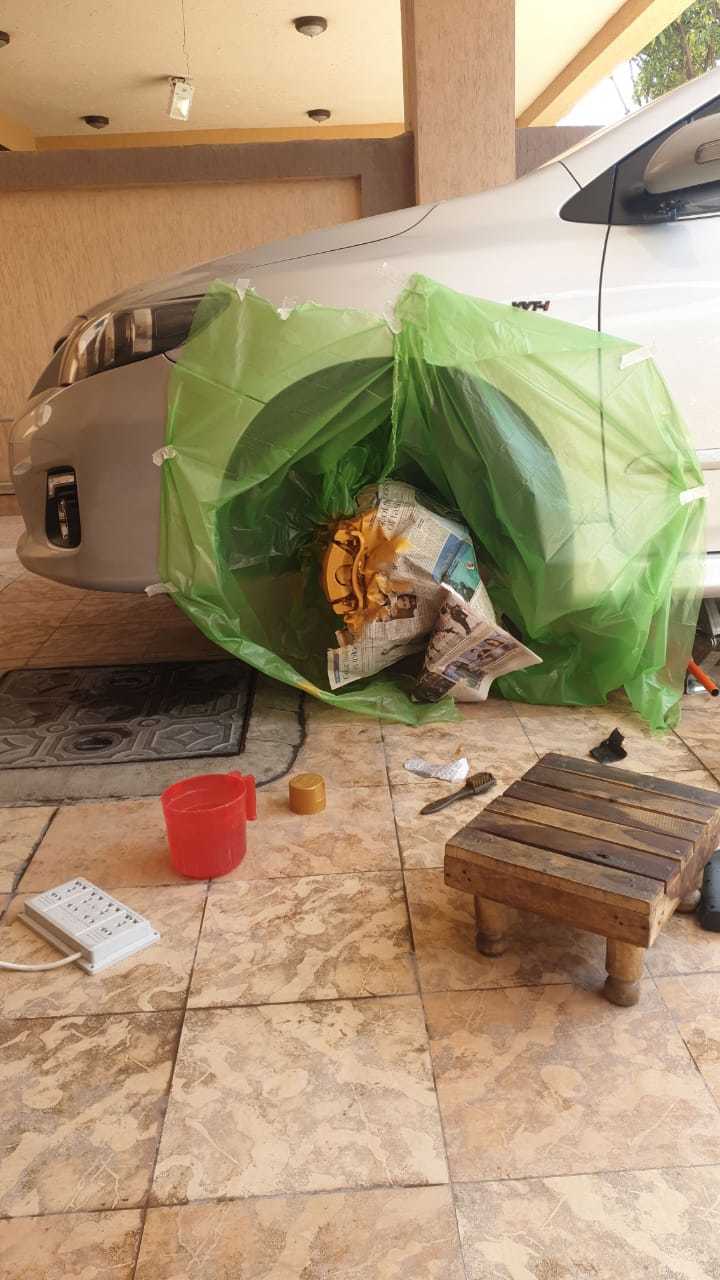

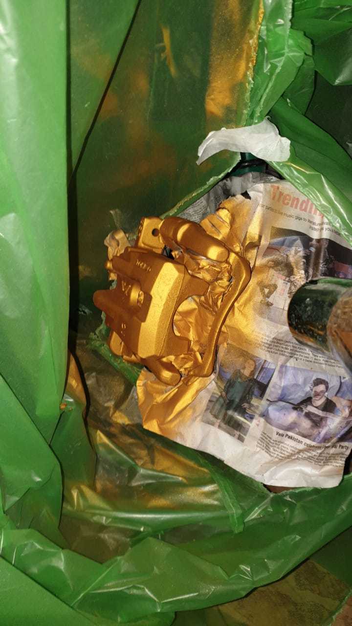

Next I taped off the area with two garbage bags cut open and some newspaper that was used on the discs also masking tape was put on areas that I did not want paint to come in contact with e.g. the caliper pin rubbers and the metal pins that secure the pads.

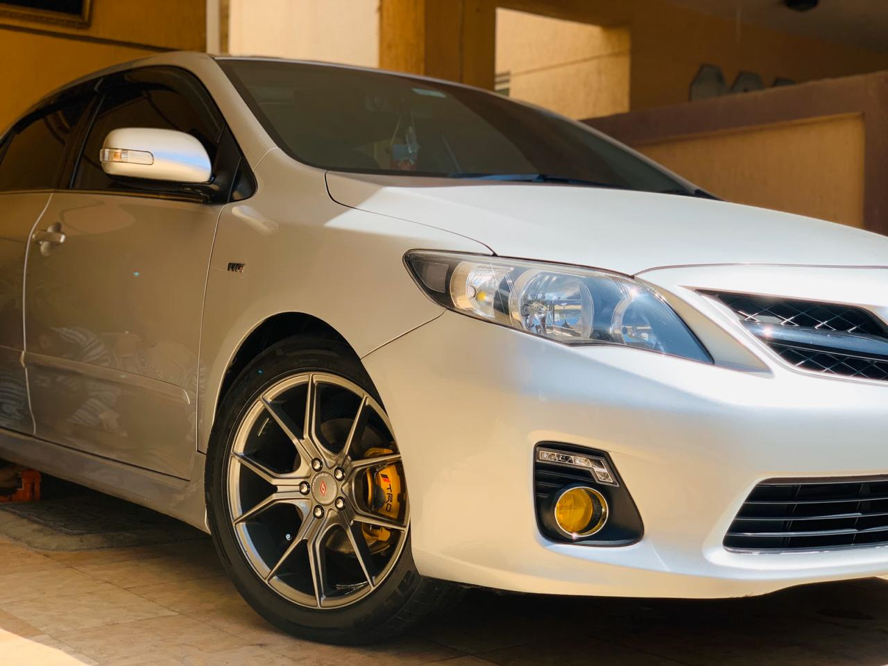

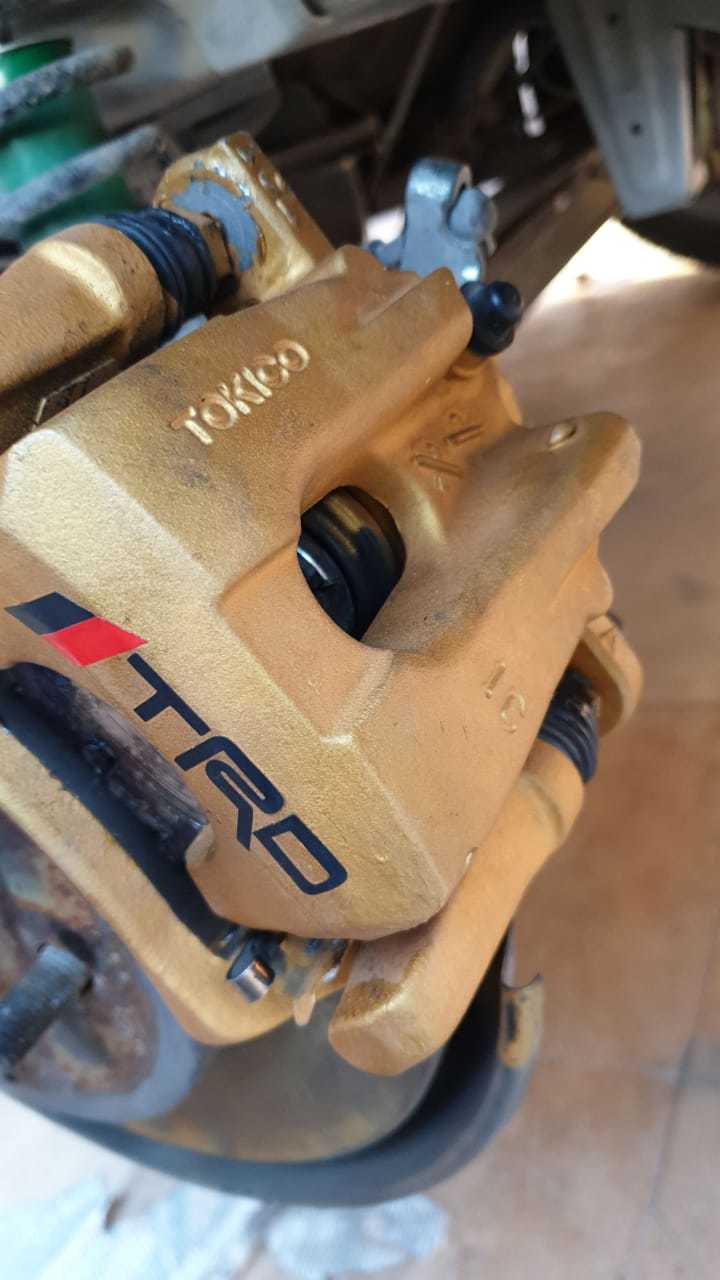

I gave 3 coats to each brake caliper and this is what they looked like in the end.
I got the TRD stickers made from Sticker Lover PWD by giving him measurements of the calipers and this how they looked like in the end.

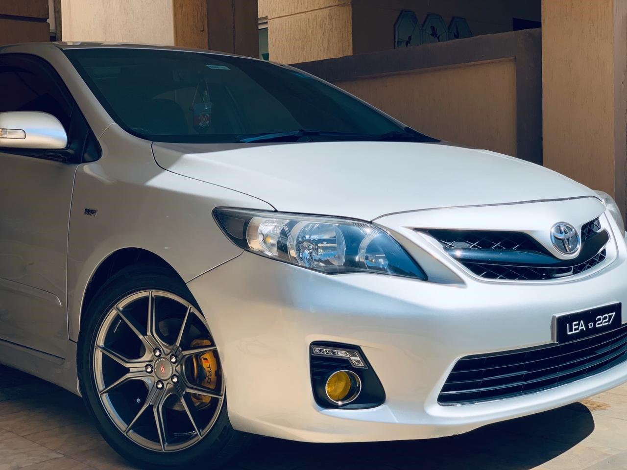

But Allhamdulliah very please with the results, once it was fit, I went on a round and did light to heavy braking, I read also that was a method to bake the paint, and then parked it in the sun, and took some photos.
