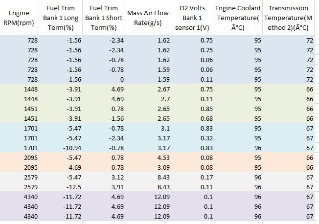

Reading of MAF sensor.
Your engine is a bit weak or the Pcv air intake is choked etc.
Thats when trims start moving like this
For that I need to change PCV valve and do compression test!

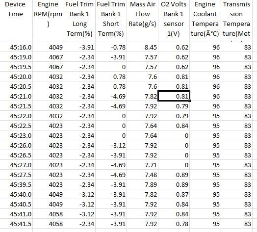

Then not to worry about it it does get rich by time and aging plus check for visual smoke and check the short term fuel trims at constant 4000 rpm if the fuel trims shift toward -20 then brother the engine is blowing out the oil in form of smoke and oxygen sensor is sensing it as fuel and the ECM is cutting down the fuel to compensate it. Do the teat and let us know
Thank you for the reply, there is no smoke while readings of fuel trims at 4K rpm are;
most likely its a leaking exhaust valve, i'd suggest a compression test, table in post #21 pointed towards a chocked CAT as well but the last chart rules that out
Performed the Exhaust valve leak Paper test but didnt find blow by.
while after changing MAF, cleaning of intake manifold the readings still in -ive but reduced.
@rajaatta while engine dont burn any oil as it is evident from condition of exhaust.
