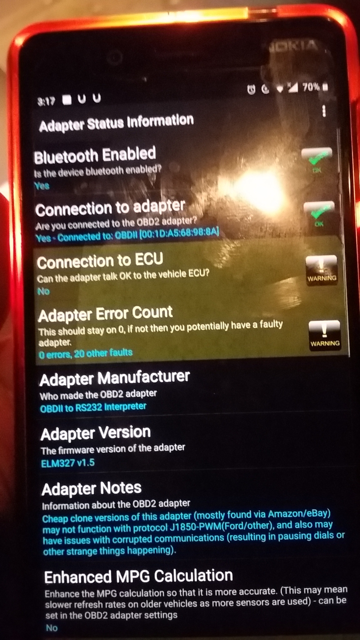

Bro can u help me with it my connect to device but doesn't connect to ecu

Acha hassan bahi jab ye configuration karta hon tab adopter error count ziyada hota 11 fault thak or jab ye configuration k baghir wo zero retha hay its mean adopter karab tho nai hay
Jazak Allah hassan bahi meray khayal say ap k tawasud say ye maloom howa k adopter faulty hay.
Ye gadi k ecu mai kohe masla tho creat nai karay ga na

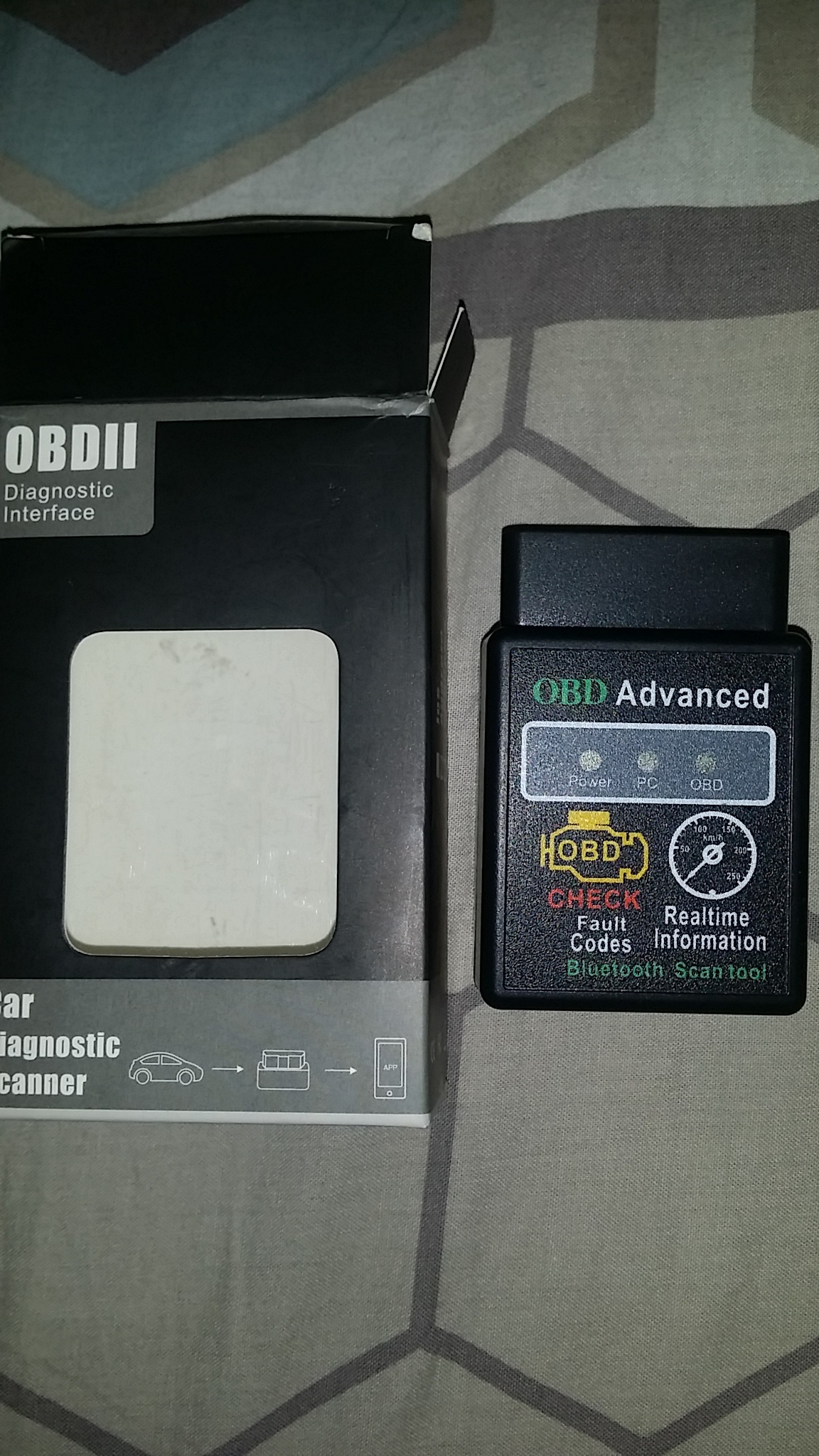

Adapter ki picture bhejein
String dalnay k baad bhi nahi howa?
Nai string dalany k bad adoptar error count ziyada hota jatha hay jasay pic mai twenty hay
And jab string nai dalon tho ye adopter error count zero retha hay and ok tick nisha hota hay string k bad ye error ziyada hota jatha hay
What u say there is problem in adopter ye kohe or setting b change karni hogi
