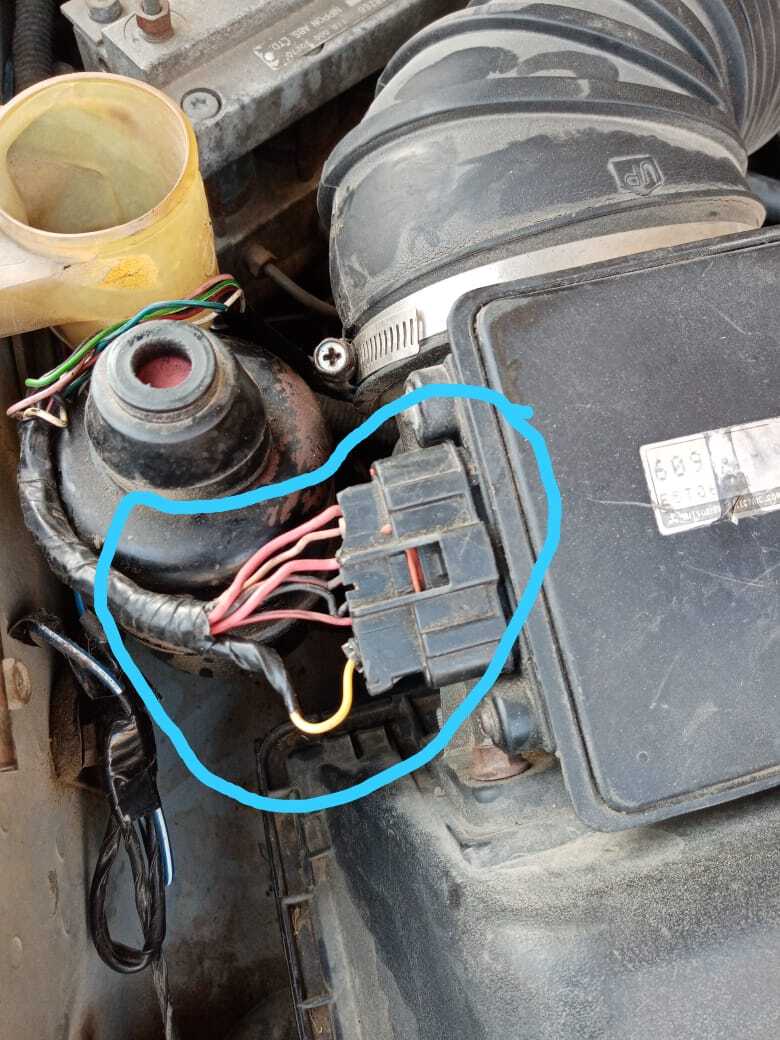

Assalam o Alikum pajero owners. I recently became owner of a 96 pajero v6 3.0 petrol auto transmission Alhumdulliah. As this is my first experience with pajeros, I seek advice from experts before getting my hands dirty with the solutions. The issue being faced is, the RPM is touching almost 3000 while gear is placed on any position except D. On D (drive), the rpm is around 2500 and if foot removed from break pedal, the car goes up till 20 km/h and shifts to 2nd gear without me touching the acceleration pedal. The previous owner and his technician diagnosed this as a issue for air flow sensor, as when it is removed, the acceleration becomes normal. My question after telling the background is, does this issue seem to be of air flow sensor? or any other thing can lead to it, like a tuning issue as rpm is always up, secondly, where can I find and in what cost I can find this Air Flow sensor in Karachi. Picture of sensor attached for reference
. Waiting for your humble advice. Thank you
