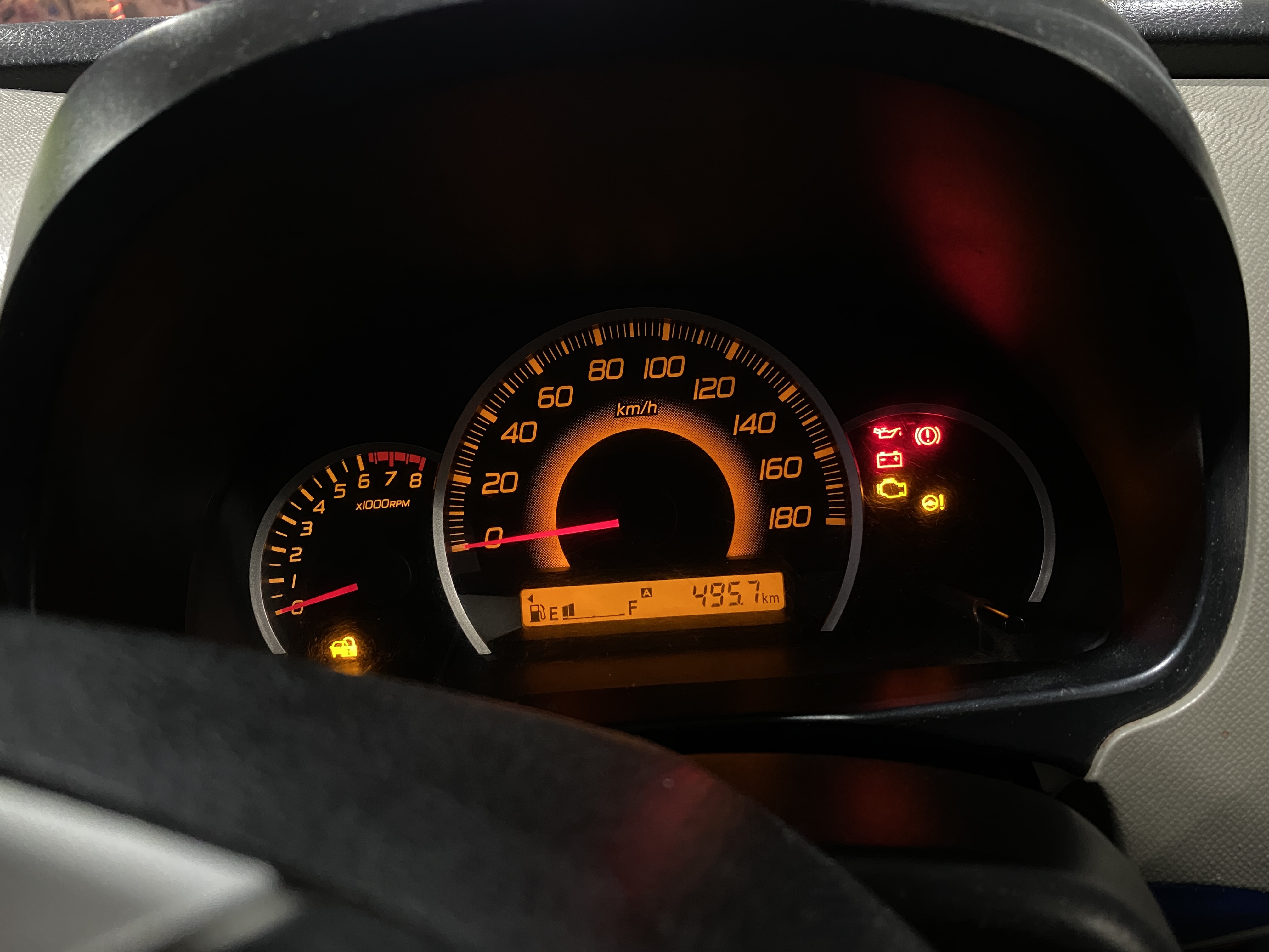

8th point till 495.7Km

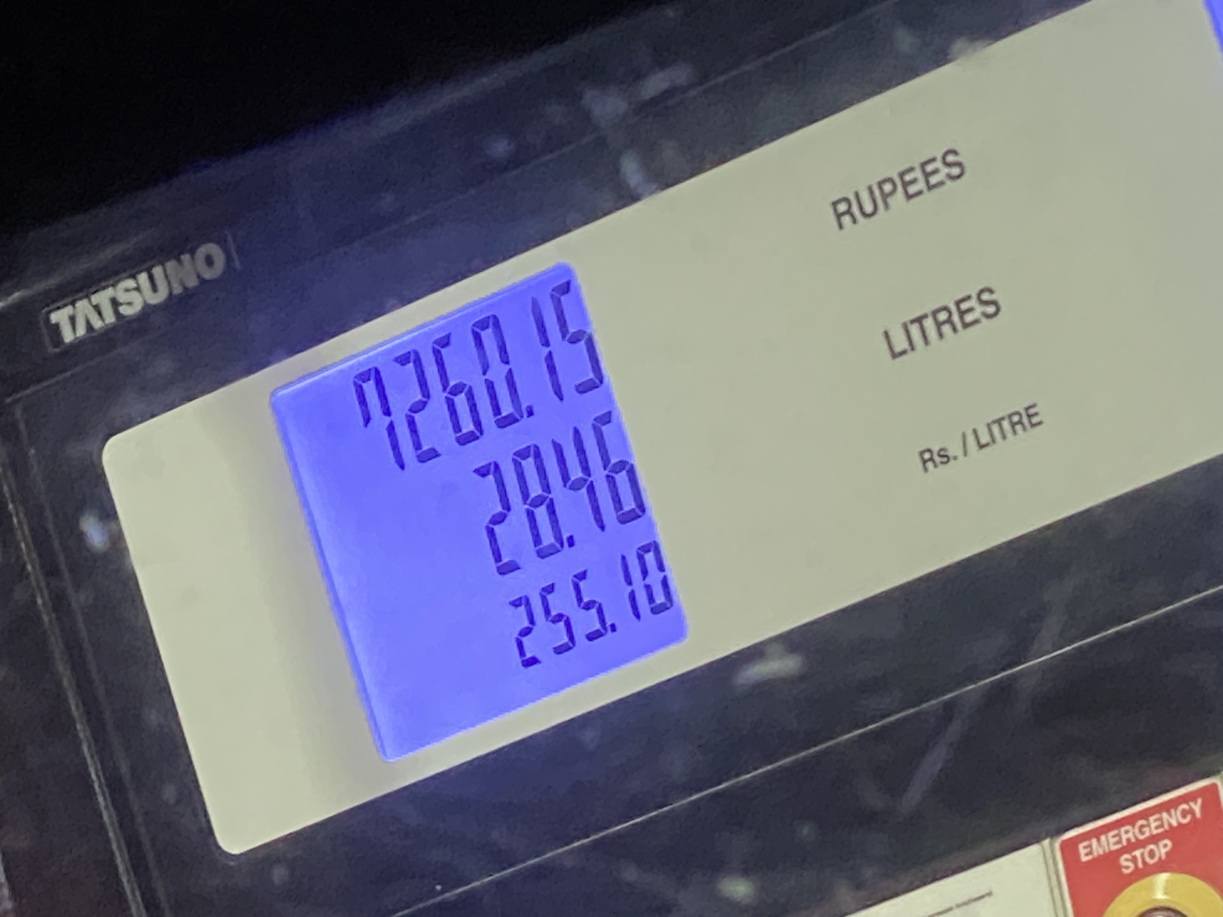

Then again refueled the tank till auto-stop and total 28.46Ltr fuel was poured in:
Upon calculating the average turned out to be 17.41Km/Ltr which I think is excellent and way beyond my expectations.
