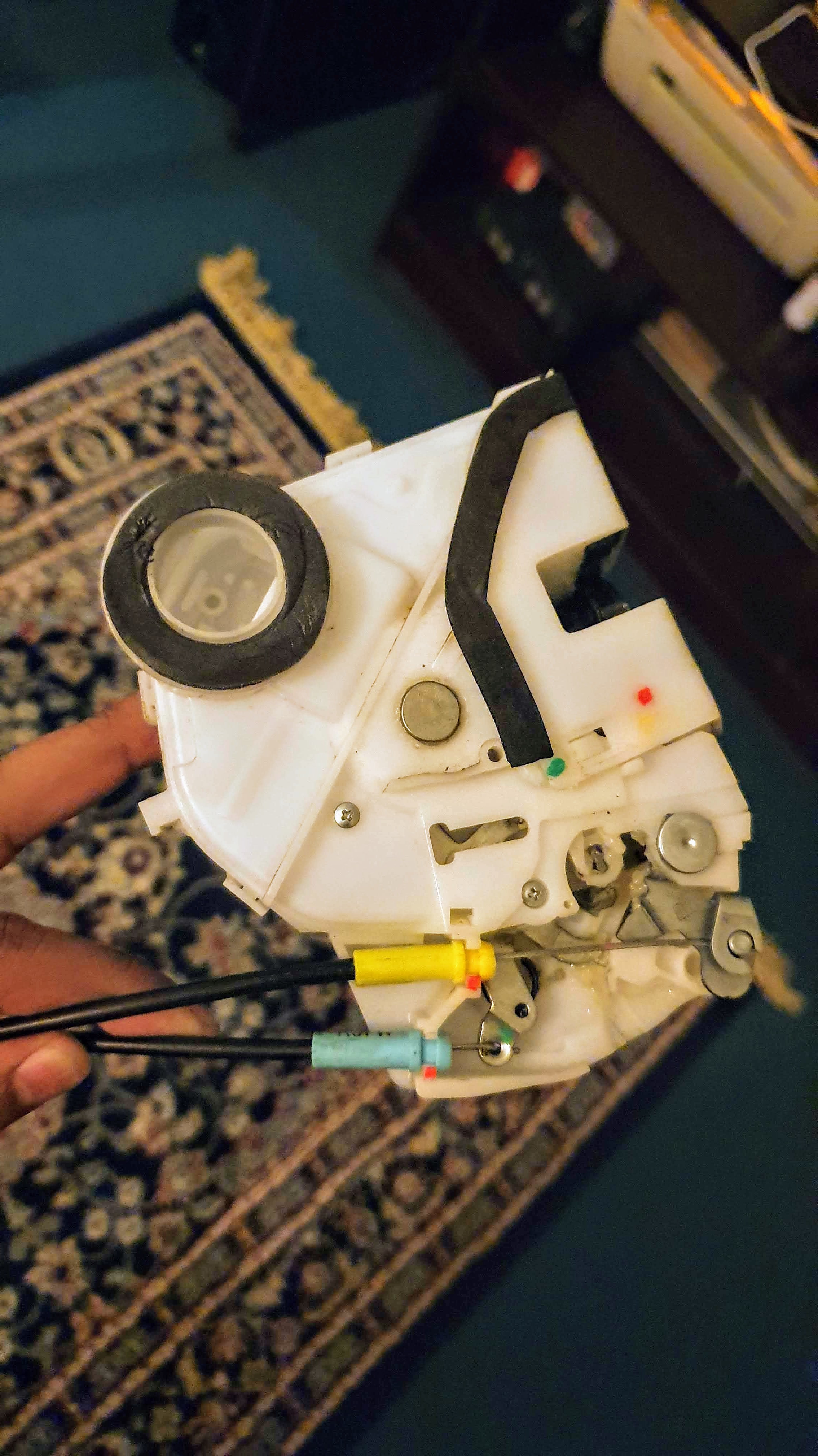

- Genuine Suzuki door locks for all 4 doors which come with central locking motors built-in from Sultan Ka Khu/Chah Sultan Pindi. This is what the original lock from the car looks like,the VXL model comes with a similar set. The new ones I bought were exactly the same except they had grips installed in the circular hole shown in the photo.

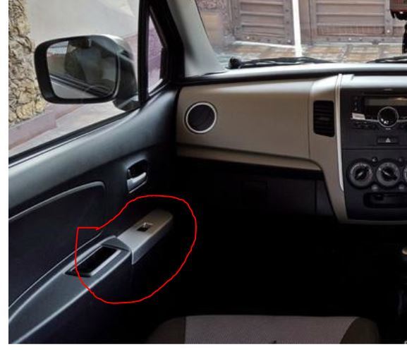

Next up I am planning on installing xvl style side mirrors and power windows to the front doors. Just looking for genuine switches like these, if anyone knows where I can get these then please let me know.
