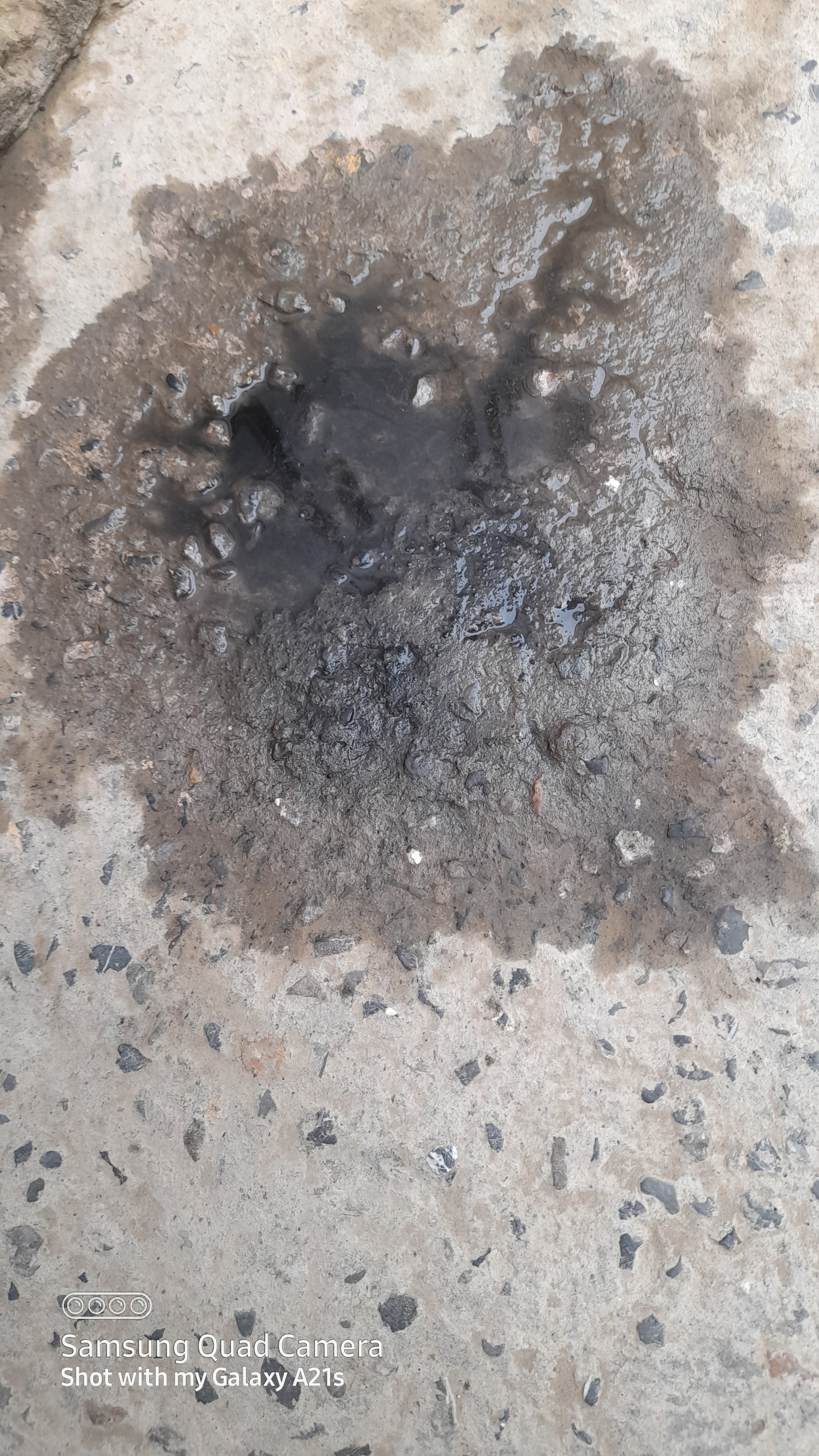

I am from lahore Aj suba gari start ki to kafi water trowing hui with black carbon uske bad gari ka pick up behtar hogya ab ye kia chakar hai koi btae ga

no. this is not a diesel engine car producing soot or cat converters in it
car is running richhead kuch block kuchECU kuchpretty messed up project u got to work on with
Better to just swap a block.Other stuff is from d16 already. After block swap everything will match up.i still can't digest you couldn't find wiring.
