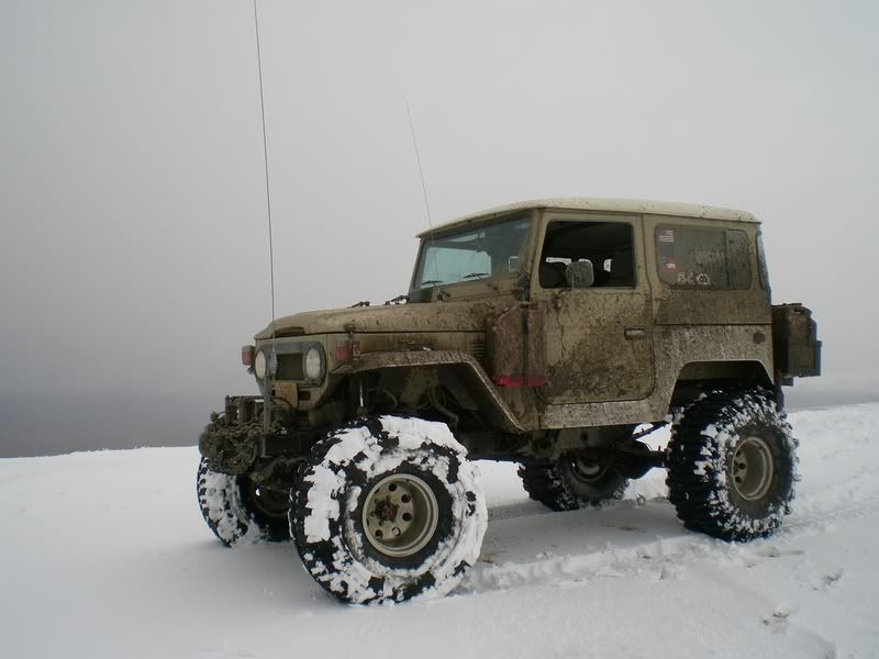

96 inch stock spring flip on 38s

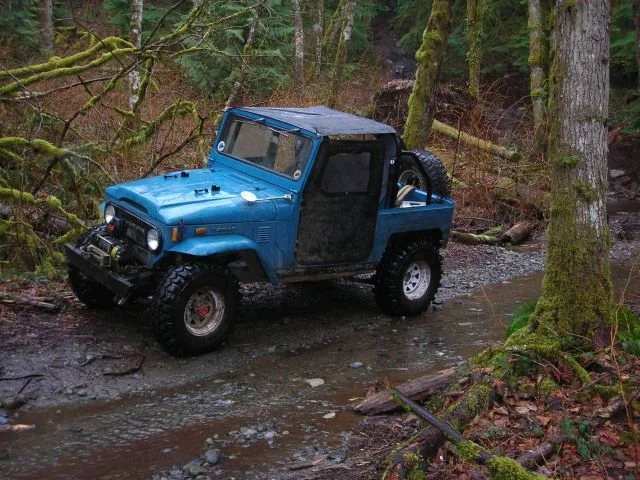

100inch wheelbase with 60s springs:
