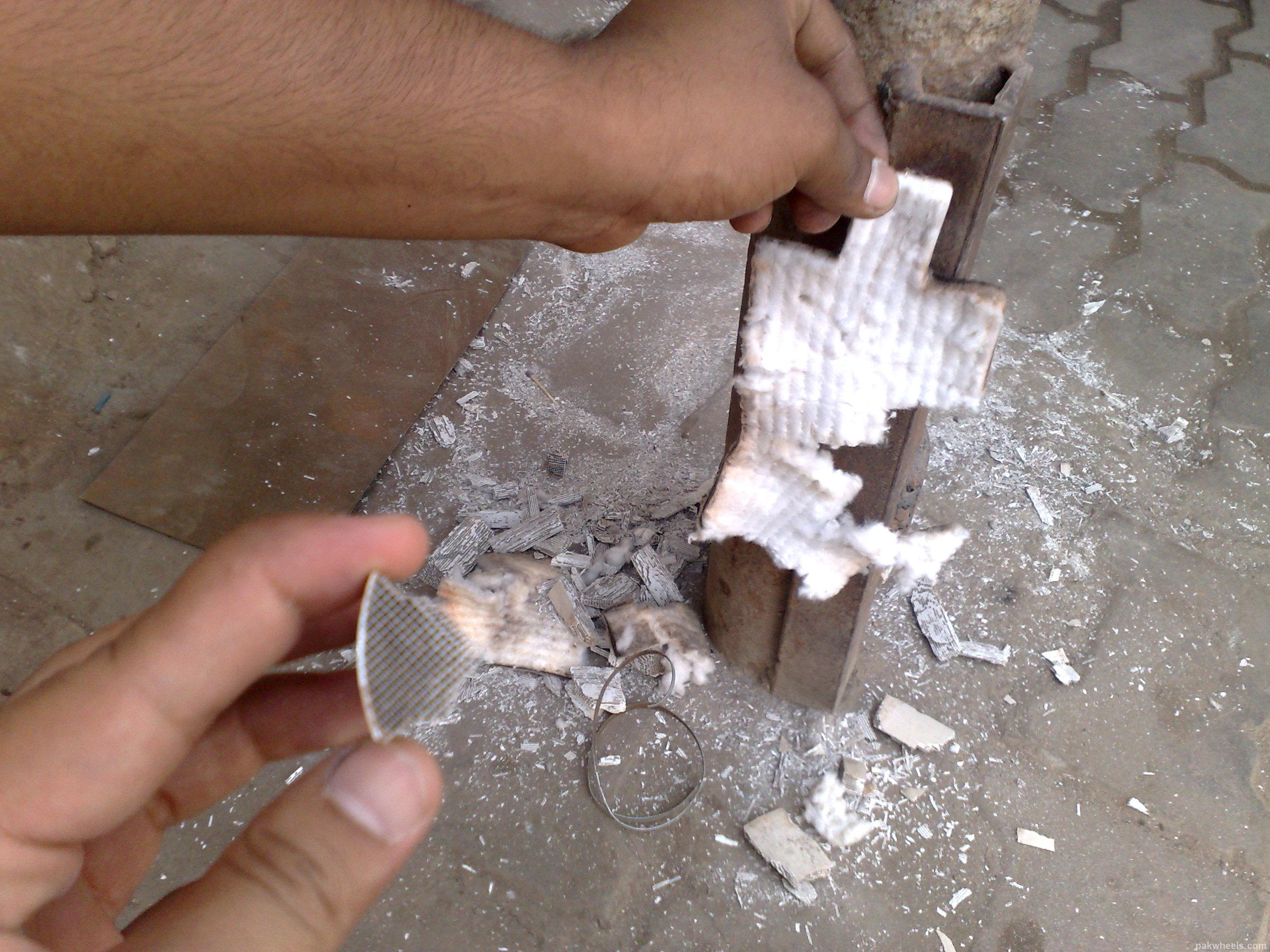

oh my God .......
WTH !!!!!!!!!!!!
yaar first get some info and then do it your self ....
that thing u broke is a grt piece of equipment and very expensive .....
that cyramic thing (the gali inside) which is of honey comb shape is plated wt platinum which acts as catylist to change NO & CO(carbon mono oxide) to NO2 & CO2 as NO and CO are dangerous ....
did i mentioned it was plated wt platinum,,,,,,and the honey comb (gali...) design is to increase the surface area that the gases fron engine pass from
there r more easy ways to just clean it ...
u know it can be removed and so can be easily cleaned ...
it costs around 20000 - 30000 new so know wt u r doing ....
and if u really wana get rid of it , gettin any other dholki in its place or just pipe wont cost that much as some 1 stated dholki for 600 and pipe for 250....
spend that and save ur CAT even if u dont need it ...
give it some 1 who knows its value....
also it doesnt really effect the performance of ur car that much...
i think the better way is to just open it and clean it just take it to a service station and clean it using diesel or water wt pressure,,, yes water is ok to use it wont distroy it ,,,,
